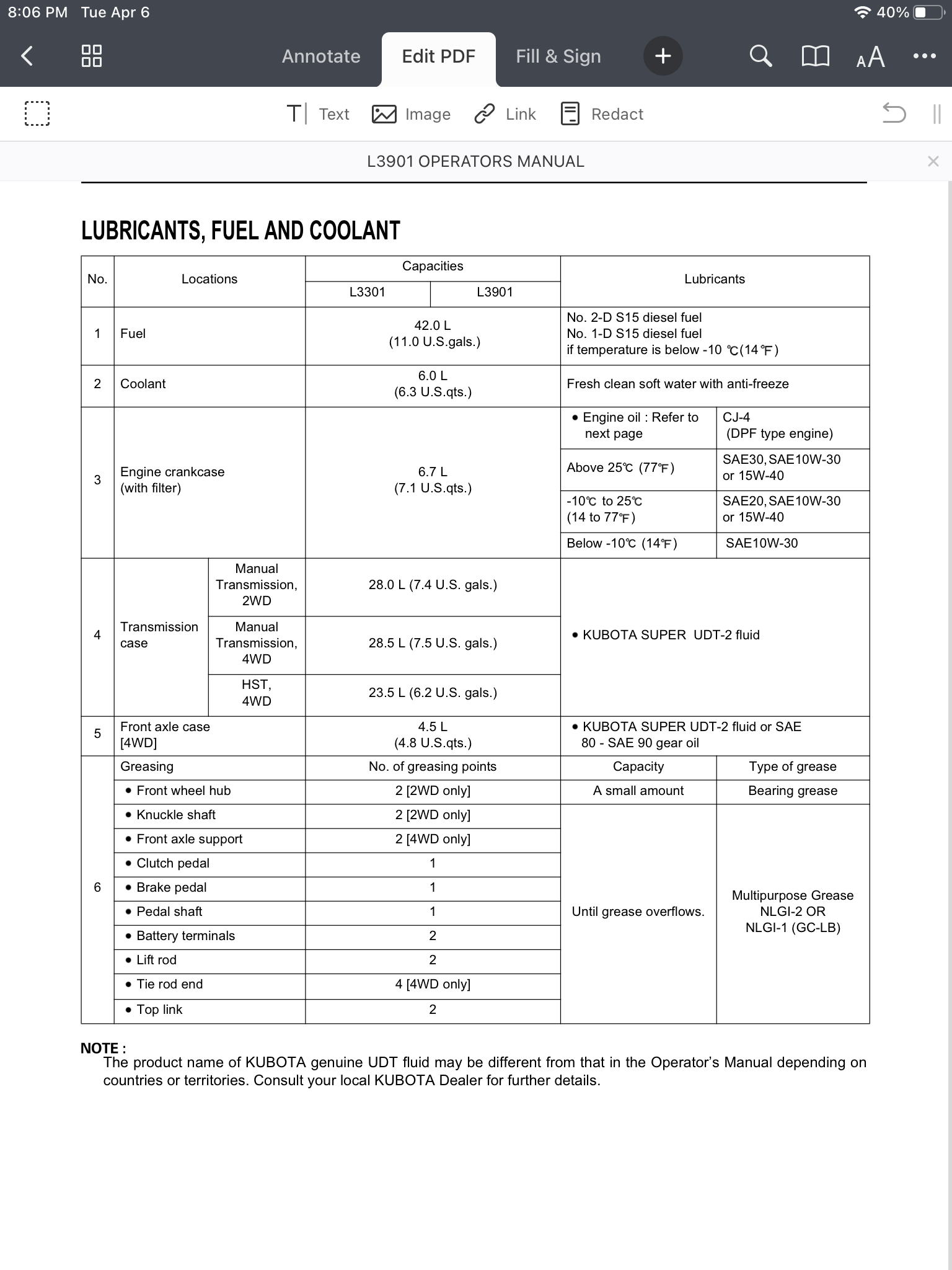

For the L2501-L4701, both manuals do not mention 80w90. It recommends SUDT2 or SAE 80 - SAE 90 gear oil. Both SAE 80 - SAE 90 are straight weight
Try to find a straight weight 80W or 90W gear oil. Unlikely, as the 80W-90 is all that's generally available does the job. It's 80W when cold and 90W warmed up. That "SAE 80 - SAE 90 gear oil" is likely one of the many interesting manual "typos", I think. Says that in my B2650 operator's manual too. Just use 80W-90 multigrade. Or SUDT2. And don't mix.

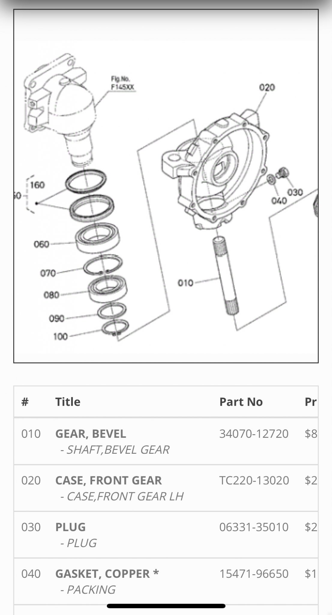

If you hadn’t already found it, look for one of these drain plugs (item-30) on each side:
