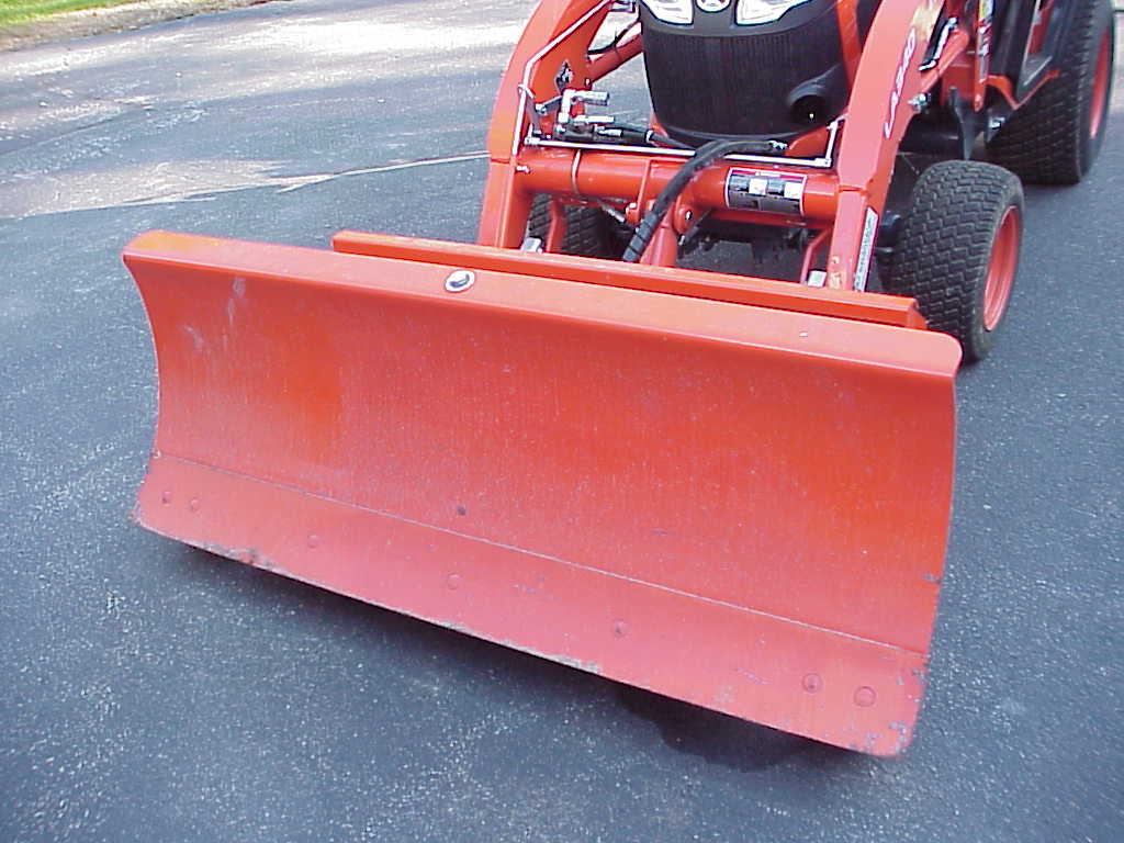

Hi Dusty. Have you ever had a situation where you get concerned about how the FEL arms are loaded when using the SSQA snowplow? If you were going to just have a snowplow, would you pick the SSQA version or the K Connect, and why?
Personally, I like the K Connect a lot because it is easy and fast. I spend a lot of time moving snow, and most times after I blow the snow I have to finish up with the blade. I have to have the driveway just about down to blacktop to keep the wife happy. She had one accident on a snow-covered highway that was banked, and a tractor-trailer started to skid sideways and her little Toyota wound up under the trailer between the tractor and the trailer wheels. That was 35 years ago, and she still is afraid of snow. That is the reason I have both systems. I don't want to be removing and reinstalling the K Connect to change from blade to snowblower, and I don't want the snowblower on early or late in the season either. This is where the SSQA snowplow comes into play. I can push the snow off to the side of the driveway knowing that warm weather will melt the snow and it will not be a long-term problem with a frozen mound of snow making the driveway narrower with every storm. I have never seen a problem with the arms not being able to handle the pressure of the snow either.
If you look at the first picture above, on the backside, you will see that the snow blade has locks (small silver devices that are held in place with a silver pin) in place so you can use the blade like a bulldozer in the dirt. If Kubota thought that this might damage the arms of the loader they wouldn't sell it for a dirt blade. I wouldn't be worried about damaging the loader unless you try to use it as a battering ram. Common sense is a requirement of tractor operation. I have always believed that you use the right tool for the job and using common sense will get the job done.
Thanks Dusty. This is really helpful. I just had a facepalm moment ... yeah, I think if Kubota is selling an FEL-mounted snow plow then probably it's ok.

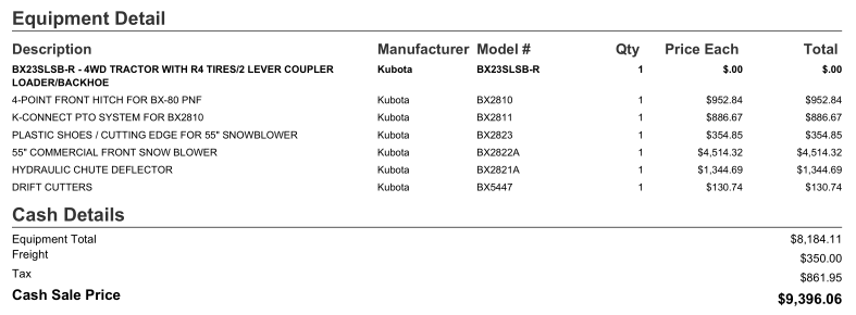

My mistake ... that was around $9,500 US. It included both the 4 point hitch and the k-connect, plus a bunch of options.
