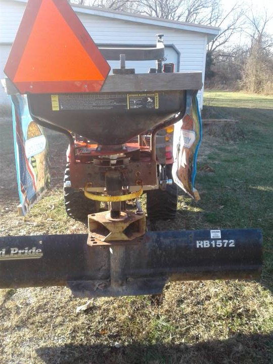

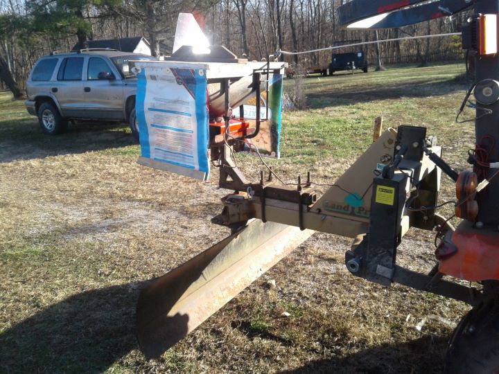

Used a rear blade for 40 years - almost idiot proof, just drop and drive. Thought adding front blade would speed things up. Nope it is a PITA, always snagging the ground. Change the angle - have to change curl to level blade. Put FEL in float and front axle lifts instead of blade.
3pt hitch less weight, swiveling connections on both ends of all 3 connection points. FEL arms are solidly connected to each other not designed to be flexible.
FEL is more like a truck frame, thats why the blade needs to float on it's own.
