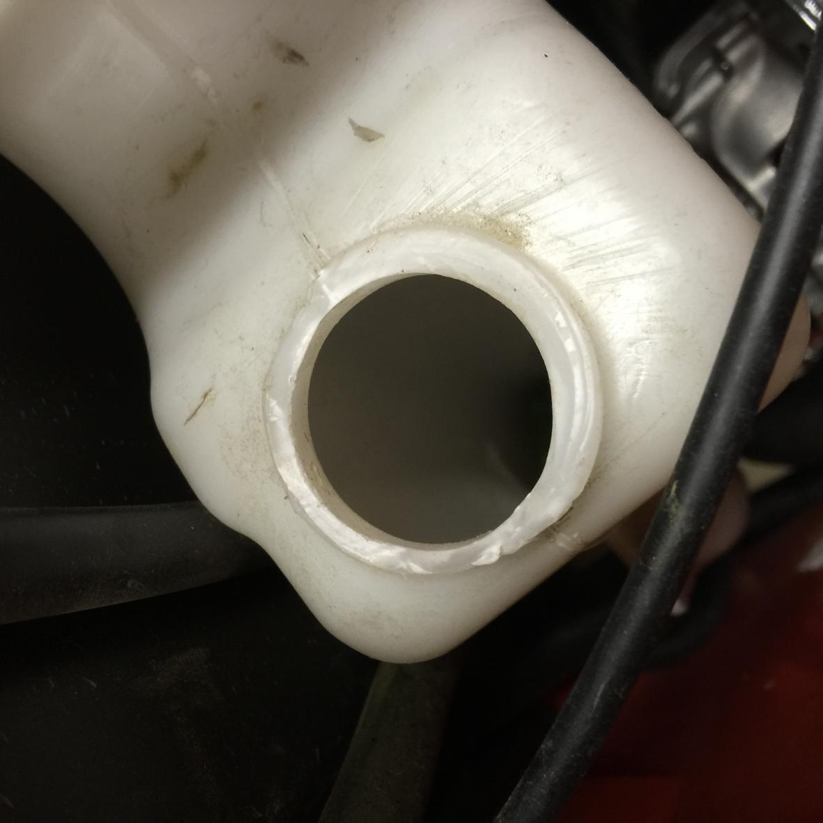

I also had the cap coming loose off the overflow tank, factory trimmed to much plastic off the lip so cap won't stay snapped closed. Apparently the new vehicle inspection didn't catch the cap being loose either??? Dealer taking care of me though.

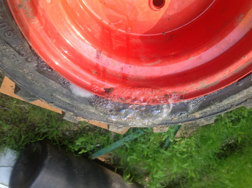

I was out digging an electrical trench today.
Noticed the right front tire was low.
Added some air and now the bead is leaking like crazy! :eek::mad::confused::eek:
Must be tire day!
Found this and will give it a try.
Ray

you are in luck it is a good product,and has worked for me.

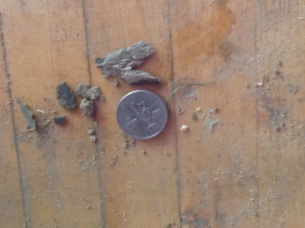

Well I poped the bead to take a look and found that dirt and a piece of branch worked its way into the rim/bead.
Washed all the dirt and now it is sealed.
Eill take the other one apart to check and clean.
I guess these tires are not meant to go in dirt! :Dj
