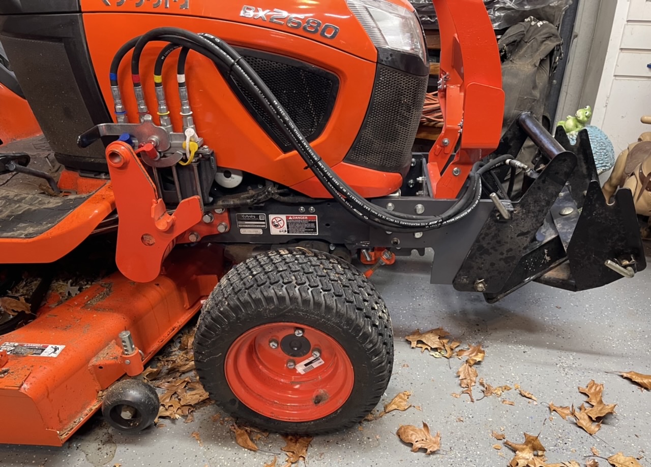

I like the flat manifold. Have had the loader on and off a handful of times and 0 leaks. And as noted, easy to clean. Used the same manifold when I adapted my old JD 425 blade to the BX. Again no leaks. Now if you have the hose fitting to the manifold hand tight, they will spray like a fountain. Don’t ask me how I know this
