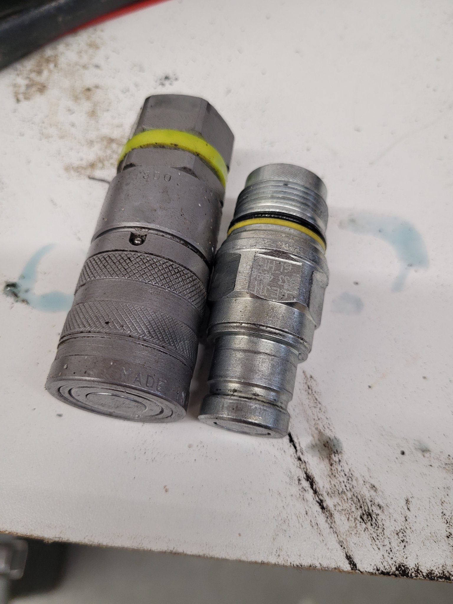

Hi shadow, here's a pic of the couplers on my Quicke loader.... 20221130_151808.jpg 20221202_135403.jpg
They are 'Faster' brand. There are O ring kits available but I'm not going to bother taking one apart not knowing the timeliness to get the right ones..... I can't quite tell where they leak from when coupled,but they do a bit...

I took a good look and have found one leaky female coupler giving me the issue. I can't see how to disassemble this 'Faster' brand fitting. The male has an O ring that is easy to see.

So, these flat faced male couplers have replaceable O rings..... the females do not, unlike the ' normal' style. And, the p/n from ALO for one seal kit is $112cdn..... lol. Parts guy said just to replace the fittings.... ya right.... at $120+ each (x8). That's a lot of oil. Mine haven't failed from dirt. And are only 4 years old, with maybe a dozen connections......
