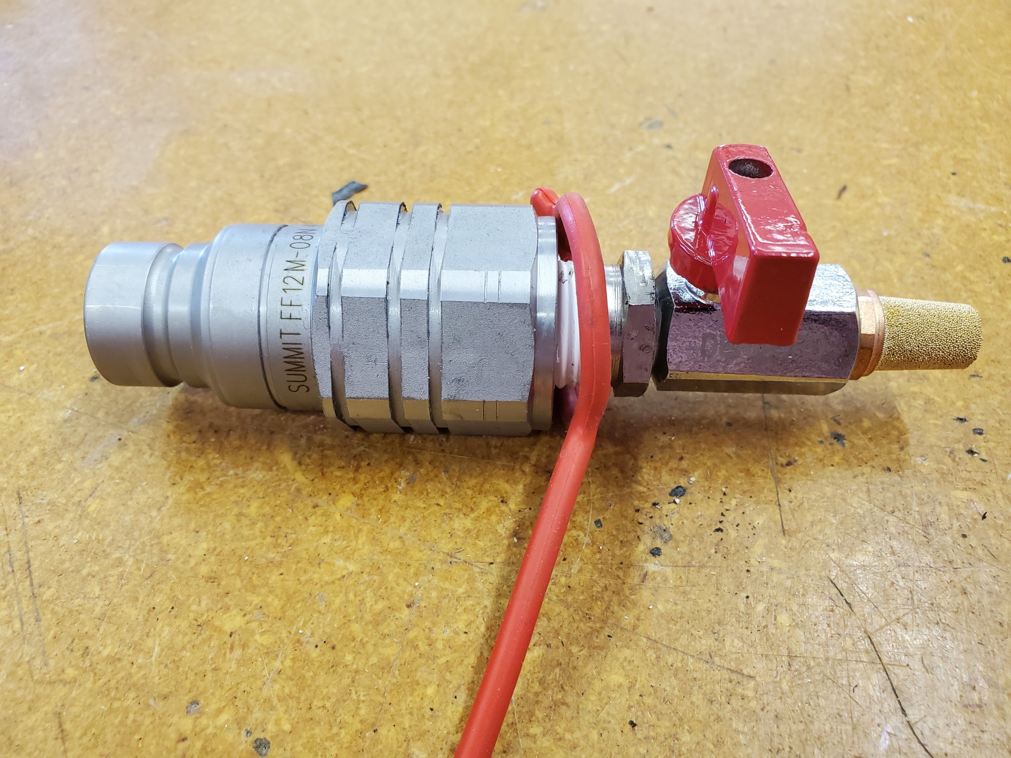

I made a pair of these to plug into my grapple to bleed off any built up pressure in the lines

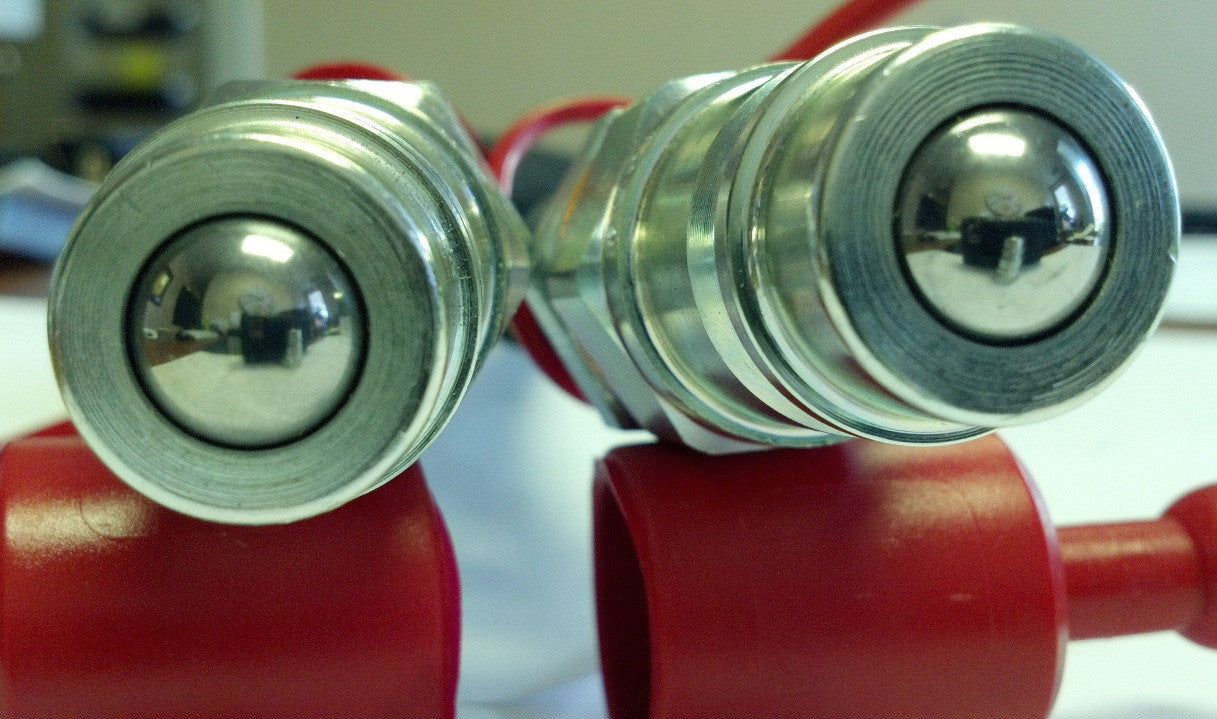

I have tried everything mentioned here. I hear it clicking and the hose feels like the pressure is off of it. But, I’m not able to get the couplers to connect. Is there anything I should be doing with the little ball that lines up with the pin on the sleeve?

If all else fails, remove the coupler from the hose and try it on the tractor. That will determine if it is the tractor or something else. It will also release any pent-up pressure in the lines. I used to do this with my old BX22, because it was the fastest way to release hose pressure.
