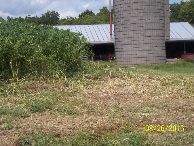

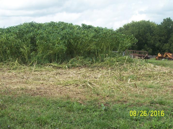

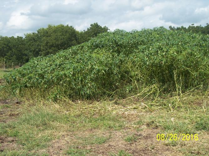

Sheepfarmer, those Y shaped flails will do fine on brush, and excellent on grass. The hammer flails will knock down much larger "brush", like small trees.
Here's an example of some weeds I cut a year ago with the Y flails. This stuff was about 5' tall and up to 1 1/2" stem and ground. I left it up about a foot off the ground just to see what it would do. It's an old manure pile composted to pretty much dirt, but I wasn't sure what might be in it!

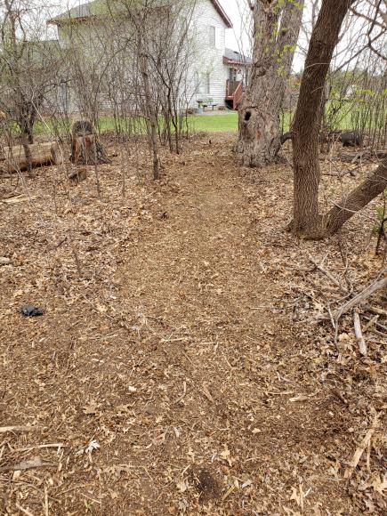

Hi all, first post and newish tractor owner. Purchased a B2601 a few months back and just really getting a chance to start using it now that spring is here and the summer projects are starting. I have read till my head hurts on flail mowers and took a chance on the Med duty Betstco 53" FH-EFH135 a few weeks back. Had to clear some brush up for some fence installation and recently purchased 80 acres in northern MN that will need some ATV trails, hiking paths, shooting lanes for deer hunting, etc cut as well as some area for a place to set up camp till we get to building something. Got my first chance to use it the other day and so far very impressed.
Seems built as well as I would expect for a $1300 unit from China. Assembly was easy enough, instructions were a bit poor. But went together easy enough. I didn't go easy on it. Gave it the "throw it off the deep end" treatment and was pleasantly surprised! It ate up anything my tractor could knock down and drive over and turned it into a very fine mulch. Only had to slow down a little for anything over about 3" as you could hear the hammers slapping off instead of cutting. After about 3 hours of eating trees, down wood (some up to 4-5" thick!), a few rocks, a metal pipe and about 20 feet of steel wire there were only a few hammers with some very tiny chips in the edges. The thing is very smooth, quiet, and I had no trouble powering it even though they recommend a few more HP than I have. I think I'm going to enjoy running this one! I can't post pics yet, need to add a few more posts.

Perf,
That looks great...nothing left but mulch. I assume that yours has hammers as well? I believe we have the same model number.
Which offset position did you use?

Thanks. I do have hammers. They took almost 0 damage through al the stuff and I was very surprised at that. I ordered an extra set of hammers and belts with the unit expecting to have broken a few with some of the large stuff I knew I would find under all the leaves and crap that's been left out there for 30+ years the house has been here. Looking forward to heading up north and making some new ATV trails and cleaning up the new property in a few weeks! I believe I had the skids at the 2nd hole from the bottom and the roller on the 2nd or 3rd hole from lowest setting.
