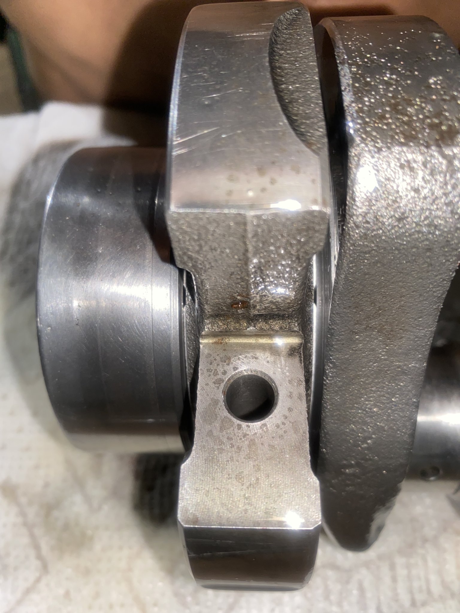

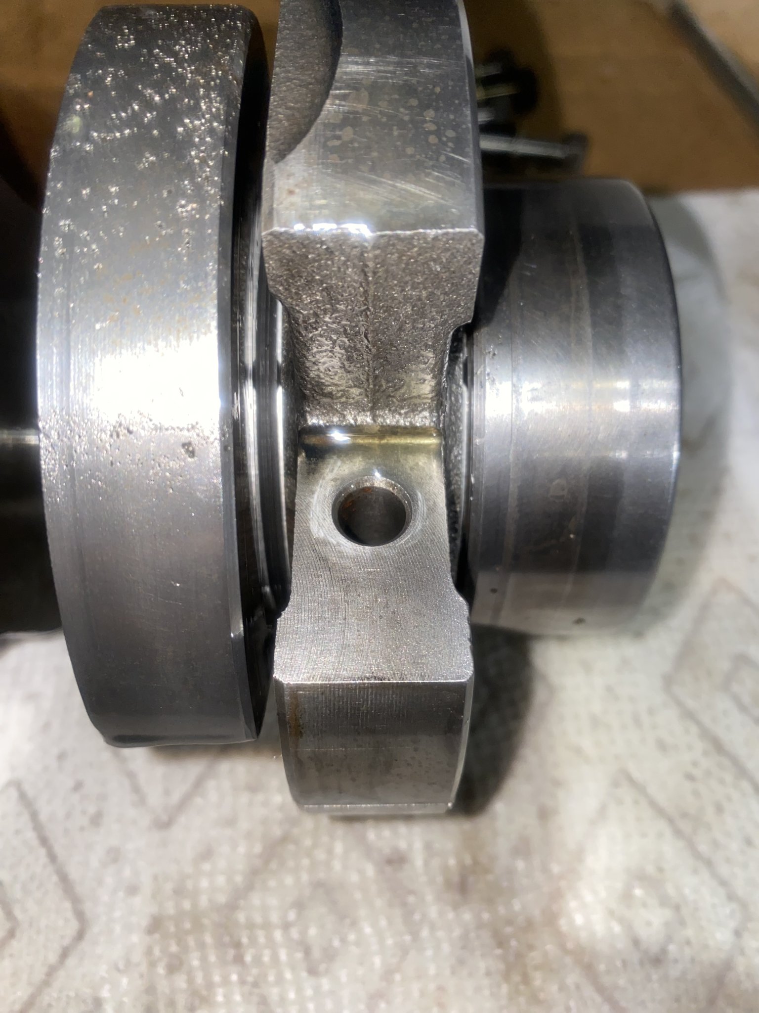

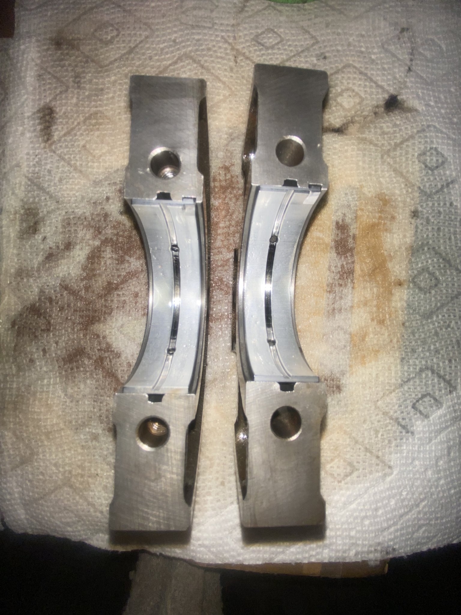

I did put together the crankshaft assembly
closeup of thrust bearings, the little gap in the bearing facing the crankshaft
Another closeup of gap on bearing facing crankshaft

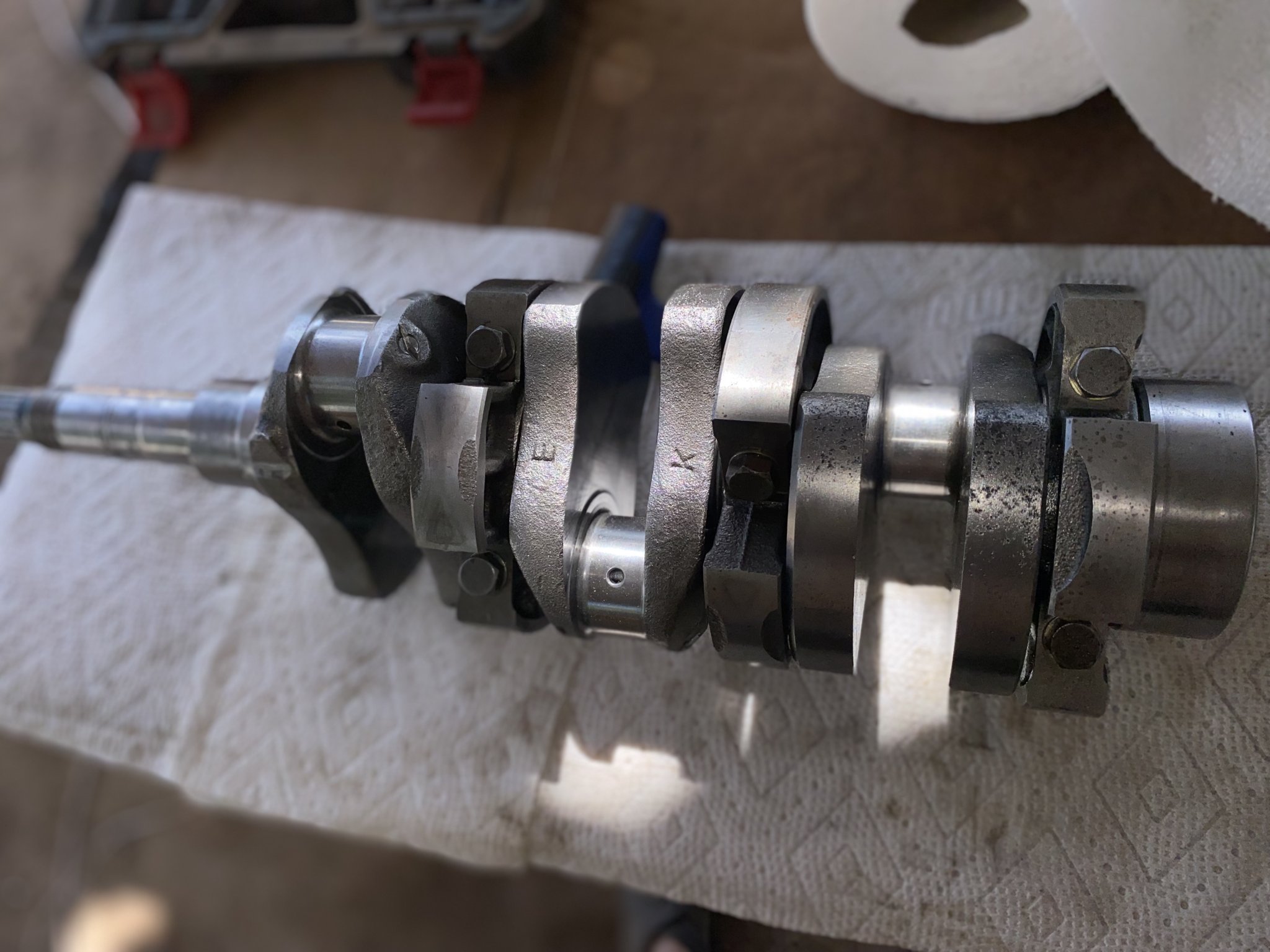

New crankshaft bearings
Assembled crankshaft

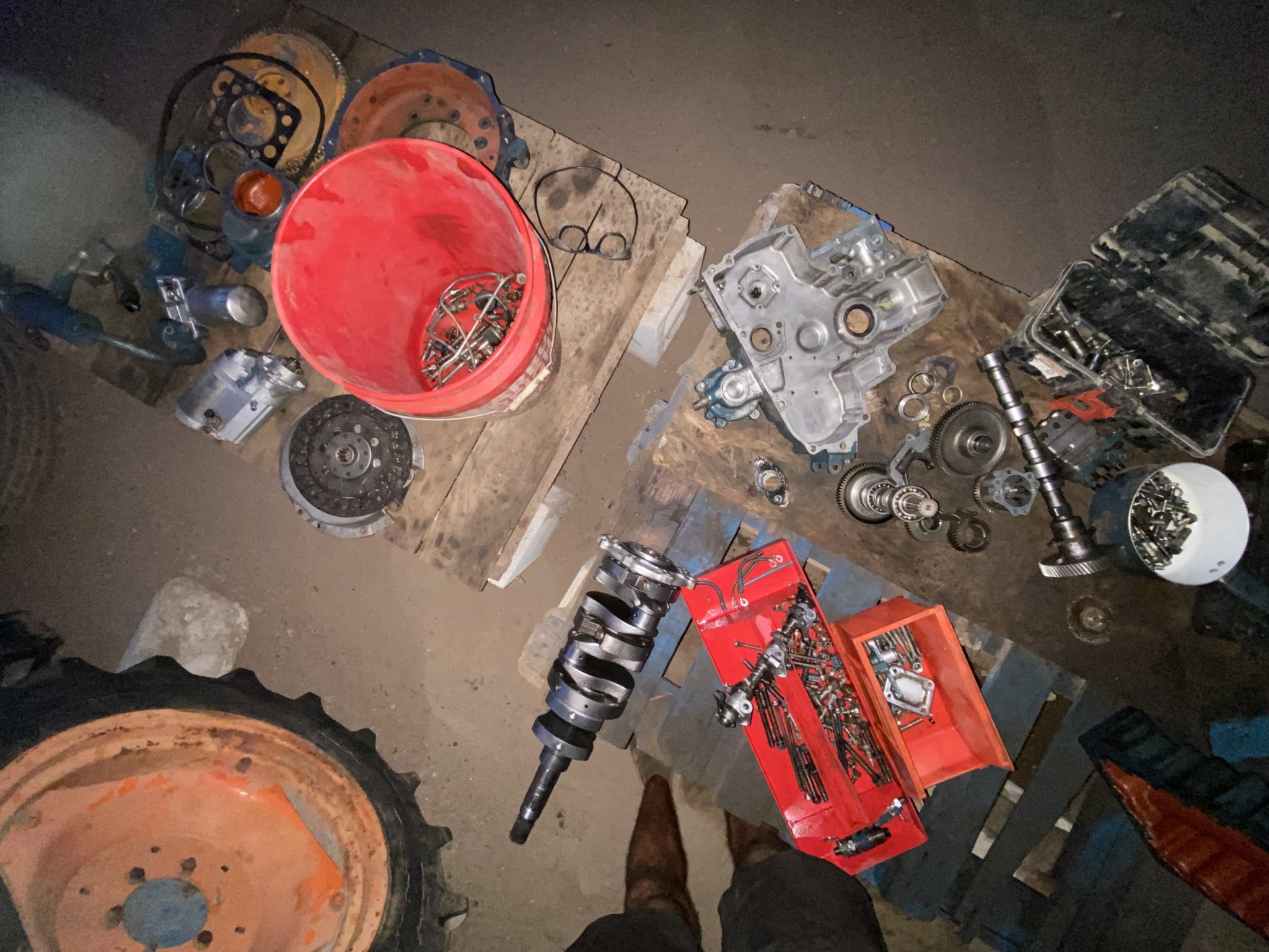

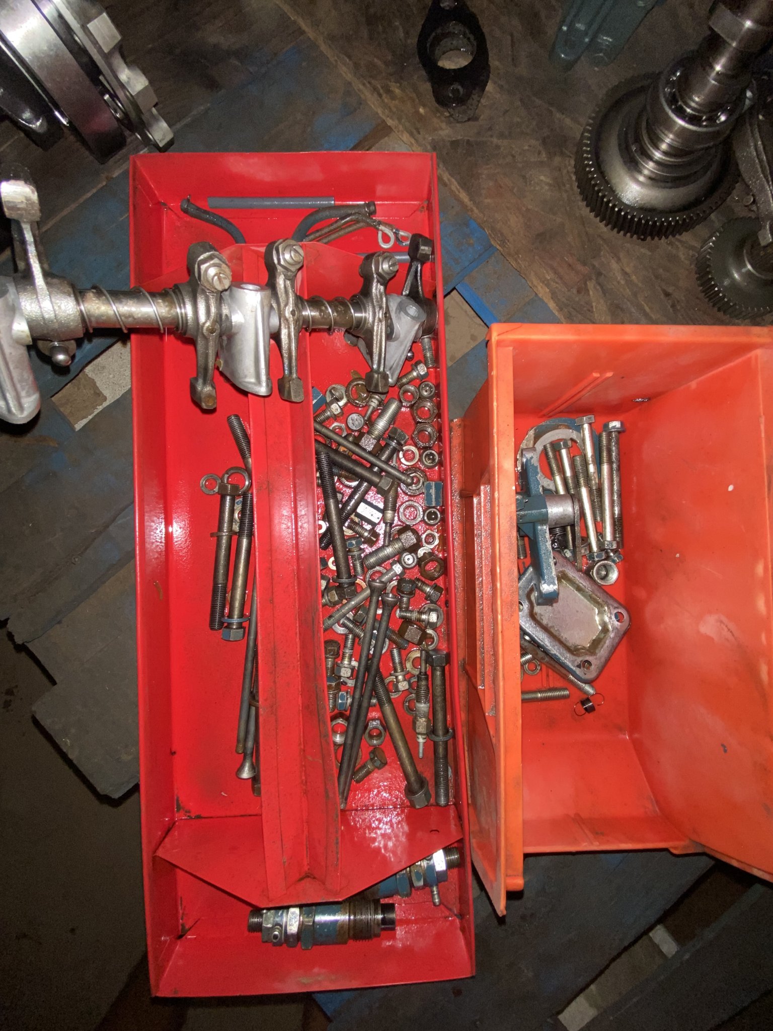

In the meantime, finish cleaning all bolts, organize all bolts for reassembly, and start cleaning the parts from the other tractor with the hole in the block
New crankshaft bearings View attachment 131725

the only thing I can think of doing: keep cleaning, brushing and organizing parts

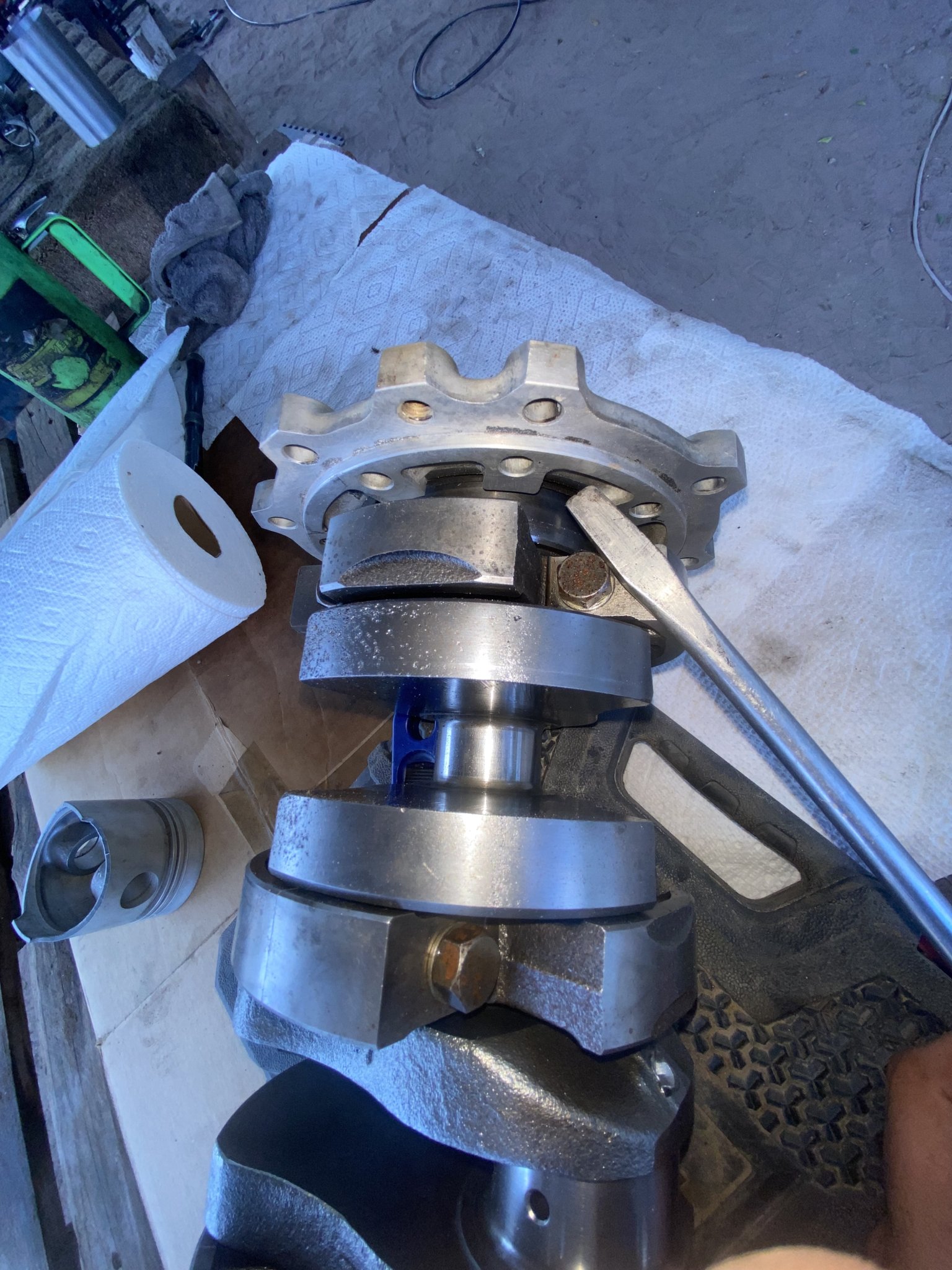

Also, I did have to grind down a gasket on one end of the main bearings (I forget which one), I need to look at the diagram and get that gasket ready/figure it out, I'll pull up the diagram on kubota website

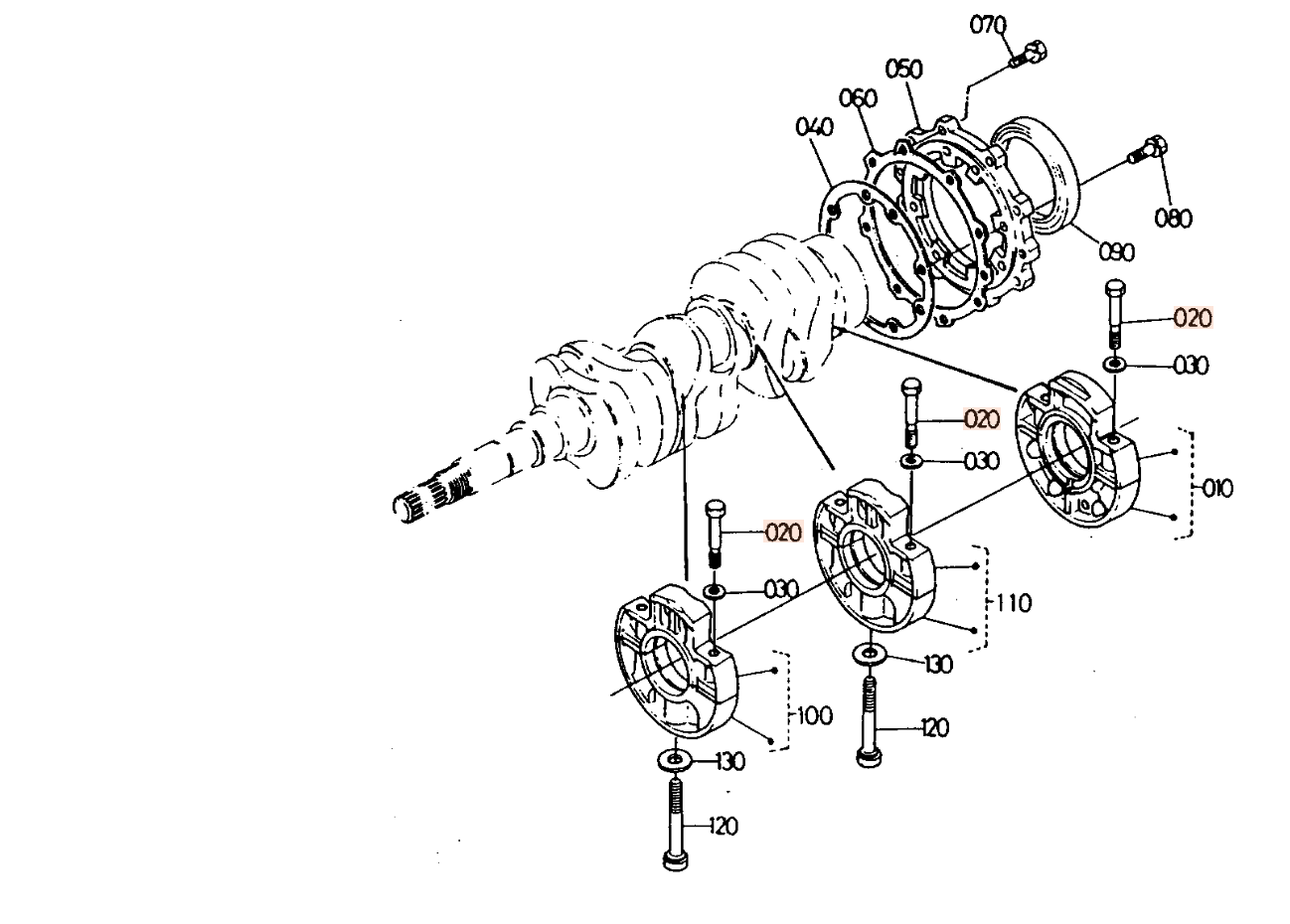

#40 and #60 in the diagram, I think one of them is rubber #60 (which I still have), and #40 is the fabric that I had to wire wheel,

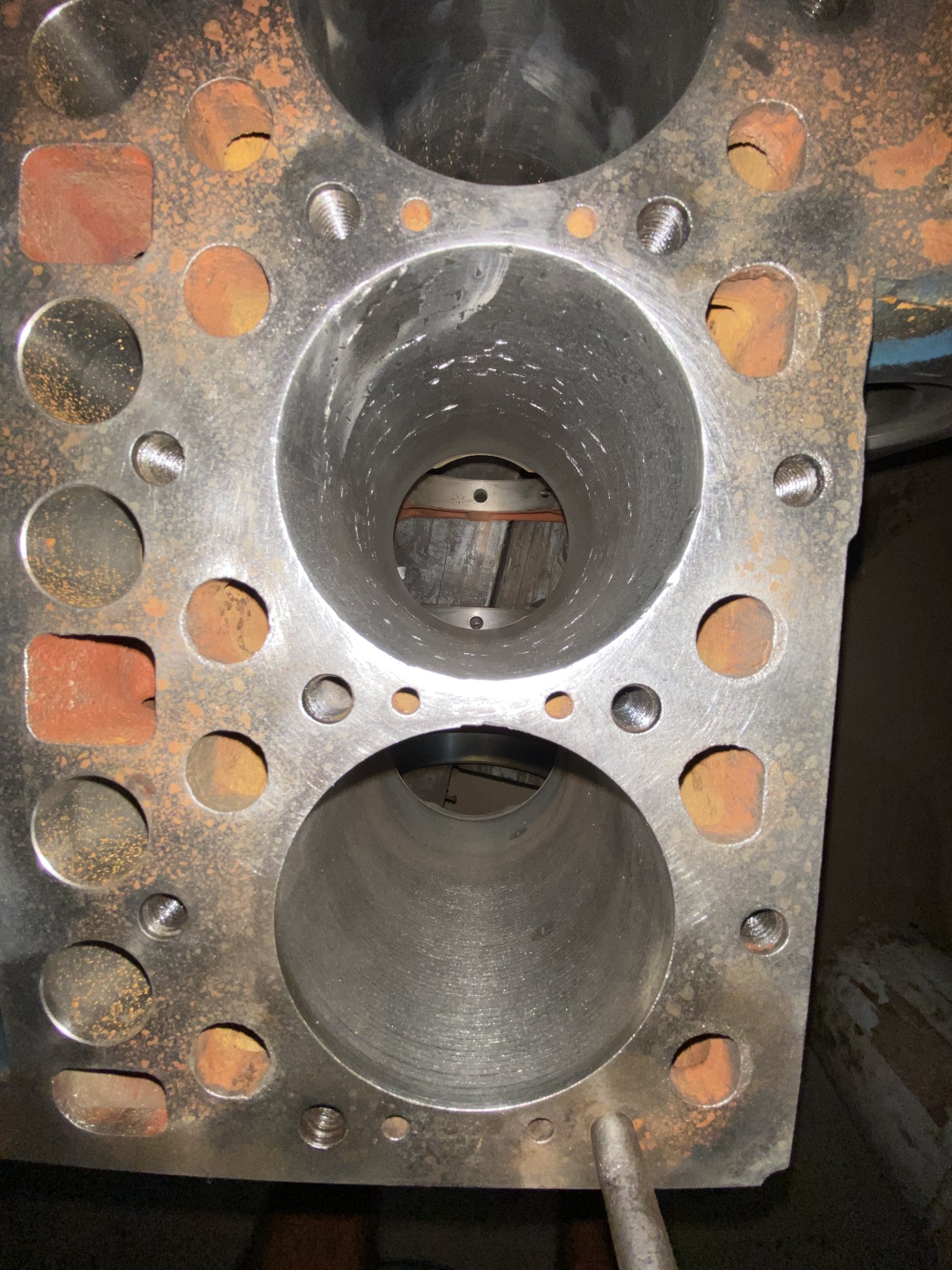

Outside diameter on the sleeve is the issue.

Let me offer a suggestion, because I don't know the answer.
The digs in the cylinder walls are discontinuities that provide a starting point for cracks given temperature variations while running.
Filling by welding introduces its own problems in this situation, due to heating and material differences. Of course, an additional step of boring would be required.
At this point, I would stop and research what impact if any the digs might have.

Hit the bores with hard wire wheels
Figured out that gasket
This is where that gasket goes

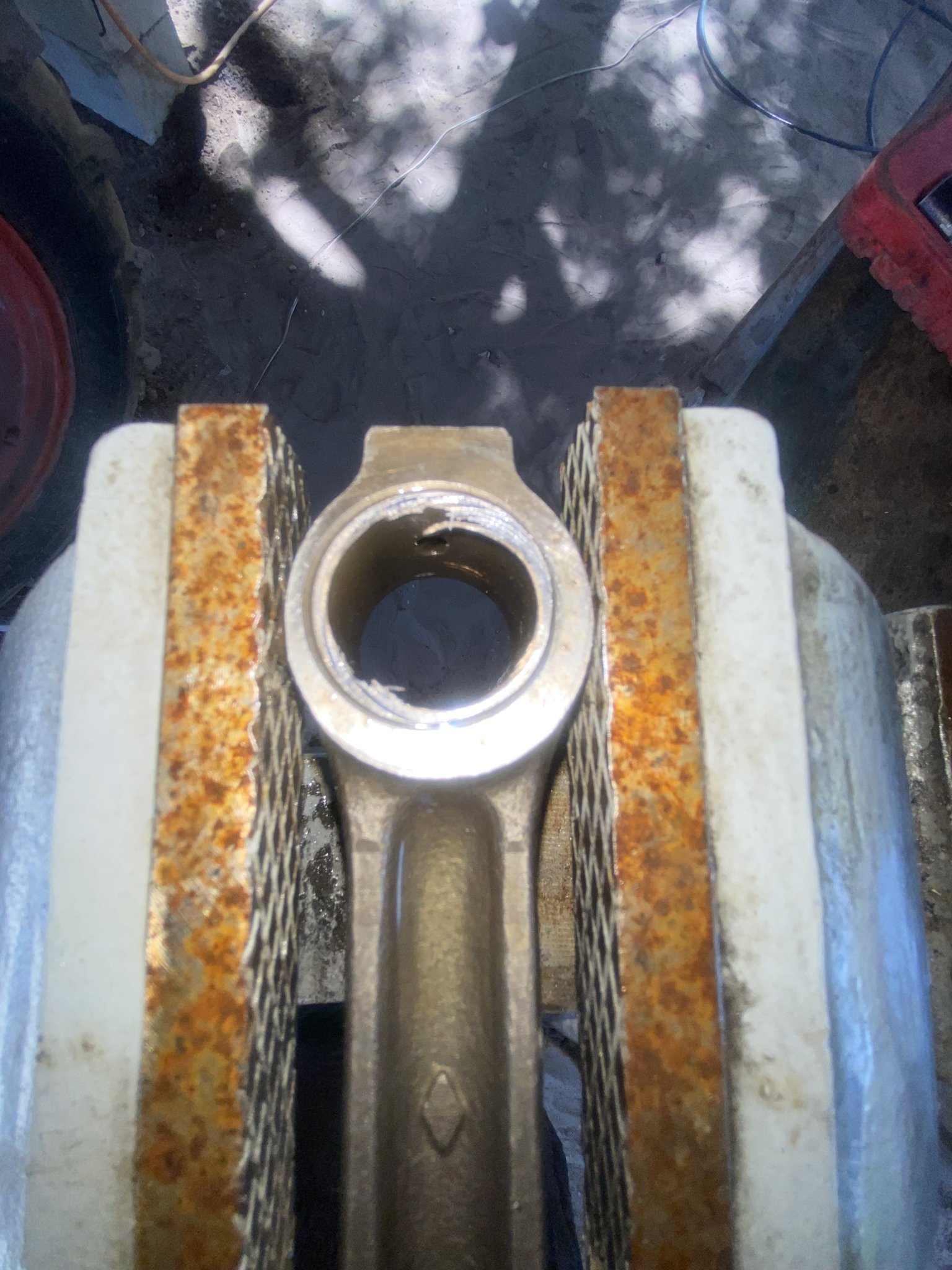

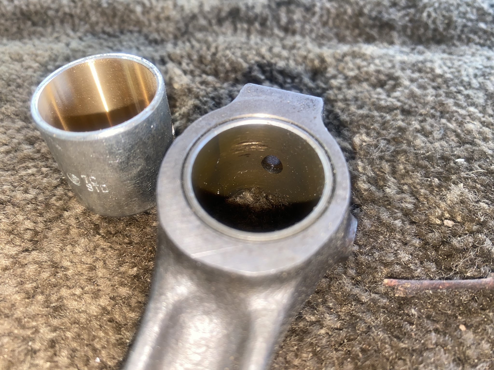

On connecting rod, there is this part here, do you see the gash in the metal? Next to it: brand new part that replaces it, I am trying to replace it
Put connecting rod on vice, put 18 mm socket, tried hammering down
Did damage to the part, I stopped
What is the proper way to get these out? There should be a tool or a way to get it out properly and install new one. I'll look into it.

That would again be called a press. They also need to be machined to fit the wrist pins.

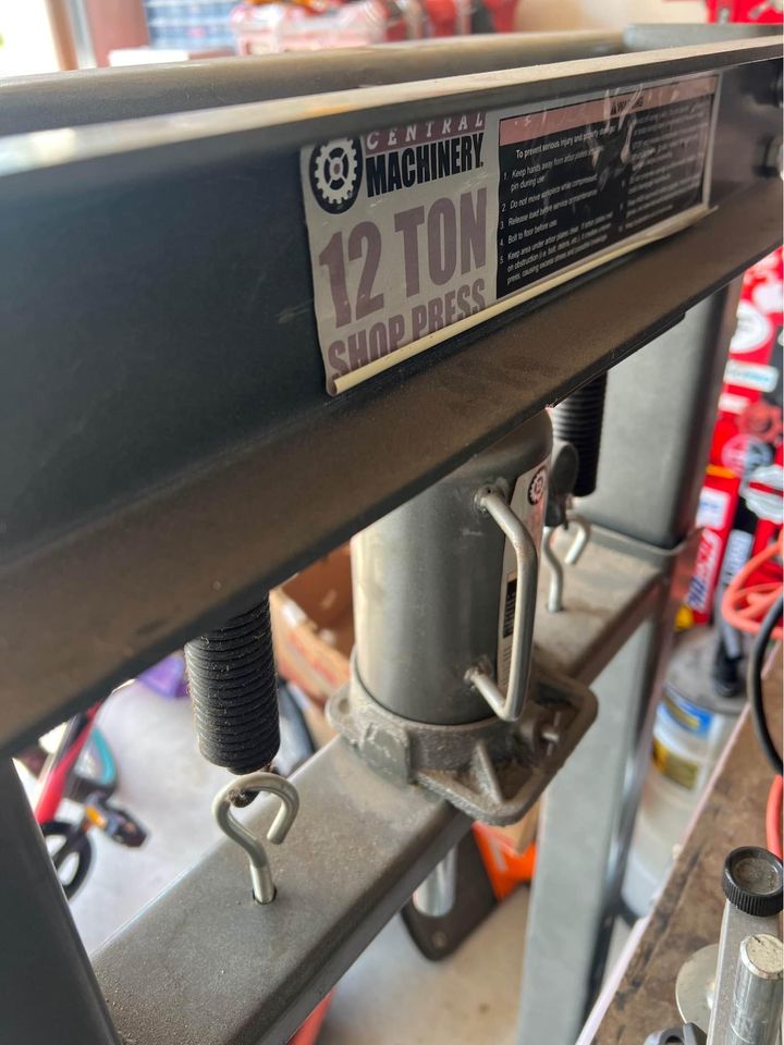

here is one used someone is selling close by
Do yall think it is worth me getting this press? Already there are few instances where I need it: piston pin bushings for the connecting rod, I think there are other bearings that will also need pressing (fuel camshaft bearing)
With this press, I can also turn it into a puller, correct? Where one can secure the part onto it, then latch onto it using contraptions, then raise the press and separate things without damaging them?
I know if I had pressing and pulling capabilities, I would not have damaged those components when removing crankshaft, etc
In the past fixing other machines: I did need this to press in and press out bearings (on older vehicles)
It seems that all shops have these presses, especially if they are engine rebuilding or doing any kind of moderate mechanical work
With this machine press, I can push out and push in the new piston pin bushings?
its called "piston pin bushing"
With that press, if the engine block can fit it, then I can also press in the liners, I am guessing...
With this machine press, I can push out and push in the new wrist pins?
"That part I am putting in is called wrist pin" ?
I will not hammer on the connecting rod until I figure it out, in the meantime, keep cleaning the rest of the parts
NOOO. Engine building is precision work. Let the machine shop do it. You cock them when pressing, they twist out of round, then you have more junk.
Your not getting any of the concepts here. Your crank needs to be cut and oversize bearings put in.
You'll be lucky if new sleeves don't spin in the bore.
New sleeves need to be pressed in straight and machined.
Wrist pin bushings need to be pressed in straight and machined to size.
Head should have had a professional valve job done. Compression is the whole concept of diesel engines. When your valves leak it will not fire.
We are trying to help you get several thousand hours out of this after all your work. You put this engine together like you are and you'll be lucky to a couple hundred hours.

All of the parts cleaned wire wheels, then pressurized parts cleaner
The most recent parts cleaned, glow plugs, inectors, phaser, all the head bolts, took off the stuck on gasket on that cover, etc
another look at the bores, the liner should work out fine
plan: figure out whether to get the machine press, get the liners installed and honed professionally

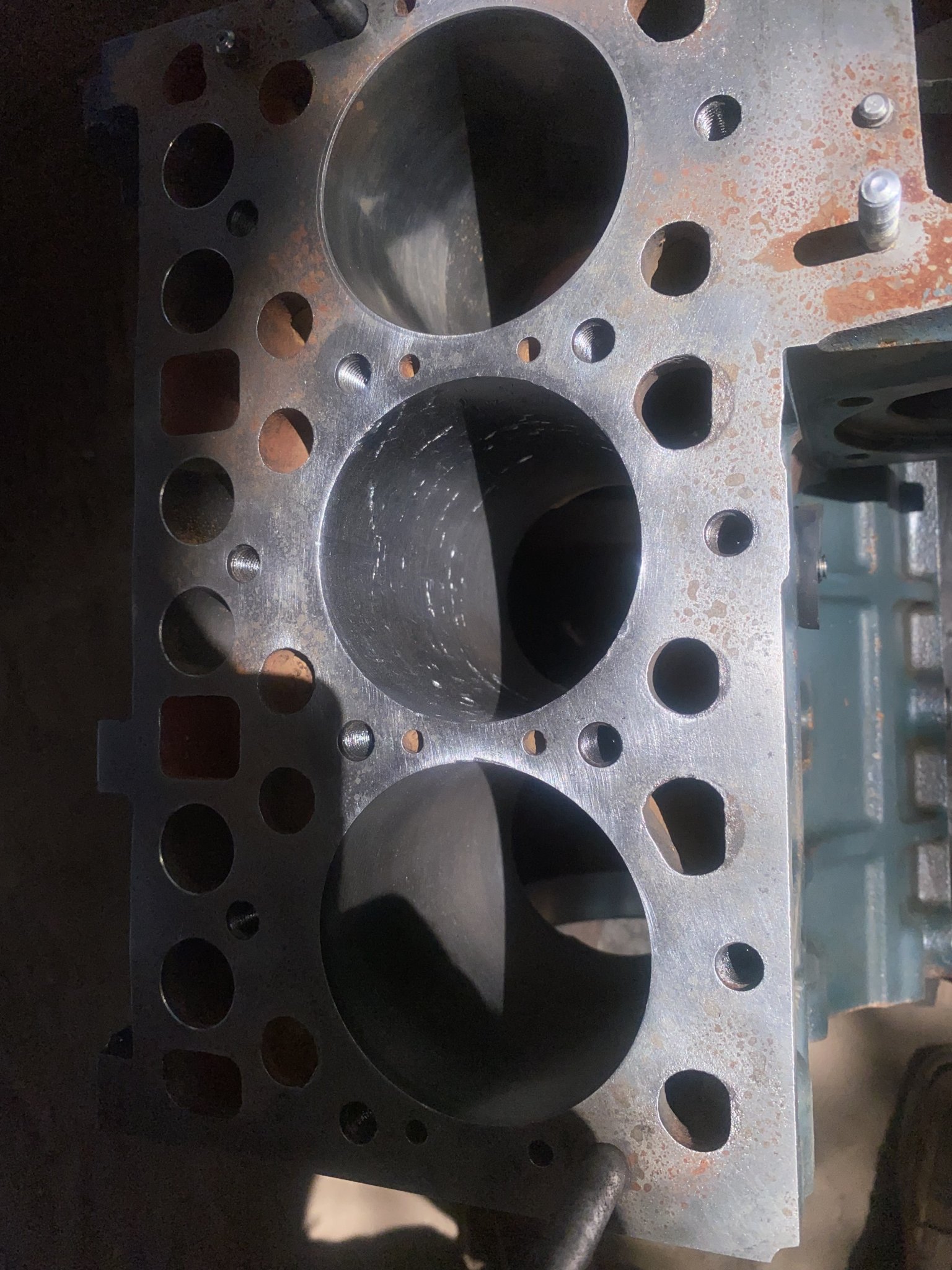

I get that you are trying to do this on the cheap, BUT.
You've already done a ton of damage to the block and I'll be really surprised if the liners will even go in.
With as rough as those bores are, you'll never get liners in them, they need to be honed to size if they are not oversized already.
If you attempt to drive the liners in you are going to damage them!
