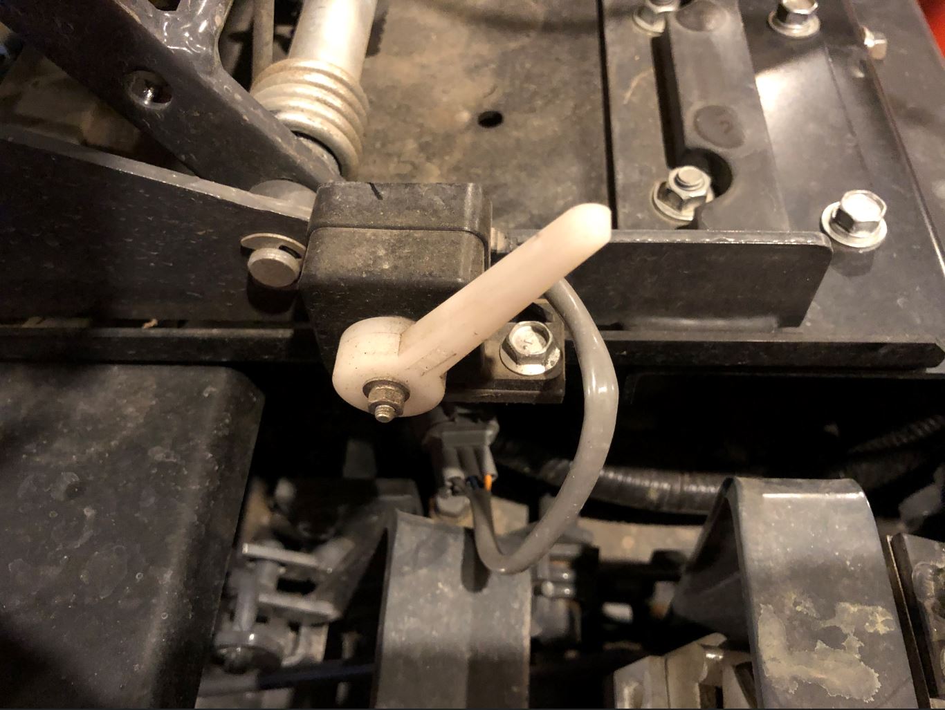

My new MX seat switch was too sensitive. It would kill the engine just from leaning over to the right side of the tractor when I was trying to eyeball the loader. So I cut a small metal shim and installed it between the switch and the bracket. I ended up replacing the bolt with one that was slightly longer. So far so good.

Nice work. I need to do something similar for my BX. Don’t want to eliminate the switch completely as I have little kids, but it even shuts off going down a hill unless I’m pushing back against the steering wheel. Ridiculous.

I looked for an adjustment but there is none. I tried taking the plastic finger off and repositioning it on the shaft.. it only installs in one position. I considered removing it too but figured that's not the smart thing to do. So my mod was all I could think of. I suppose you could attach a shim to the seat bottom too...

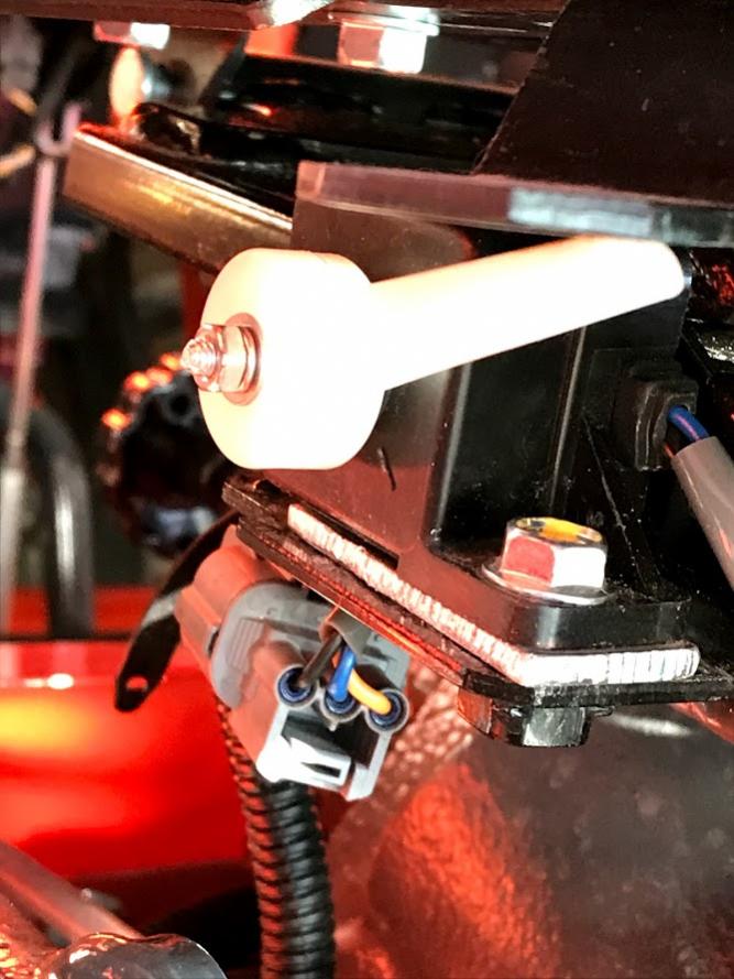

I had the same problem with the MX5800 so I just bent the bracket under the seat towards the lever and it works correctly now too.

I have a Bx23s, and I too had to lean back when going down hill. I glued a slug out of an electrical box to the bottom of seat bracket to push the plunger of the switch in farther. I also cut one coil off of the seat springs so that it would lean back better, orginally it was tilted forward both in driving mode and back hoe mode.

I stuck one of those furniture felt pad protectors on mine, it helped with the leaning around on the seat, but still does its job if I get up. Basically added 1/4" more play in the seat.

I just removed and replaced the bolt with a longer one to accommodate the 1/4 bushing I added.

here was my "fix"...
before and after photos.
after:
