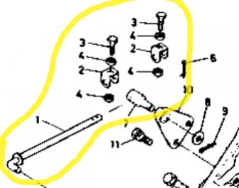

My B6100 is missing the position control arm for the three point hitch. Im going to fabricate one but would like to see a picture of what it looks like other than on the parts diagram. If someone has some time could the post a picture for me. Thanks

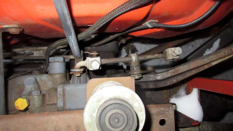

I’ve got mine at work awaiting sandblast. When I get in tomorrow I can get you some good measurements and pics

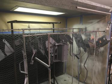

Its a zinc plating with a yellow diachromate coating applied after. The problem with painting of powdering bolts/nuts is as soon as you turn it with a wrench it destroys the coating and looks awful.

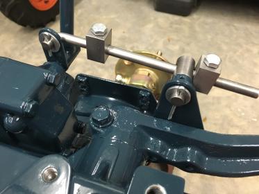

The original parts had a small hole (~1/16") about 1/8"from the end for a spring clip or cotter pin. Keeps everything on the shaft when they work loose. Jeff

I added it already. I had forgotten it. Thanks, good eye.

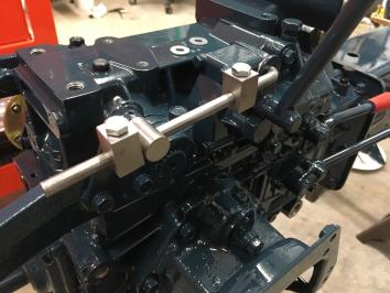

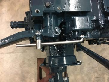

Did you make those stops? Looks much nicer than the stock.
Im actually thinking about changing to a different design that doesnt use tools to adjust the stops. Thought about drilling .125 holes every .25 the length of the rod and using hairpin cotters as the stops.
