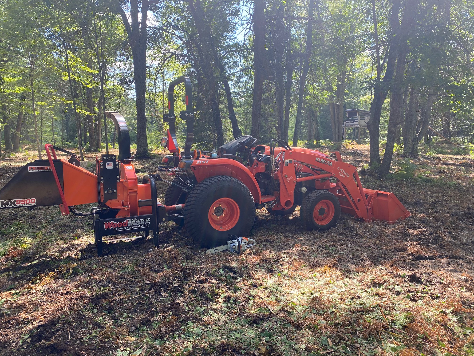

If your budget extends to new, I would buy new, have a warranty and focus on using your machine. I have over 300 acres of woodland and the L3901 is great for getting deep into the woods, it's much more difficult getting my MX5800 deep into the woods. My L series tractors run for a lot more hours on a tank of fuel and do a lot of the work that my MX can. If your land was all open and you had a lot of acres for groundwork I would advise you to get a cab MX. The L3901 will take longer to brush hog your 10 acres but not by too much. You will appreciate the L series size and the 39 HP when you are doing other work in your woodland.
Here's mine deep in the wood clearing an area for a food plot.

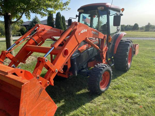

Here you go, everything you need in a tractor. Nice model, Grand L, cab.. 408 hrs. It's even in Mo.
