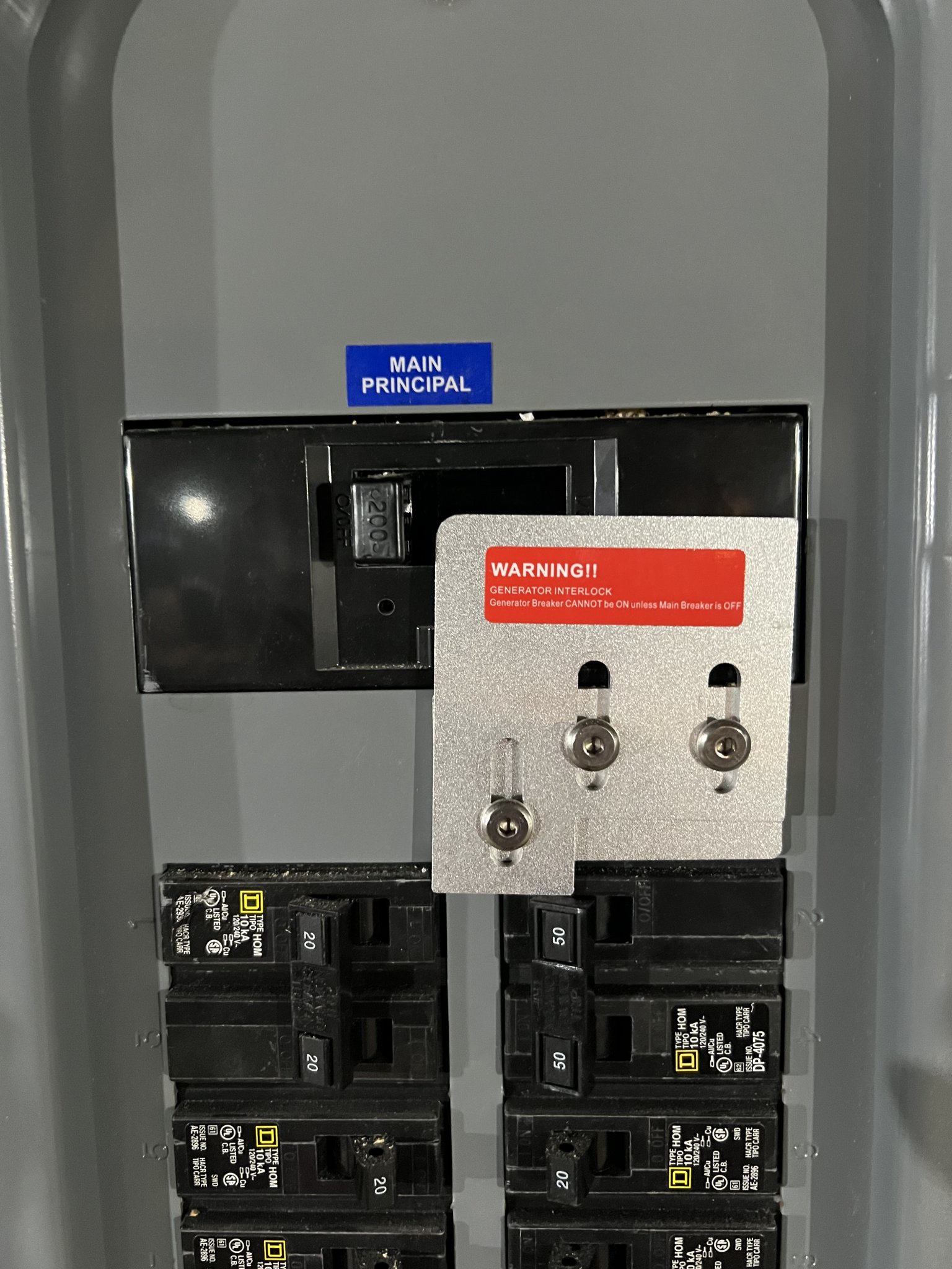

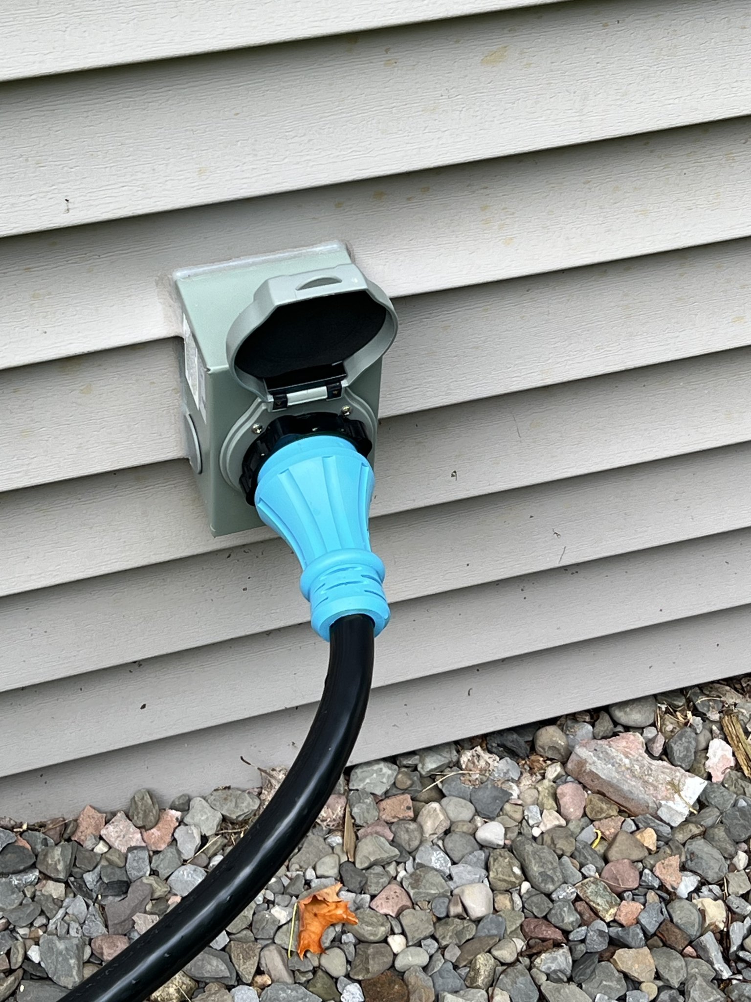

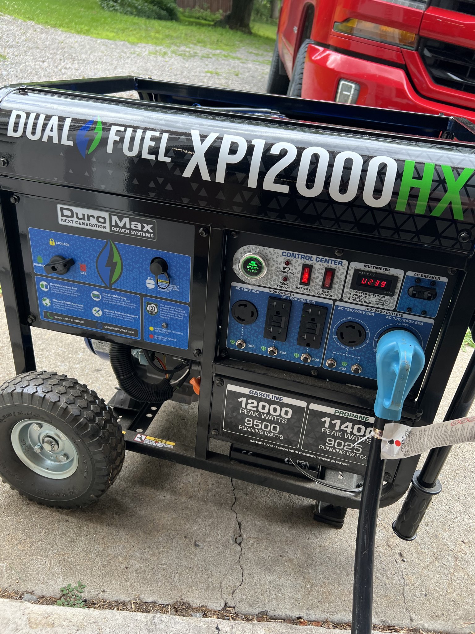

New setup is working great.
Genny is powering entire house, minus water heater, dryer and double ovens.
Could probably do the water heater if need be.
But would likely would challenge the 50A circuit unless I exchange some load to the 120v outlets on the generator (e.g., freezers in garage).
Generator is floating neutral, so there shouldn’t be an issue with ground loop. The house has a new service with proper ground.

You could likely leave your water heater on. Though it has two heating elements (probably 4500 watts each) only one will be running at a time. If the heater is well insulated (heater blanket or insulation) is shouldn't run very often anyway.
Also, I believe you can utilize the L5-30 amp twistlock outlet to run a splitter cord into your home to directly power a few items. That would allow for more items to be used from the back-fed panel if needed.
And you are correct about the floating neutral. That is the type generator you needed for your application though some gen-sets with bonded neutrals can be un-bonded.
Many thanks!
Wondered about the load on the water heater elements. Probably would be fine. I did switch the breaker on for 15 minutes or so and noticed no difference in genny operation.
I have 2 freezers and a refrigerator in the garage. Not far from where the generator was pictured. Using a much smaller generator, for years I ran cords to directly power the stuff I needed. Could easily do so to those appliances in the garage, and reduce load on the 50A circuit.
I learned about floating neutral here on OTT while back. I had a couple threads seeking advice on portable generators and interconnects. Was very helpful.

Congratulations on doing it "right". Just to clarify, your 50A outlet is indeed floating neutral, but the 30A outlet is not, it is bonded (based on schematic in manual). I suspect that 30A outlet is more for portable use with things like travel trailers or portable/remote workshop, not for house tie-ins. The 50A outlet seems designed specifically for house connection via 2 pole breaker/interlock. The GFCI 120V outlets are also floating neutral, else the GFCI would not work properly.
And, a proper interlock at the panel just makes it all safe for everyone.... You did your research....
