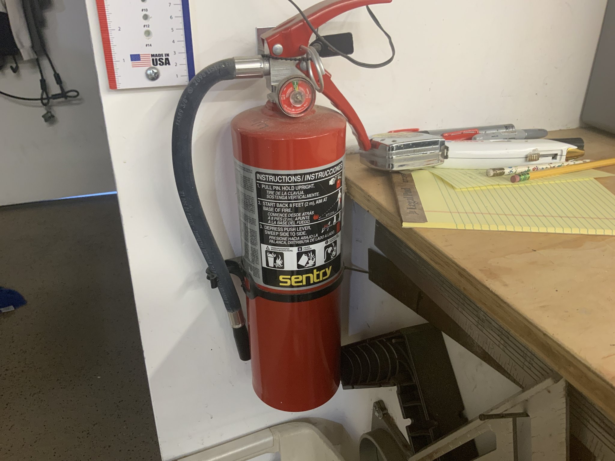

Can I get an amen that this fire extinguisher looks OK ??

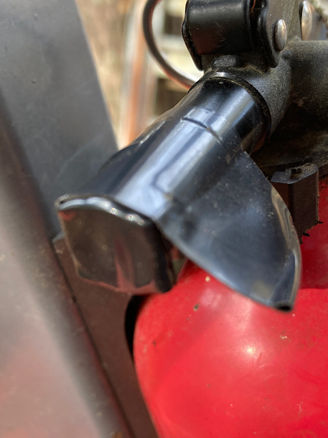

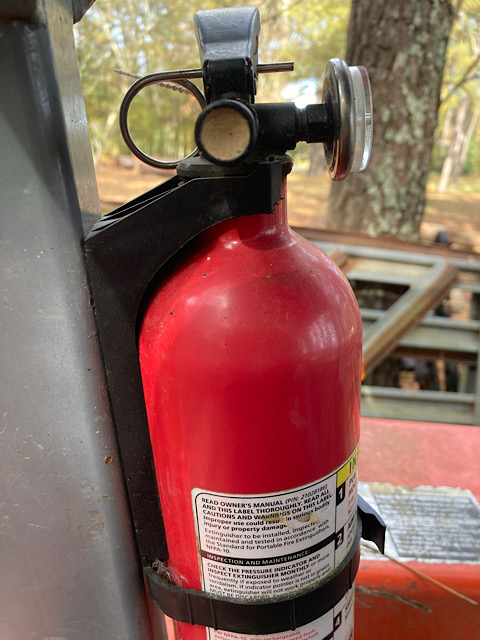

And I would agree until you look into the nozzle!! Yikes!!! A dirt dauber had decided to make this it's nursery. I cleared the nest out including the inner seal.

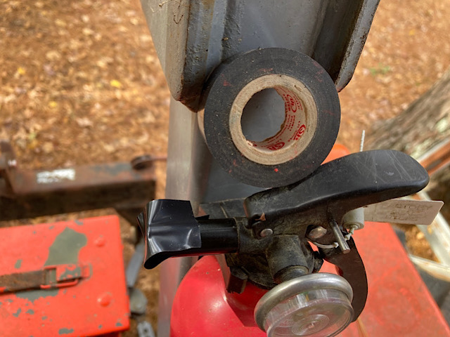

And then taped the end such as I do on the muzzle of my rifle.
I folded the tape end back onto itself to provide a pull tab to quickly remove the tape.

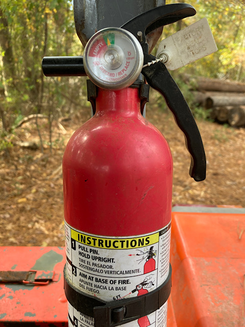

That looks to be the exact same model of “Kidde” fire extinguisher which the company “recalled” last year and replaced with all-metal extinguishers free-of-charge.
The comment about turning them upside down and smacking them with a rubber or wooden mallet is also good (to break up the powdered-extinguishant that cakes up inside them.)
Lastly…. those powdered extinguishants work by melting and smothering the flames. Cleaning up that mess is choresome… to the point that it will ruin electrical wiring, upholstery, mechanisms, etc…. A Carbon-Dioxide…or BEST OF ALL…. a halogen type (Halon) is the best fire extinguishers to use on equipment you intend to return to service. (expecially on electronics like modern tractor circuit-boards/instrument clusters and fuel. (Halon works by tie-ing up oxygen molecules…so if you use it in a closed room or space as soon as possible get outside where you can breathe…. (In airplanes we use it but provide passenger oxygen masks.)
There are Type ”A”, Type ”B” and Type “C” fires and the extinguishers are rated for the type fire…such as a 10A:5BC extinguisher will be appropriate for fuel and electrical fires…(rated similar to 10 gals of water on wood/paper and applicable to 5 sq ft of fuel fires)….but not rated on electrical even when listed)
Note that an extinguisher that is rated only “B/C” is not effective on paper/wood/cloth/etc.

I had to replace 4 extinguishers in that recall - but I only remember one in 2017. You can check if yours is on the list at https://www.kidde.com/home-safety/en/us/support/product-alerts/recall-kidde-fire-extinguisher/
Yes…. I abbreviated…it was a couple years ago, not “last” year. I replaced 4 also (had bought a 4-pak from HomeDepot)…. and Kidde sent me the recall-notice and I signed it… then after a couple weeks I called the 800-number and they apologized…. Next week 4 replacements arrived…then the week after 4 more arrived…. So I called teh 800 number again to ask what I should do about the extra 4…and they said they’d get back to me….. I’m still patiently waiting… meanwhile I’ve installed them all over the place…2017..?? really..?? Time flies..….:p

I hope you remember that tape in time of emergency…and that it hasn’t got stuck and stringy when you need a clear nozzle. Hell, a cork would be better as it would get blown out upon use…

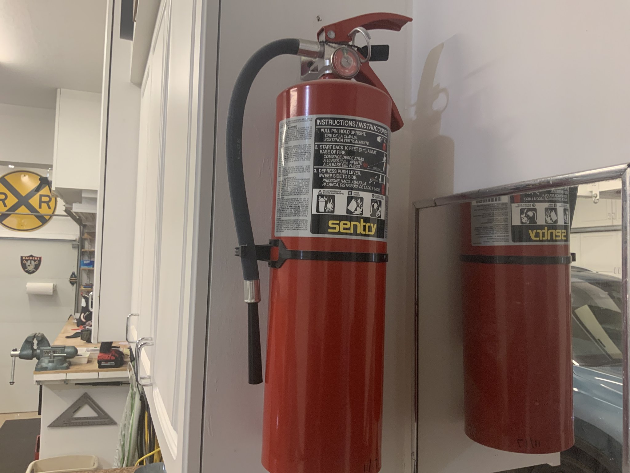

The Carbon Dioxide and Halon extinguishers are EXPENSIVE!
For affordable extinguisher protection, dry chemical extinguishers (with metal valve) are the way to go.
Clean up is ugly, but the item in question is saved from destruction by fire.

The best all-round general purpose extinguisher is an ABC dry chem.

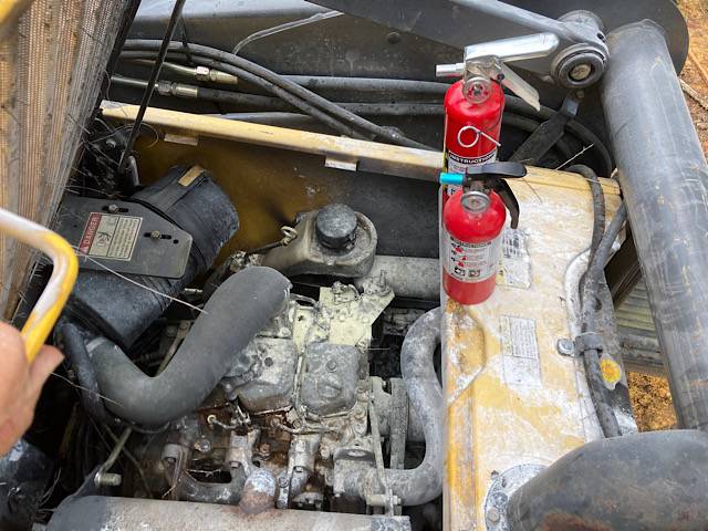

Here is a New Holland Skid Steer that I kept from burning to the ground back in June with two of those Kidde Replacements.
