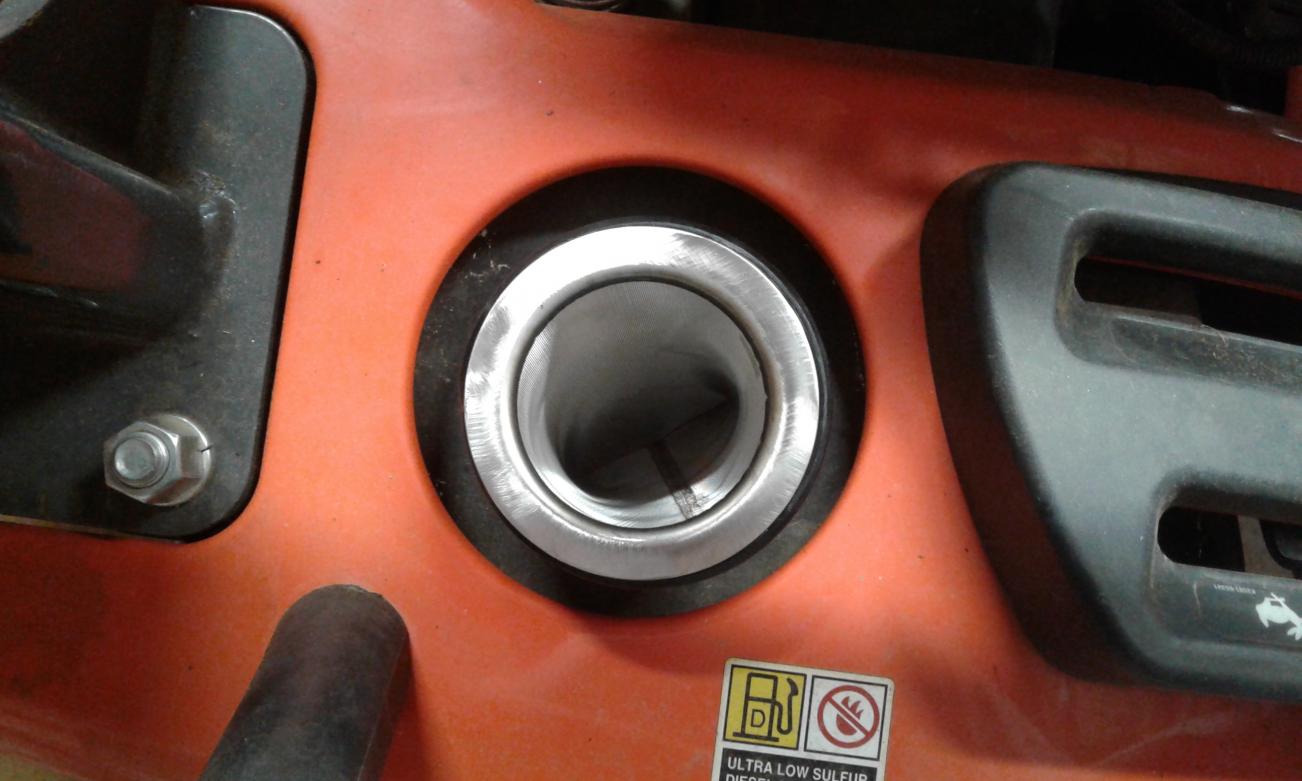

After hearing a lot of concerns over the problems with debris getting into the BX series diesel tanks, I decided to try an experiment. I have been filtering my fuel via a teflon filter than damn near blocks all - including water! I have never had a problem with a clogged filter to date! OK - knock on wood here.....
BUT to do it, I have to place the filter in the opening, make sure it does not move around and spill diesel all over the place..... and then tilt up a five gallon jug of diesel and pour somewhat slower than normal....stop , check height of fill, repeat , repeat ....etc!!!! And yes, an overfill makes a helva mess!:p
SO - there has to be a better solution than a slow pour and check and recheck! Those of us that have the older B series (not sure about newer ones) the tank had a prefilter built right in! This probably stopped 95% of the bad stuff....and then the inline filter hopefully got the rest!
so I did some measuring and got in contact with a manufacturer of stainless steel filters. They make custom made filter systems for anything you can imagine......lot of measuring and excellent communications from this company and now a prototype and how it fits into the filler neck of the tank.
I poured diesel and it poured as fast as you wanted......this is a 74 micron filter, so it will stop a lot of stuff, however, it will not stop water.
The first one is rather $$$$ , not sure if people are willing to pay $75 for a stainless steel filter, but I paid a little more for the first one. The top fits back perfectly and snugly and the filter stays in the tank, it can be pulled out quickly if needed.
PM - if anyone is interested in this concept or has any questions!

I think you should add a gasket/seal between the tank and the new filter insert.
For the Mr. Filter process you describe- they do make larger filters with multiple vertical filters so the flow is increased.

As fast as you can pour;)..........now this strainer is 6" deep, almost hits the bottom of the tank, but does not!:)

Ok...so around the same time I also ordered a filter from the same shop: Utah Biodiesel Supply.
Pros...mine fits inside the second lip of the BX25D tank...and hopefully I will not have to pull the tank the next time someone drops something in. Flush fit.
Cons...price...north of $70 with shipping. Took three weeks to get here.
Hopefully Utah Biodiesel Supply can take our designs, mass produce them and get the cost down.
The OD is 3.1" and the inner is 2.5". 100 micron mesh.
And yes...my cans have filters.
