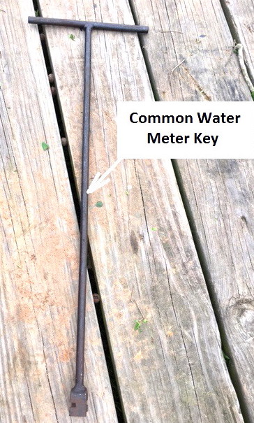

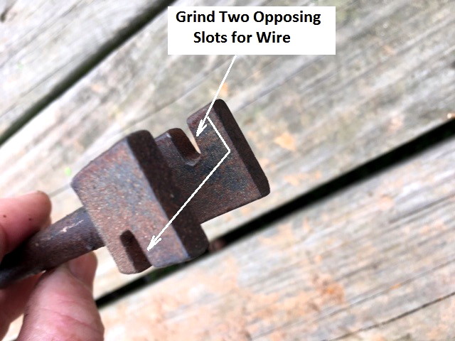

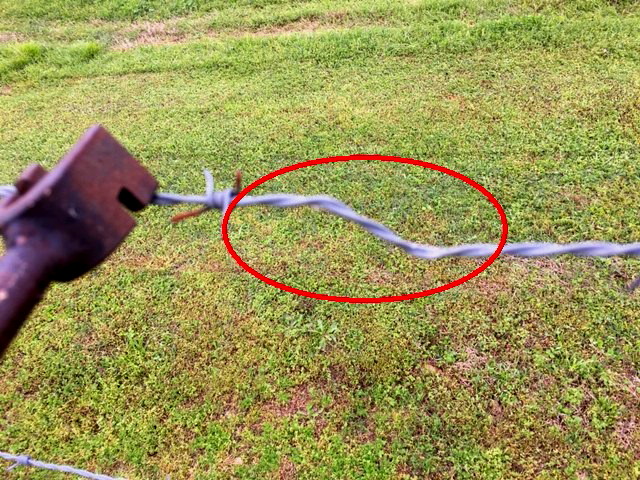

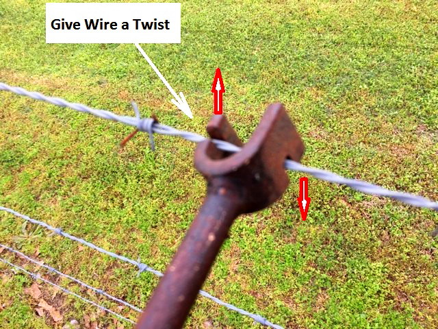

If you need something simple, easy, inexpensive, time saving and long lasting try these.
You can get them on Amazon in smaller quantities, etc.
'Simple' is just using what you probably already have around. Easy to make a quick modification to a Water Meter Key to use as a strand tightener.
It just creates small 'kinks' in the wire (shallow kinks as shown in pic below, to over 90° if needed).

Having tight wires helps keep the livestock from entangle themselves when they think the grass is greener on the other side.
Absolutely. (y)
And while a determined 'cow' will find a way to stick its head through the wire and eventually re-stretch it....it is less likely they will do so if the wire is tight. Also, using fence 'stays' can help keep fencing in a condition that is less inviting for livestock to stick their heads through.
It is well worth the effort to keep barbwire tight but doing a mechanical re-stretch of the entire length just isn't feasible many times. Hence the need/practice of 'crimp' stretching....which works well enough in most situations.
