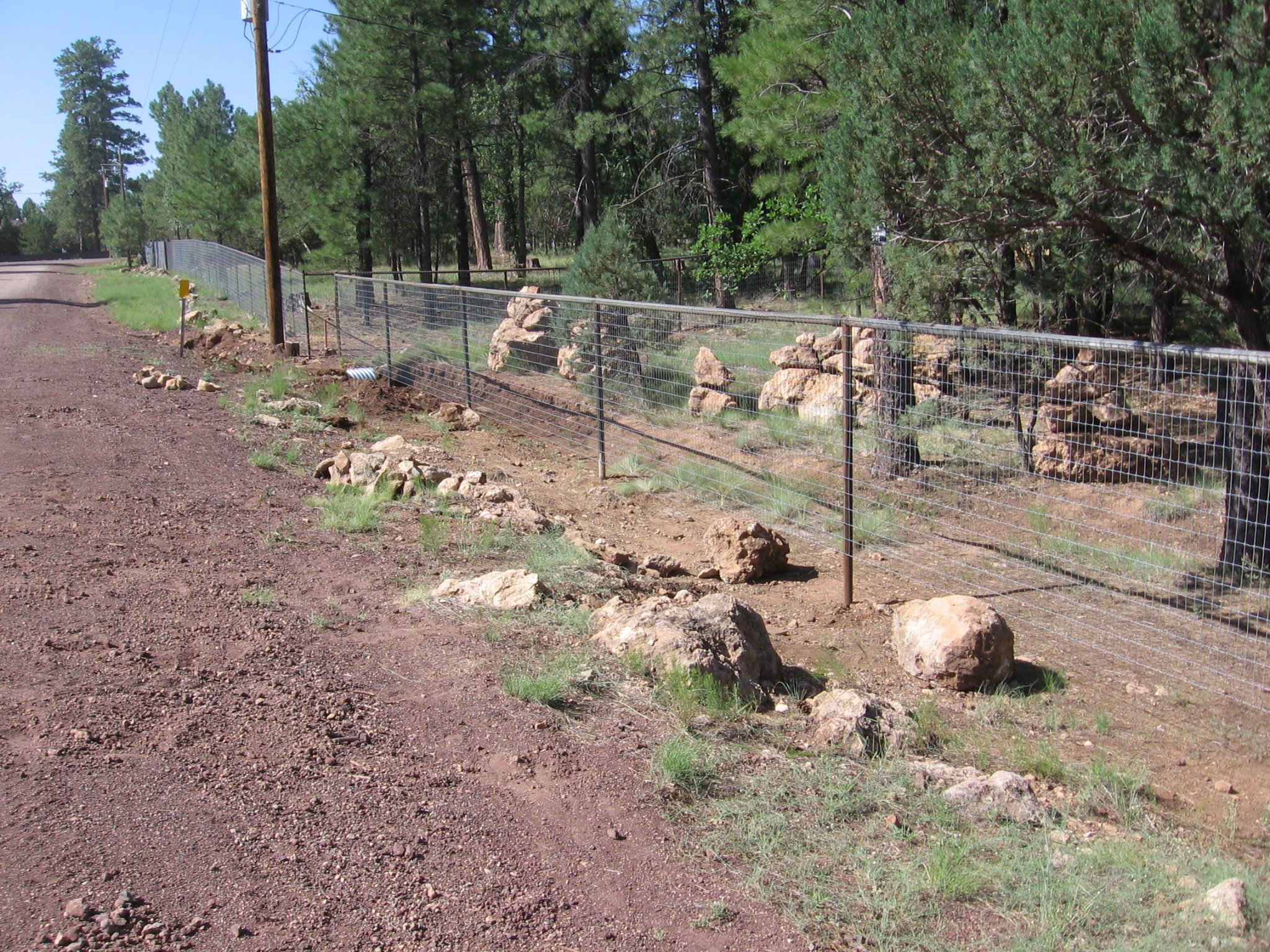

I have shelved most of my projects (notably my excavator rebuild & repair of my leaking B7100) in favor of working with my fence contractor to fence our high country property.
We had been on a waiting list for almost 3 years.
Fencing is virtually all done, just a few clean up details. 1712 linear feet, one 3ft gate, one 10ft gate, one 24ft gate.
2 3/8" heavy wall drill stem posts & top rail 100% welded, 7018 rod.
Posts set in concrete 18"dp, in 6-8" holes. (auger is 6", but it 1s so rocky they usually end up nearer 8" diameter)
Big gate posts are 4", set 3+ft dp.
4ft heavy wire no climb fabric, except for an area up front. ( see below)

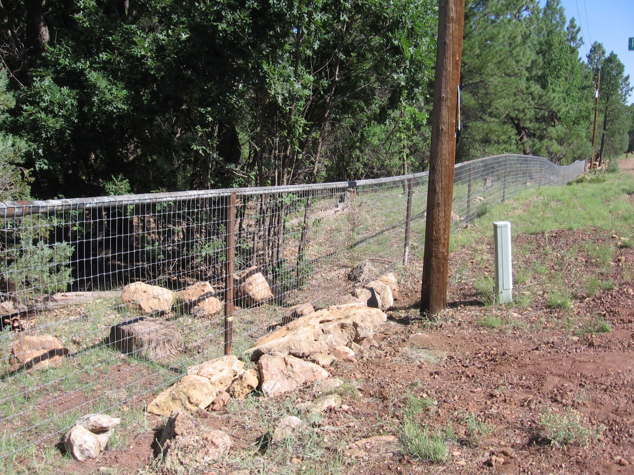

We have a pretty big drop off at one end of the frontage, plus a 16" county culvert dumping on that end of the property also.
After looking at various scenarios, we extended the county culvert 7' to go under the fence, and used 5ft fabric in the low area.
This made the top of the fence even with the 4ft fence on the high side of the drive, and even with the neighbor's 5ft existing fence. (it looked terrible with short posts & 4ft fabric)
But it left a big gap under the fence fabric in the low area, which I am building up with (mostly) large rock.
When the "retaining wall" is complete, we will fill in the low area on the outside of the fence, up to the bottom of the fence, with some free local fill, aided by the fence contractor and his LARGE backhoe & a couple dump trailers.

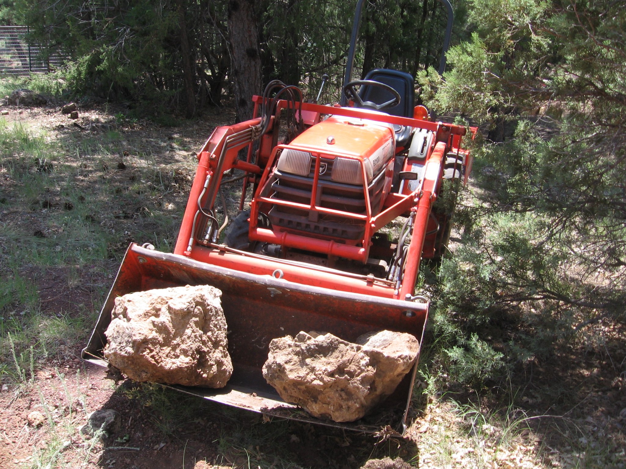

My neighbor to the north had recently bought a new fully loaded BX23s, and graciously granted me the use of his old B2100, knowing my tractor was down for the count.
It is great to have wonderful neighbors!
The wife and I moved & set all the rock in the pics this past Friday, Saturday, & Sunday, but knocked off before it was done, because Monday was our anniversary.

Looks great.
How is wire being attached to the line posts and top rail? I don’t see anything in the pictures so may have been stretched but not attached yet. I like the no climb but it is difficult to get it to follow terrain very well.

Wire fabric is tied on with .040 or .045 black wire, 3 places on each post, and two places on the top rail between posts. Kinda hard to see in these pics.

The HST tractor took a little getting used to, compared to my gear tractor.
It is noticeably bigger than mine.
The HST pedal sometimes had a little creep in either direction, requiring a slight tap on the pedal in the opposite direction.
The starter did not always work each time, sometimes on the first try, other times 3 or 4 tries. Seemed like a relay problem. (click behind the dash?)
The FEL was MUCH slower than my B219, unless revved up. Lifting capacity seemed about the same.
Dash throttle was nice, but I found myself reaching for my throttle pedal more than once..
