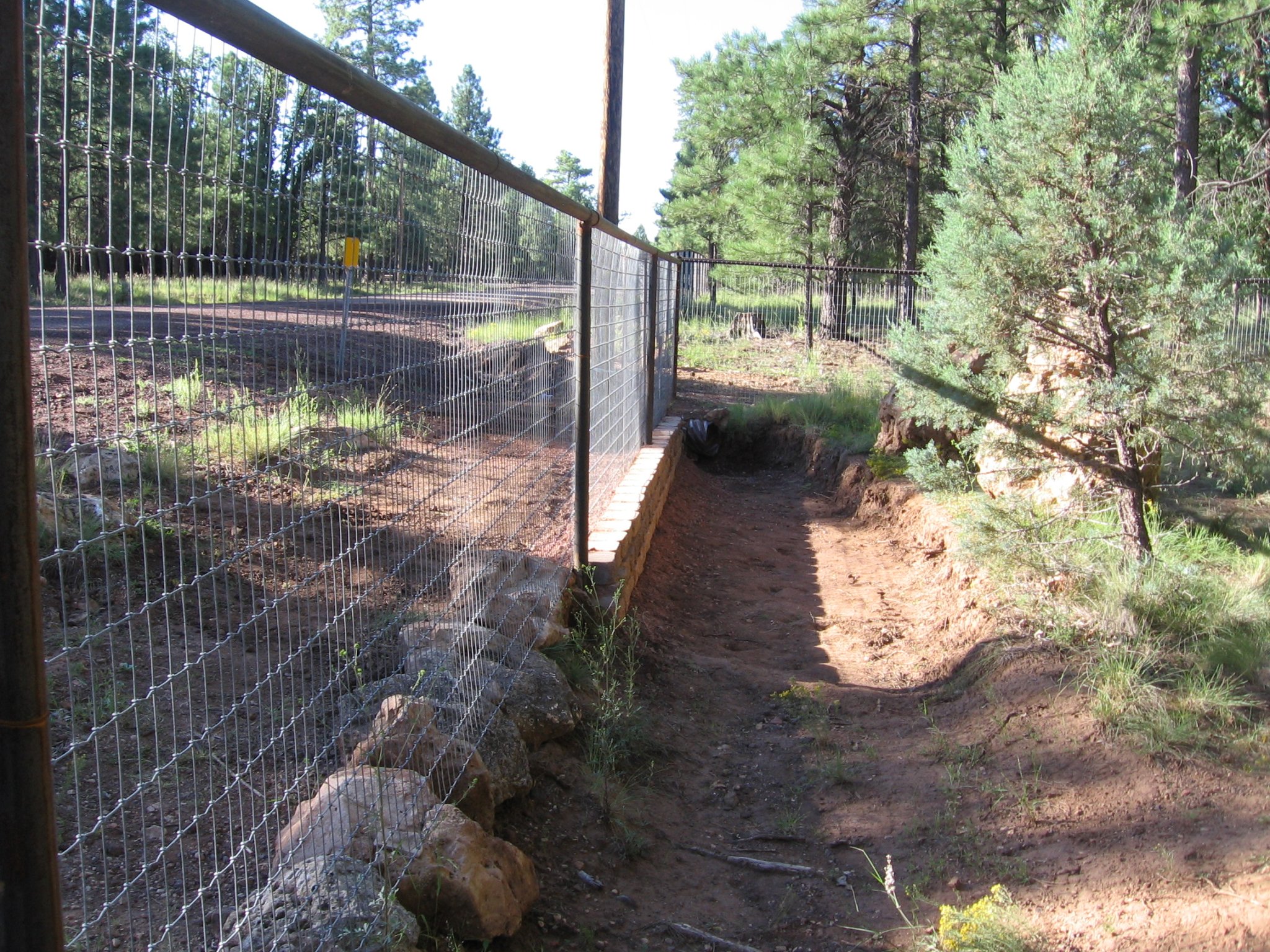

Yup, just to act as a retaining wall, then I will add fill up to the top of the rocks to fill in the gap underneath the fence wire.

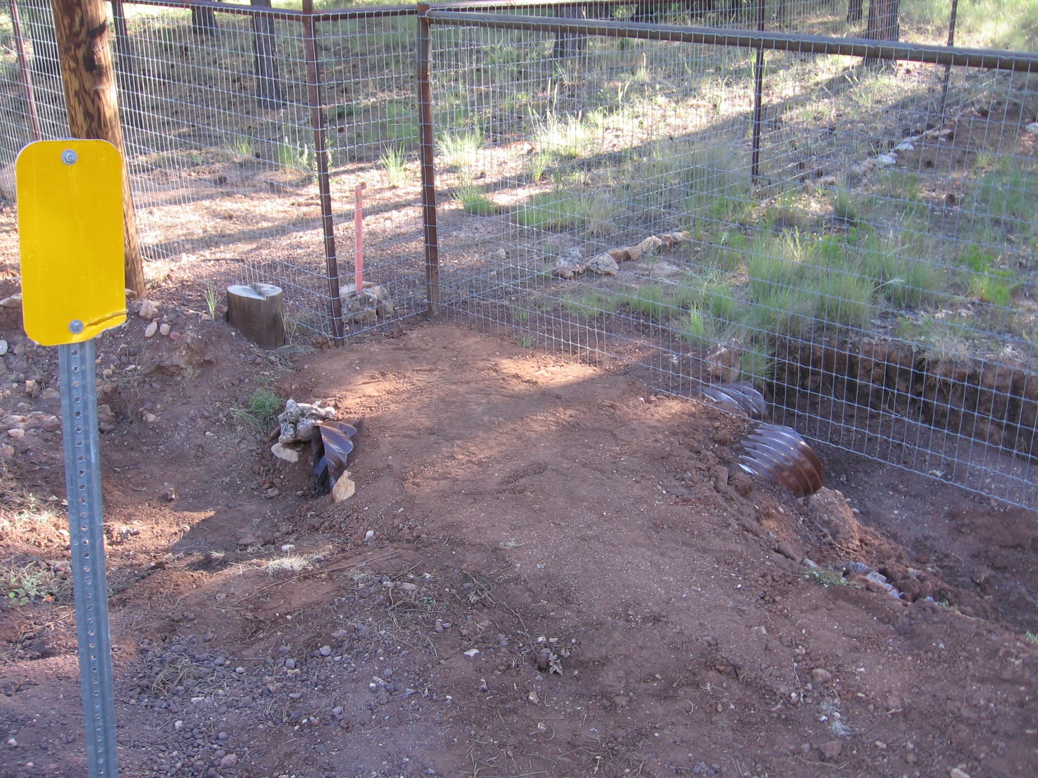

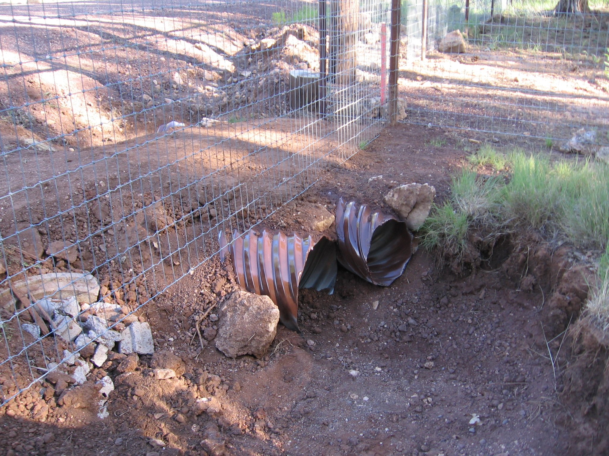

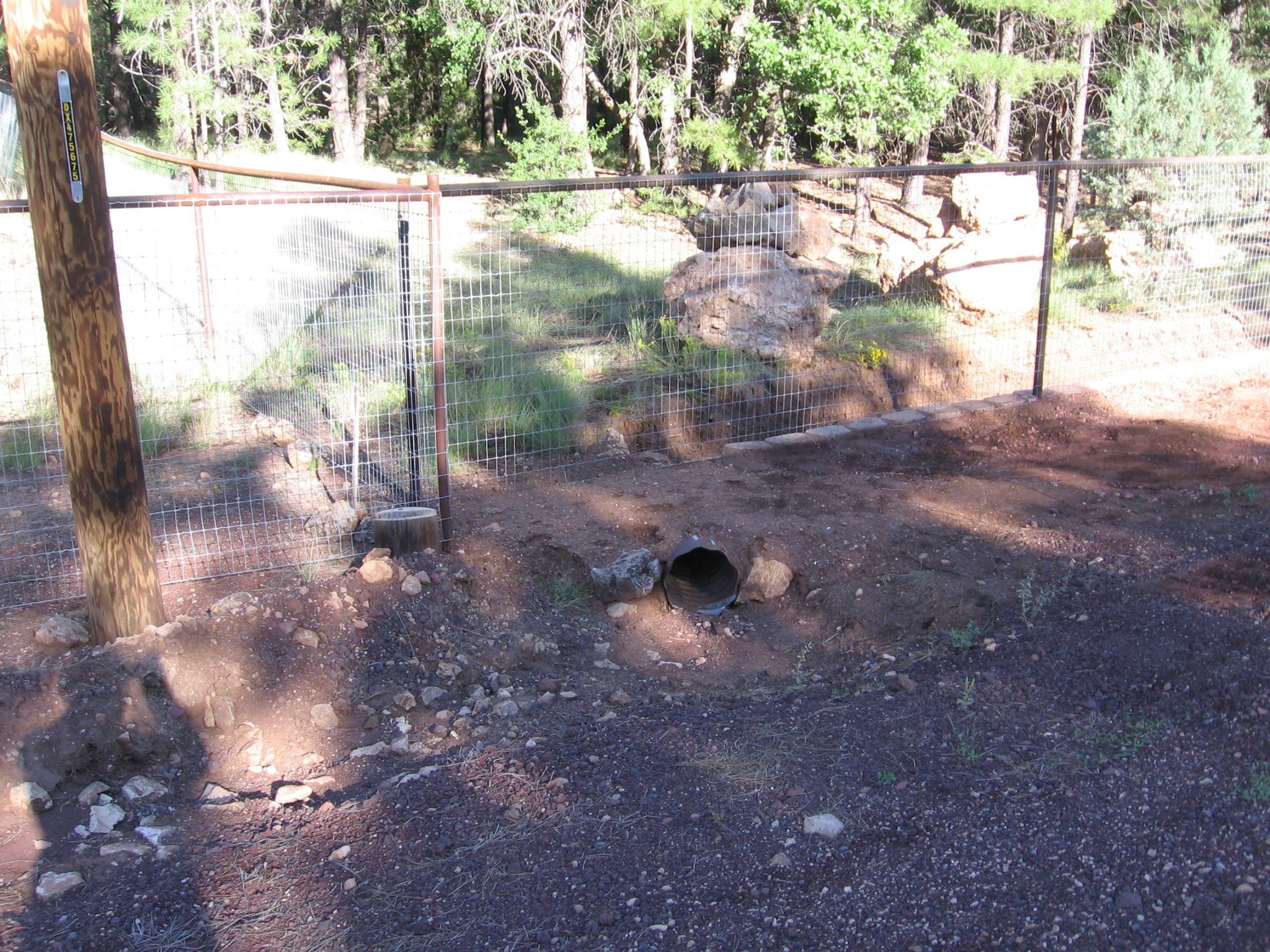

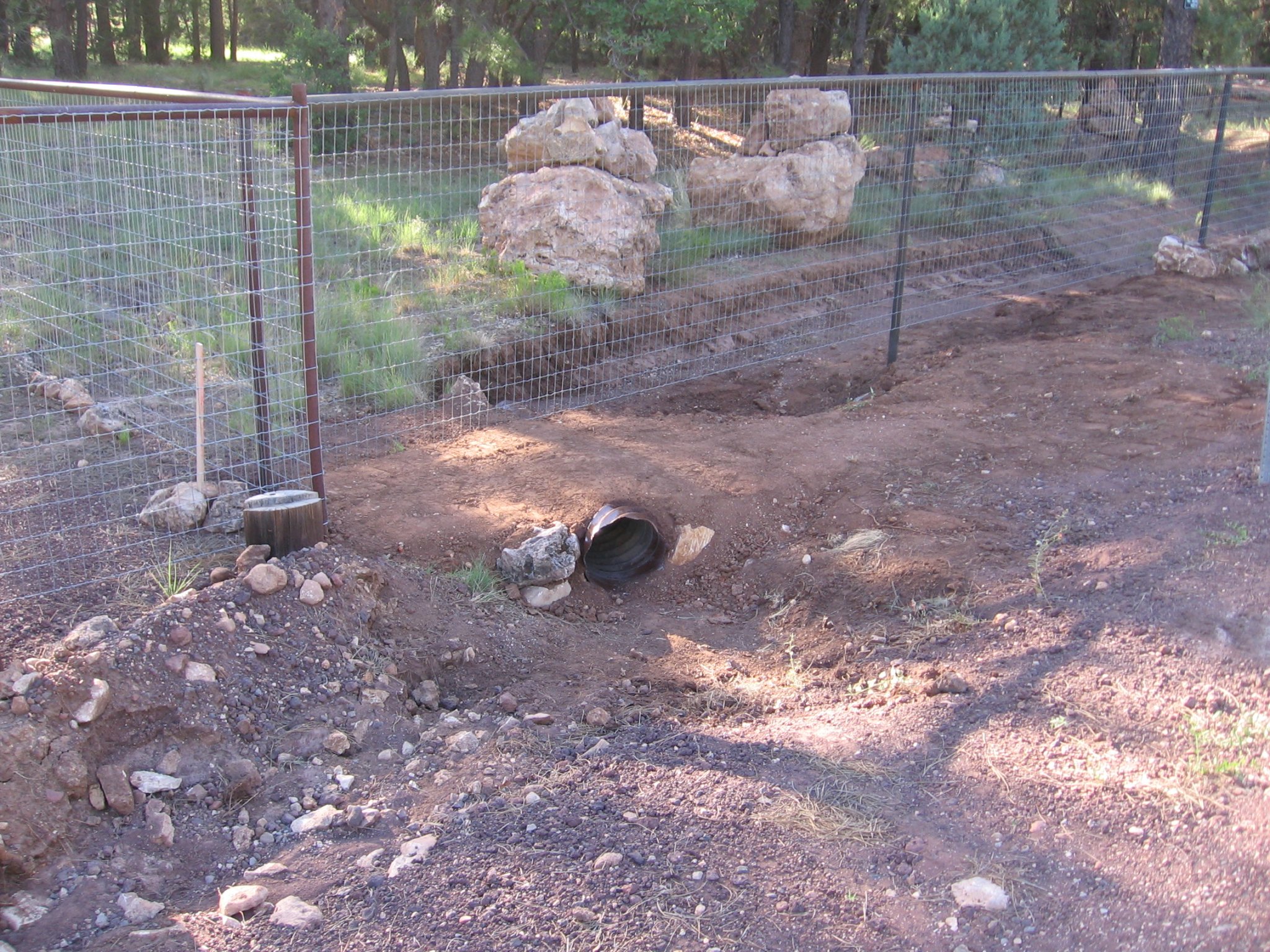

Did some more rock work, and added a 12" culvert to bring water from the county ditch under the fence.
Next, I will be building a short retaining block wall inside the fence, between where the rocks end and the culverts, to prevent the dirt bank from collapsing/eroding.
I will also add some concrete pavers to the side & bottom of the water course to stop erosion near the culvert outlets.
Added a little dirt the neighbor brought me to a low spot near the gate.

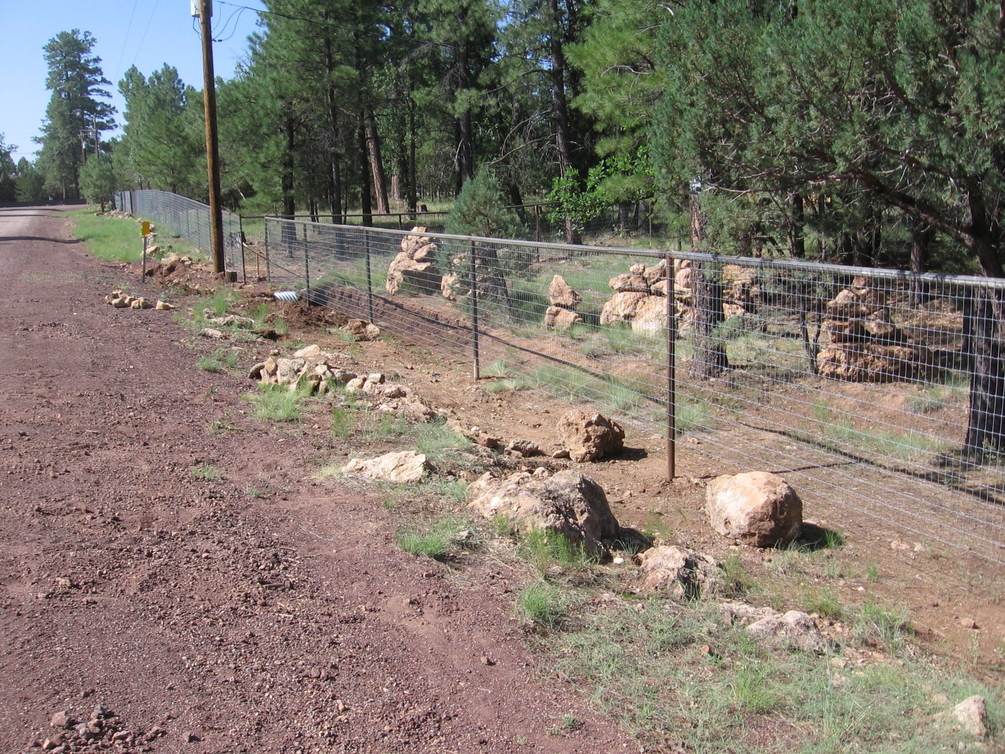

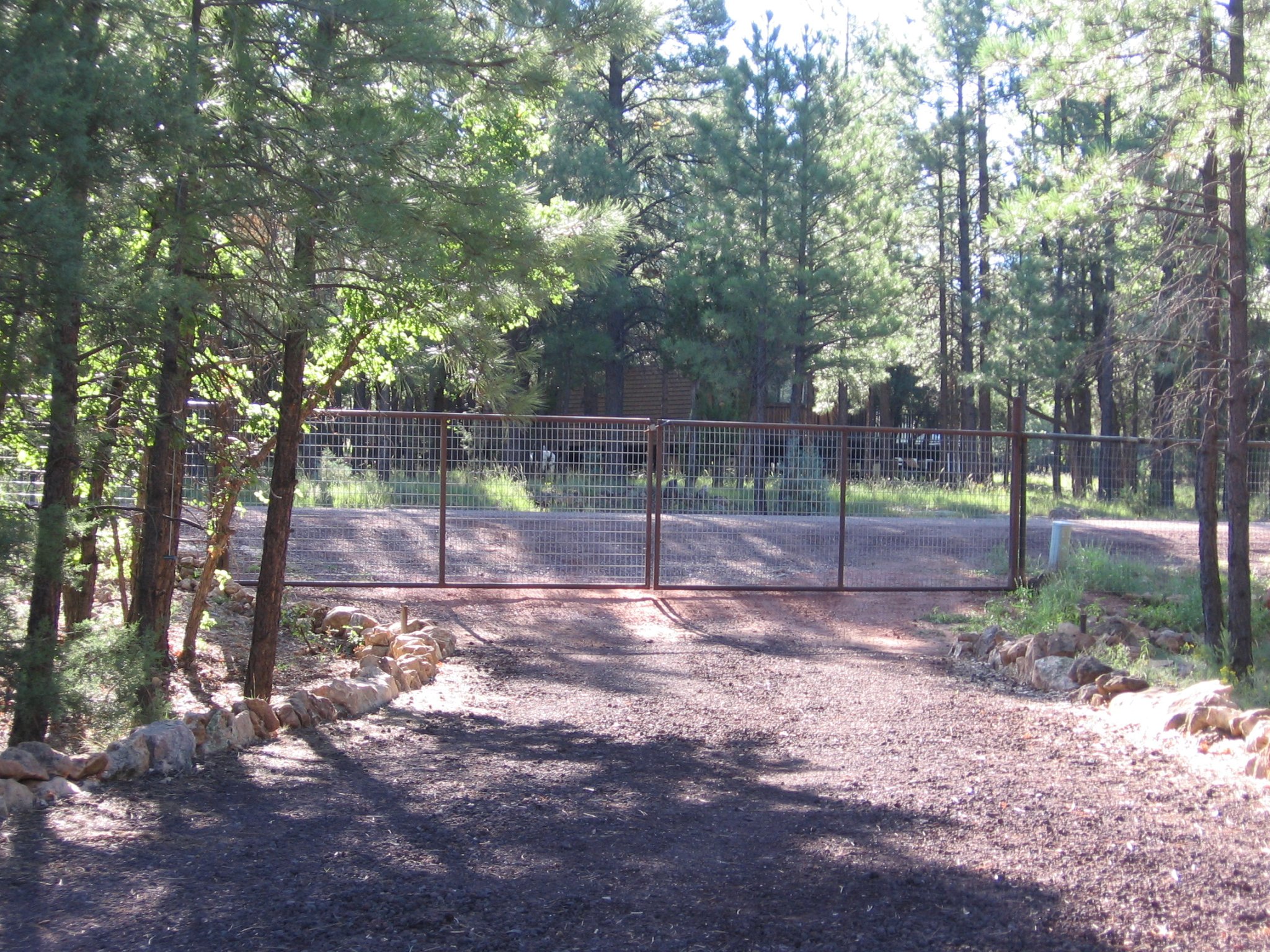

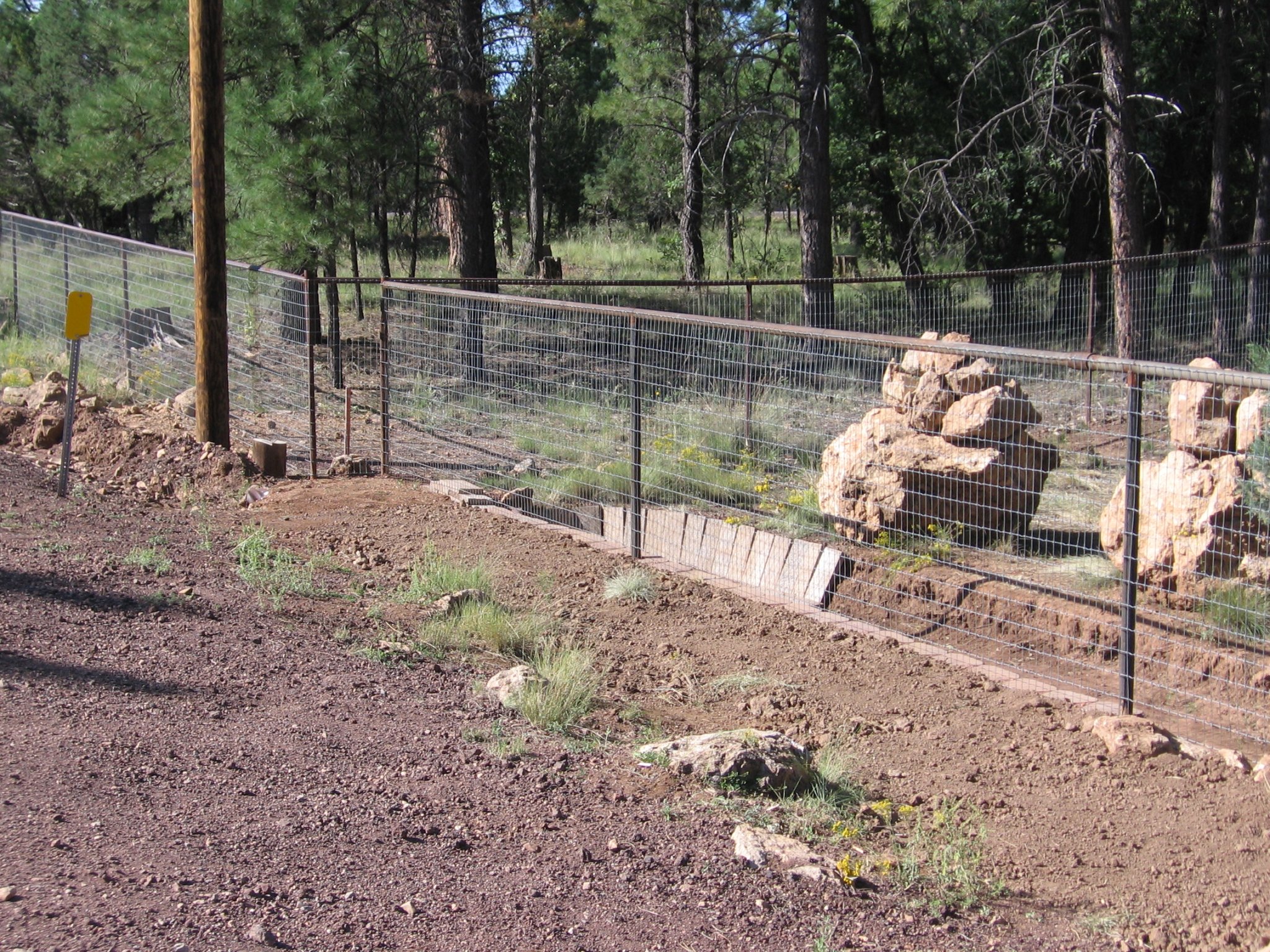

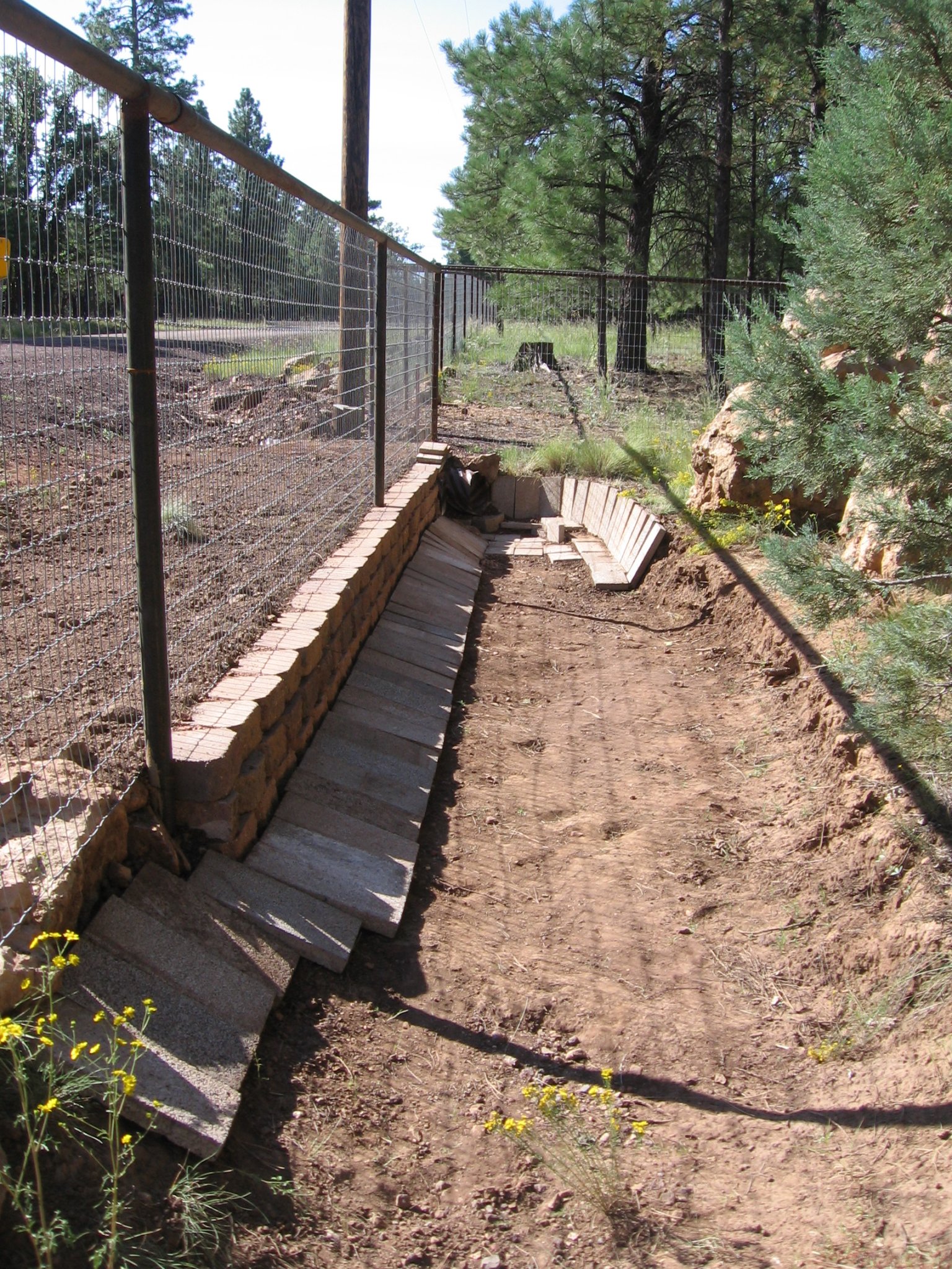

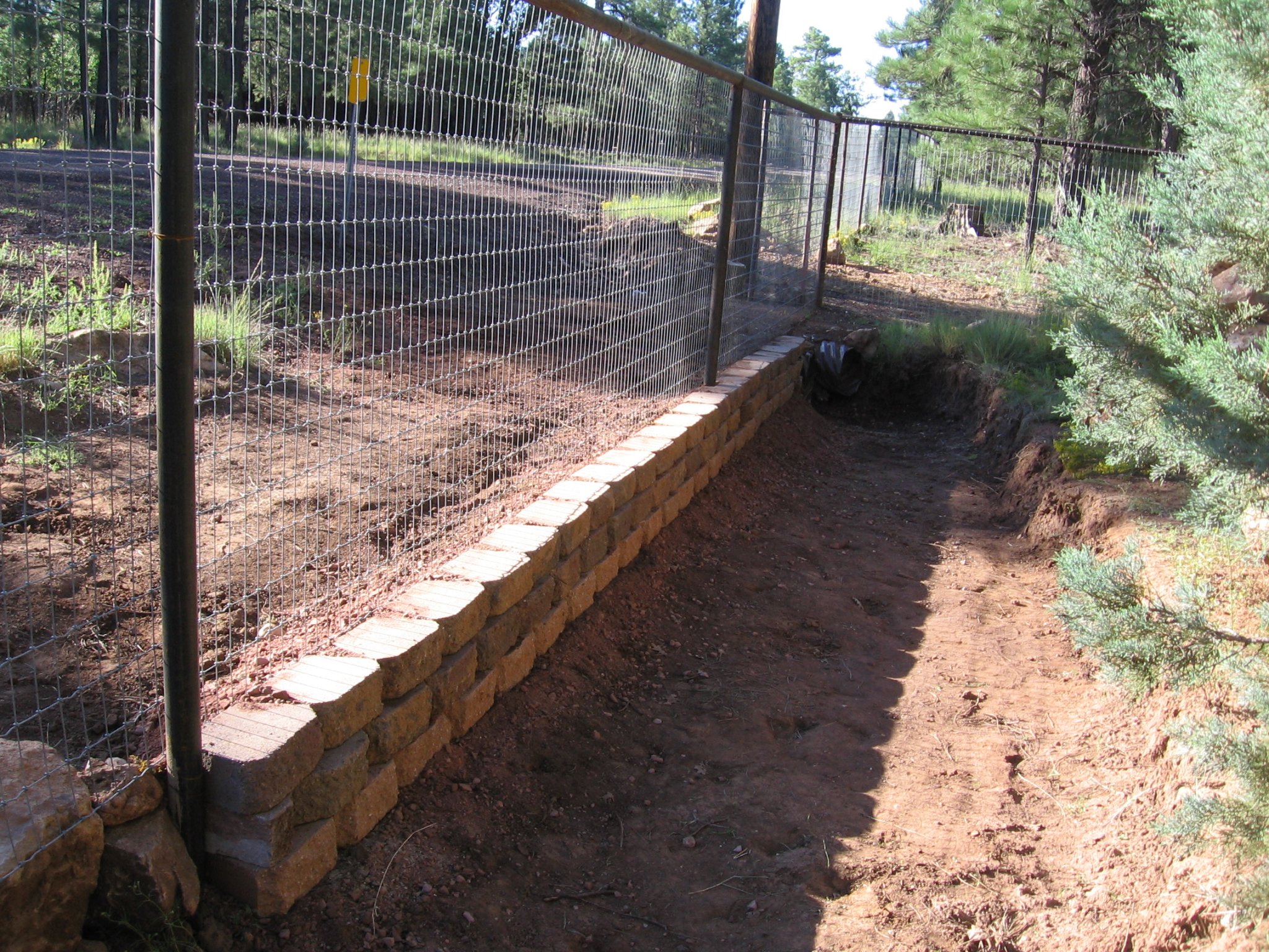

Got some more rock wall built, built at block retaining wall, and finished the gate install.

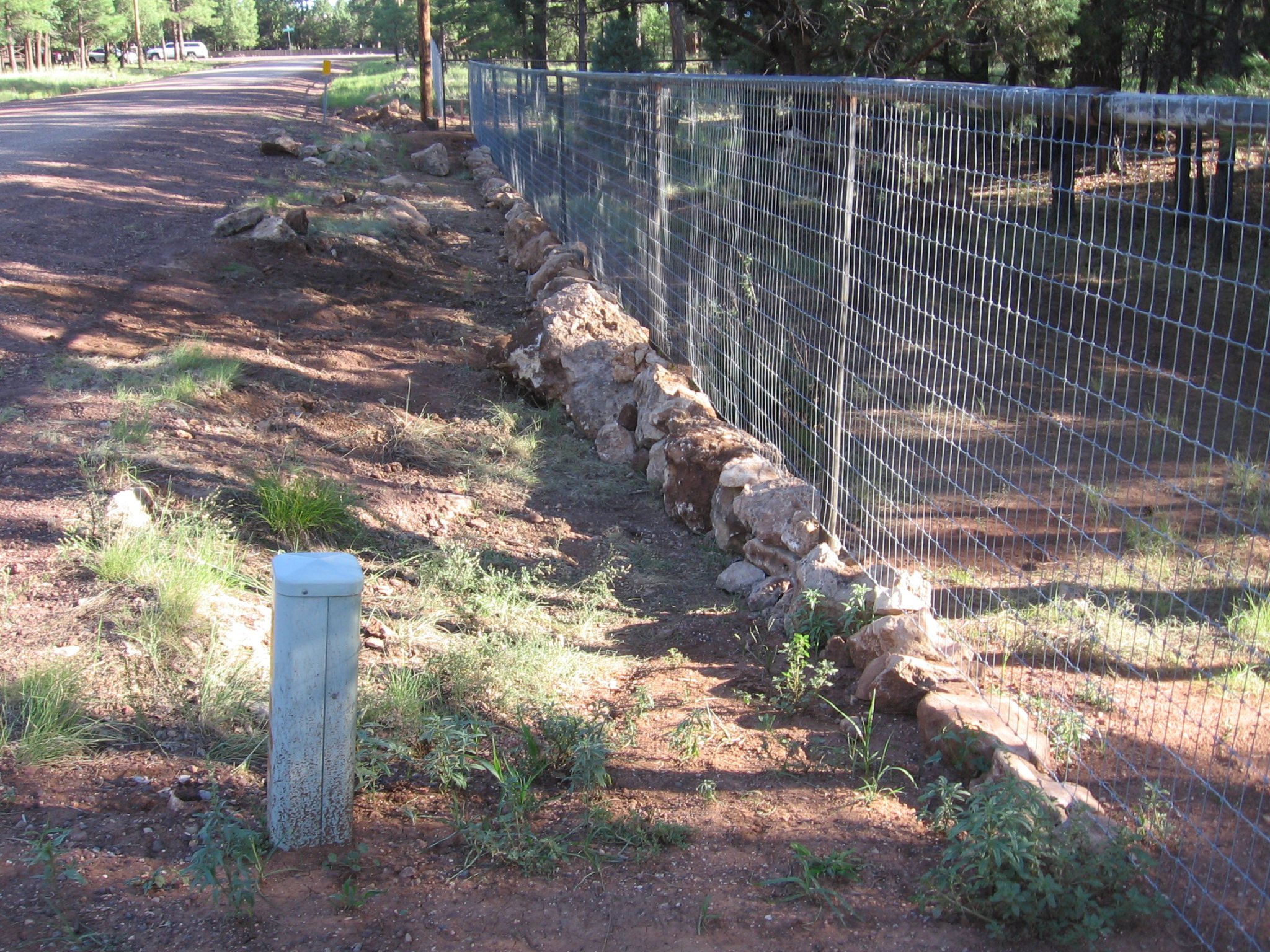

More pics:

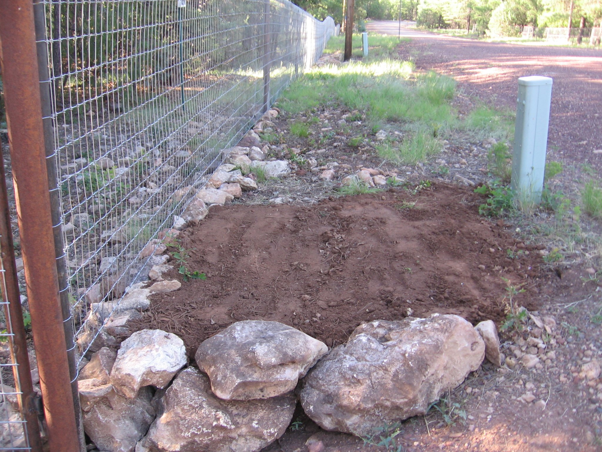

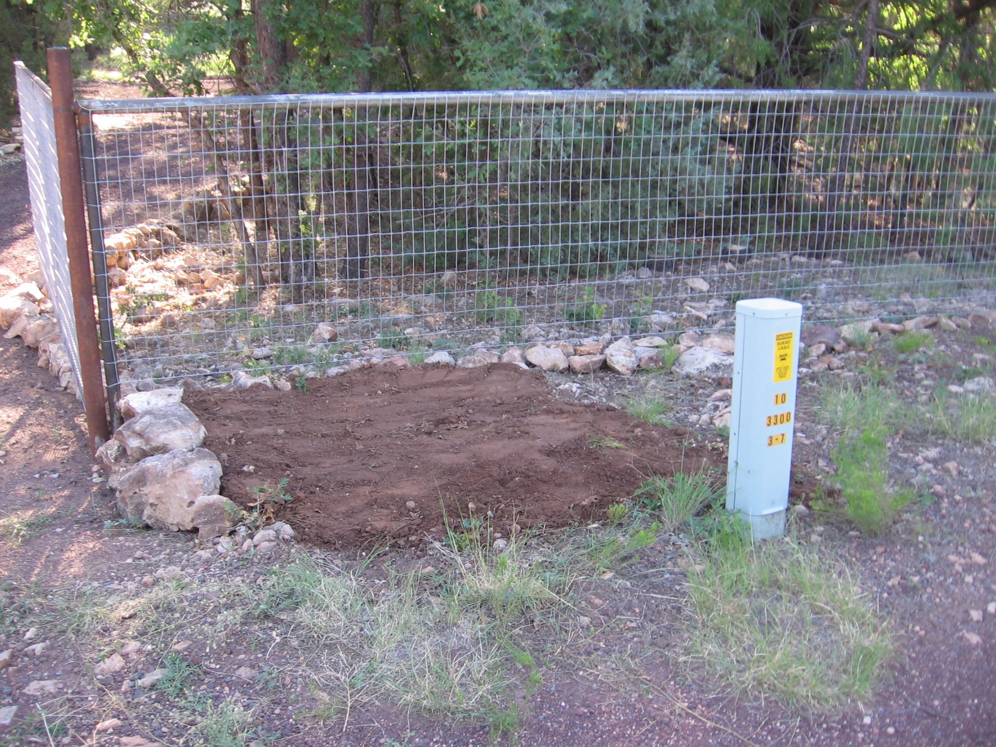

As we were packing to leave, fence contractor called and said he was bringing 8+ cubic yards of clean fill.
As he dumped, I shoveled & raked out each of the piles, while he went for the next load. Got the low spot pretty much filled and spread & somewhat level. But I forgot to take pics of the filled/leveled area, so those pics will have to wait for the next trip.
8,200
3,581

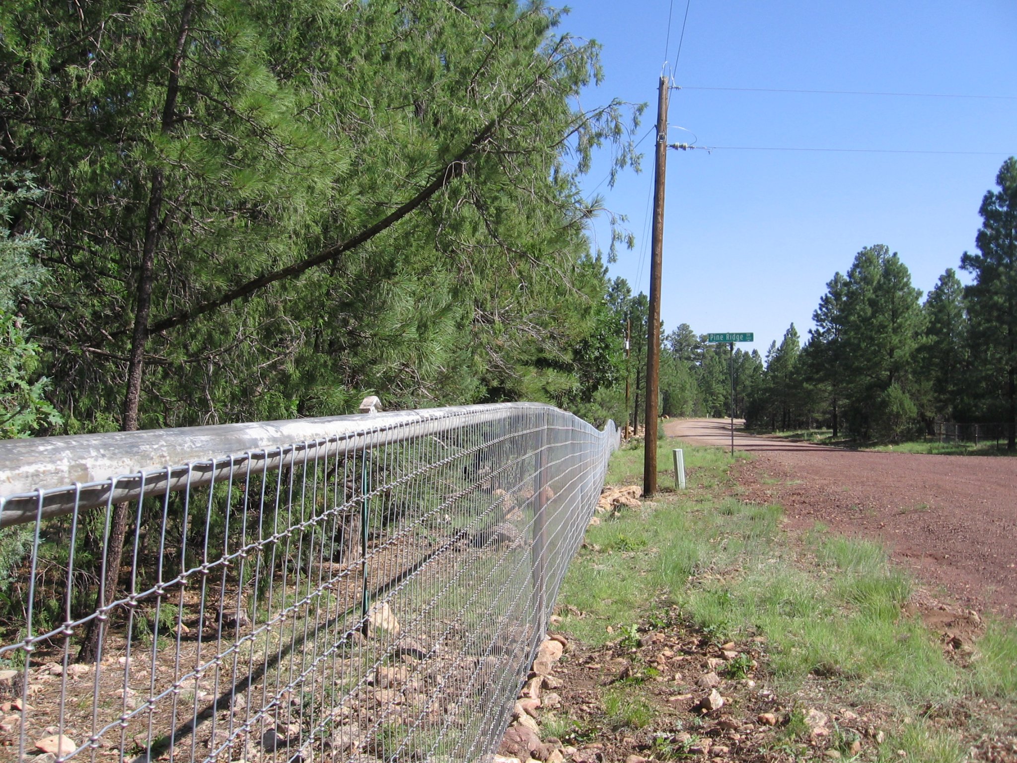

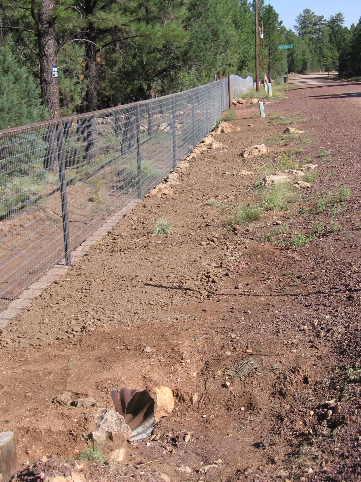

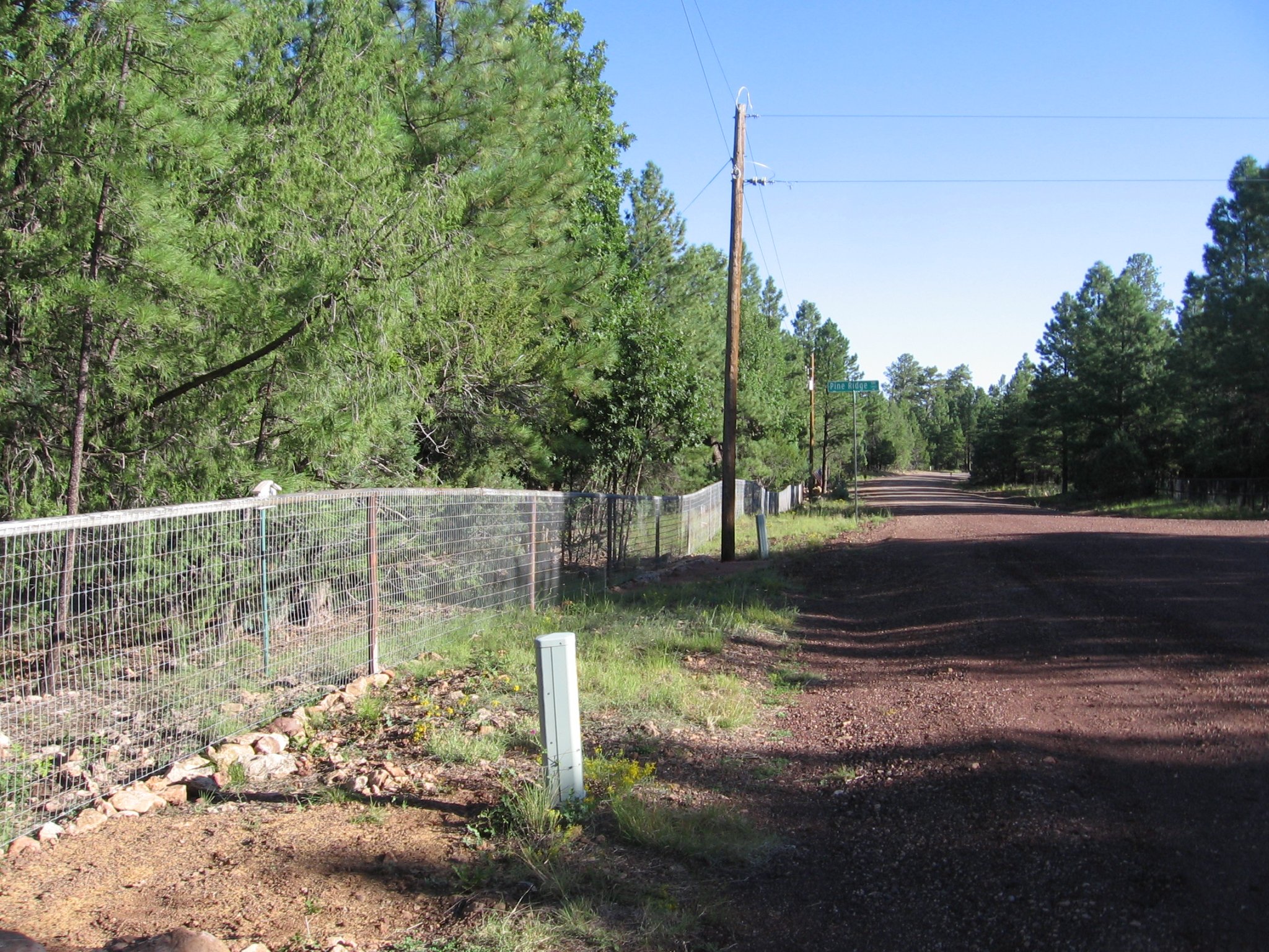

Finished leveling & raking out the fill, also placed some block to prevent/slow erosion where the culverts' discharge enters the water course,

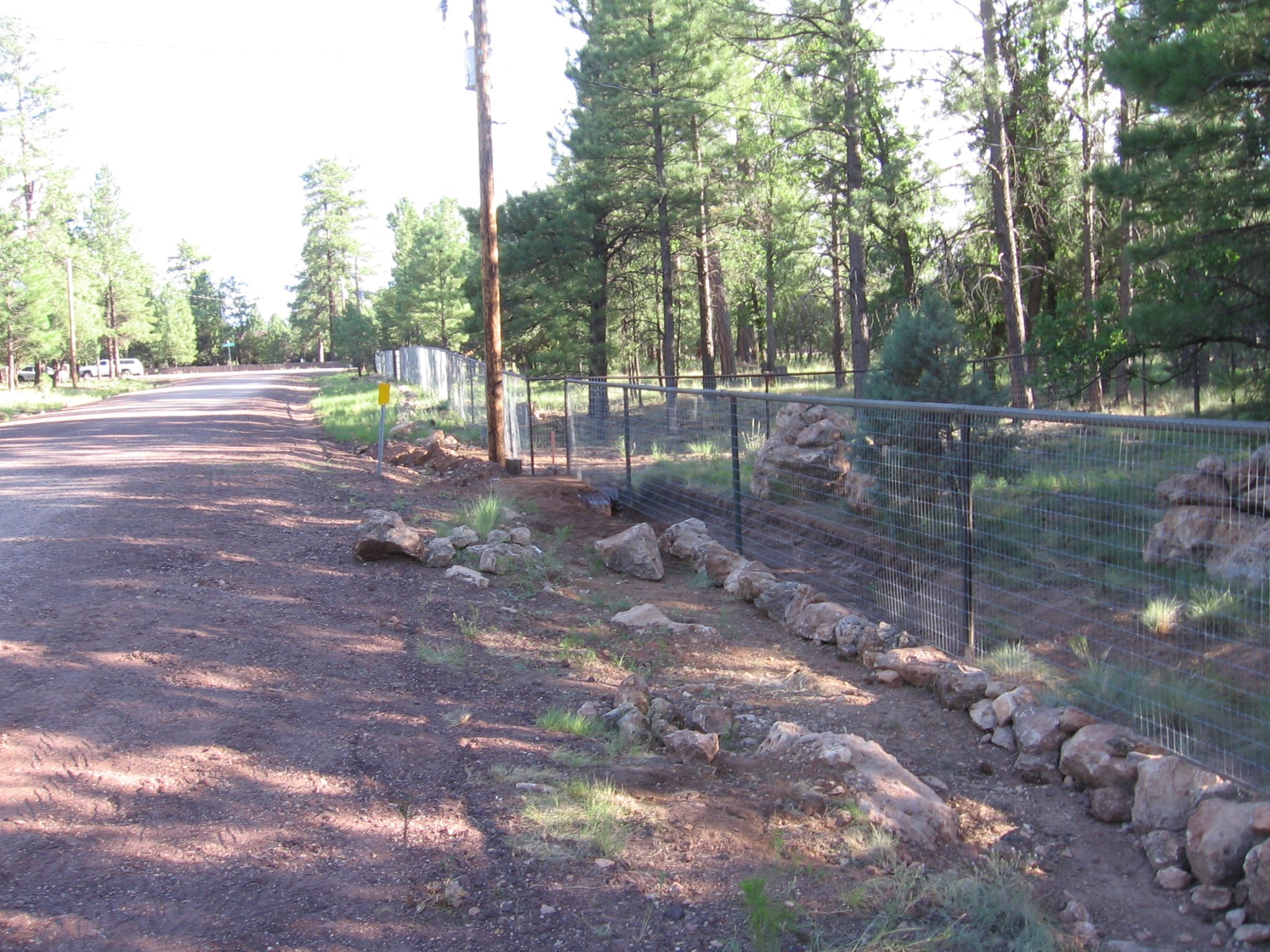

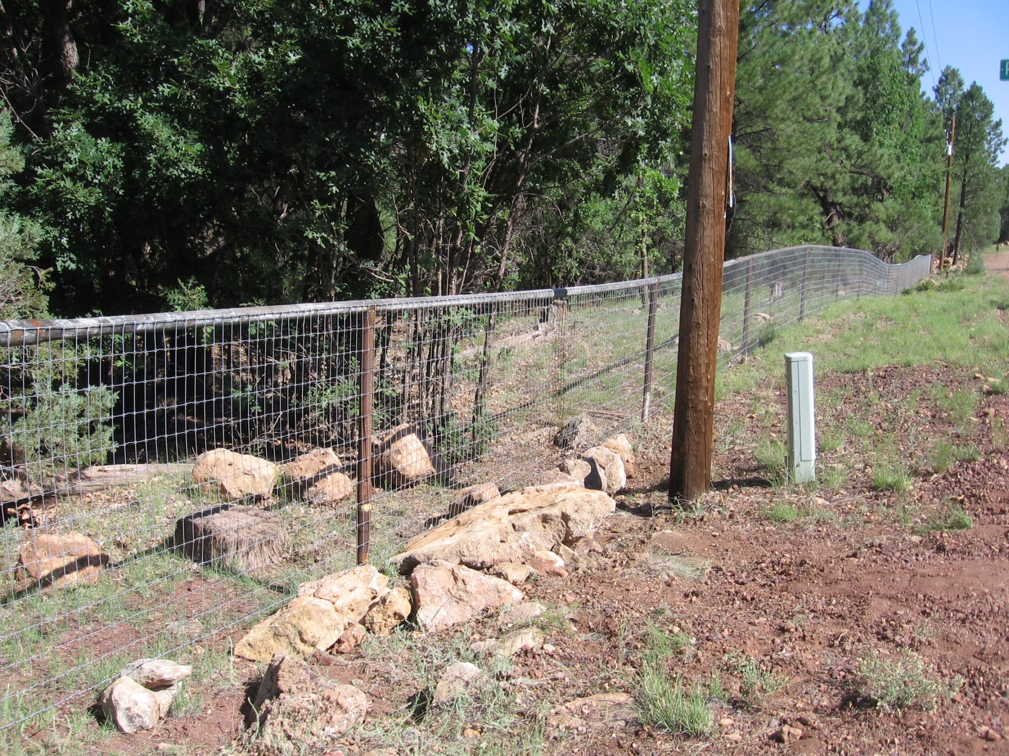

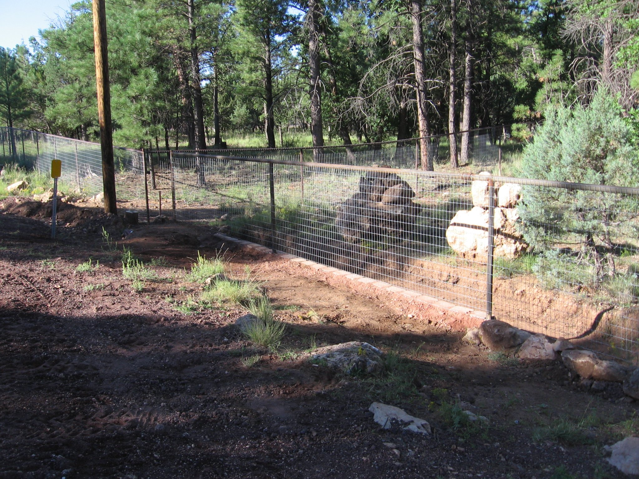

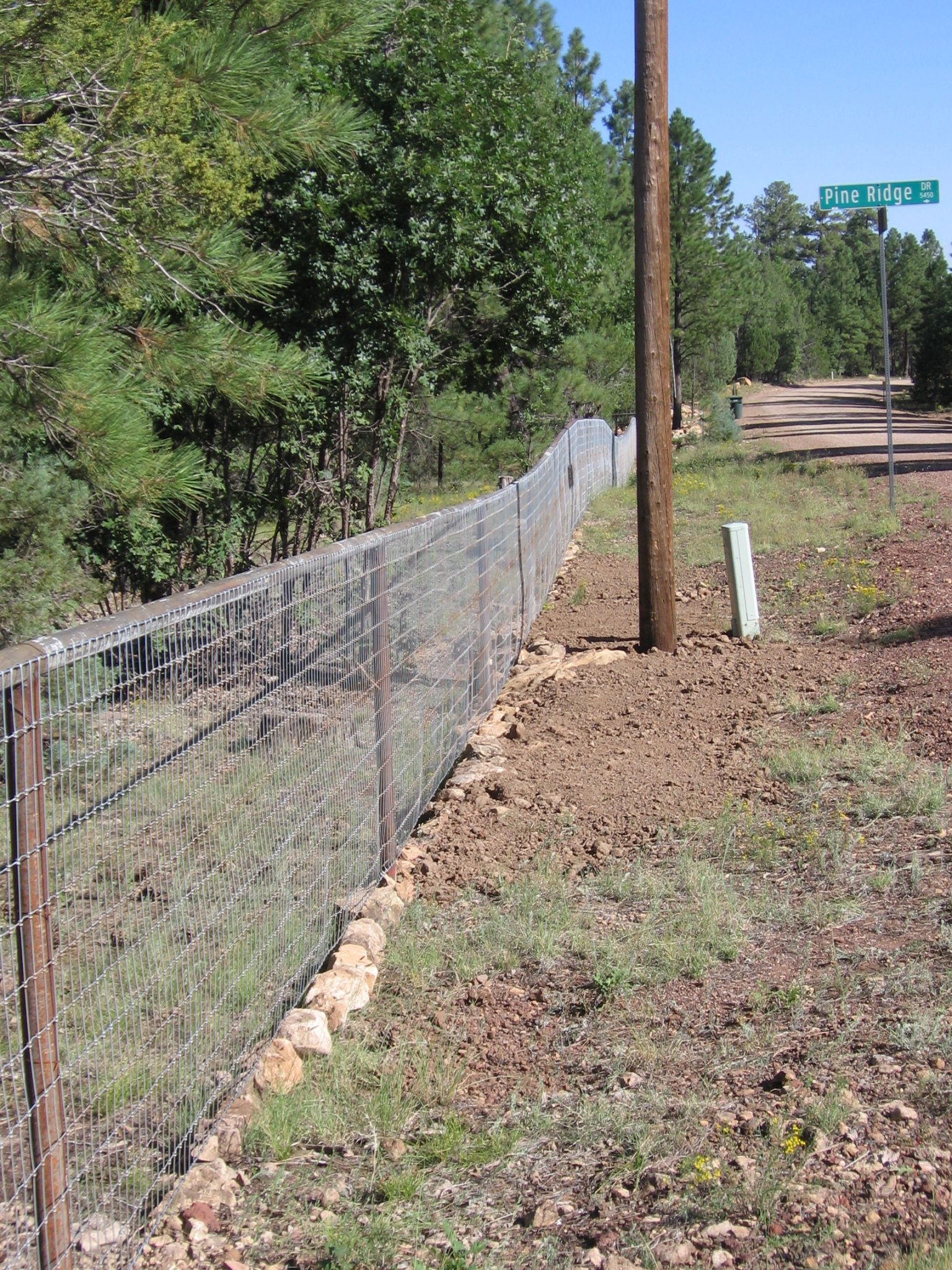

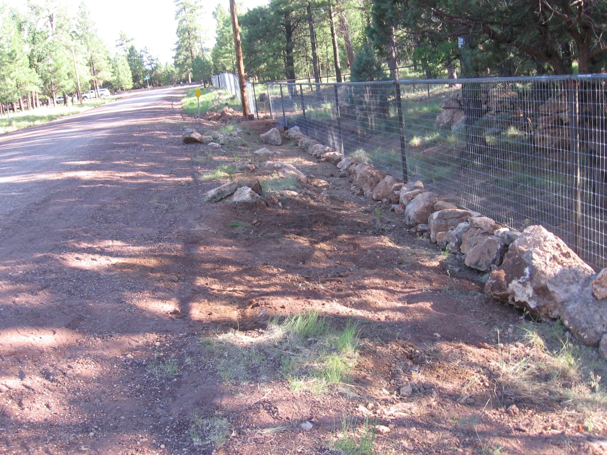

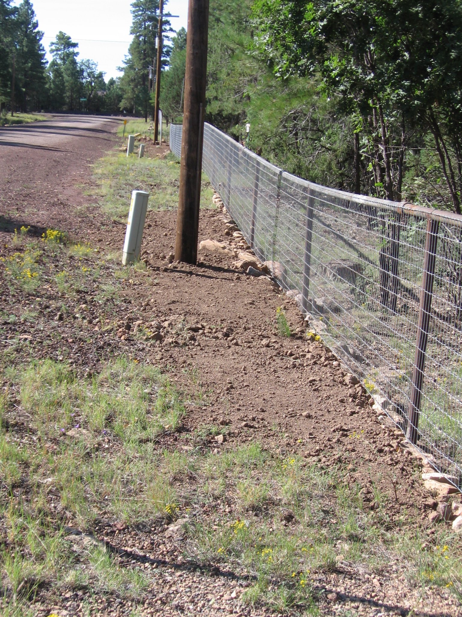

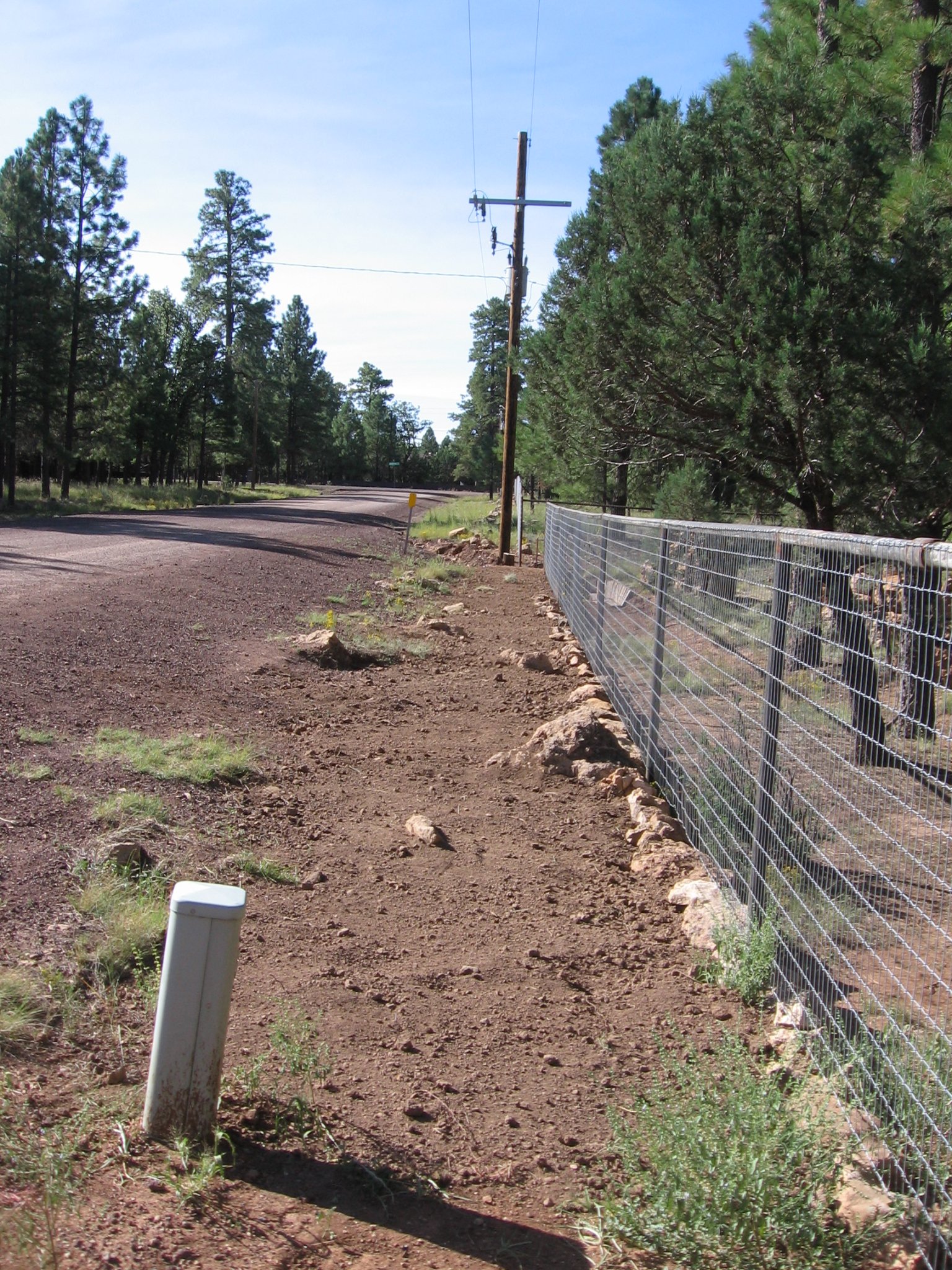

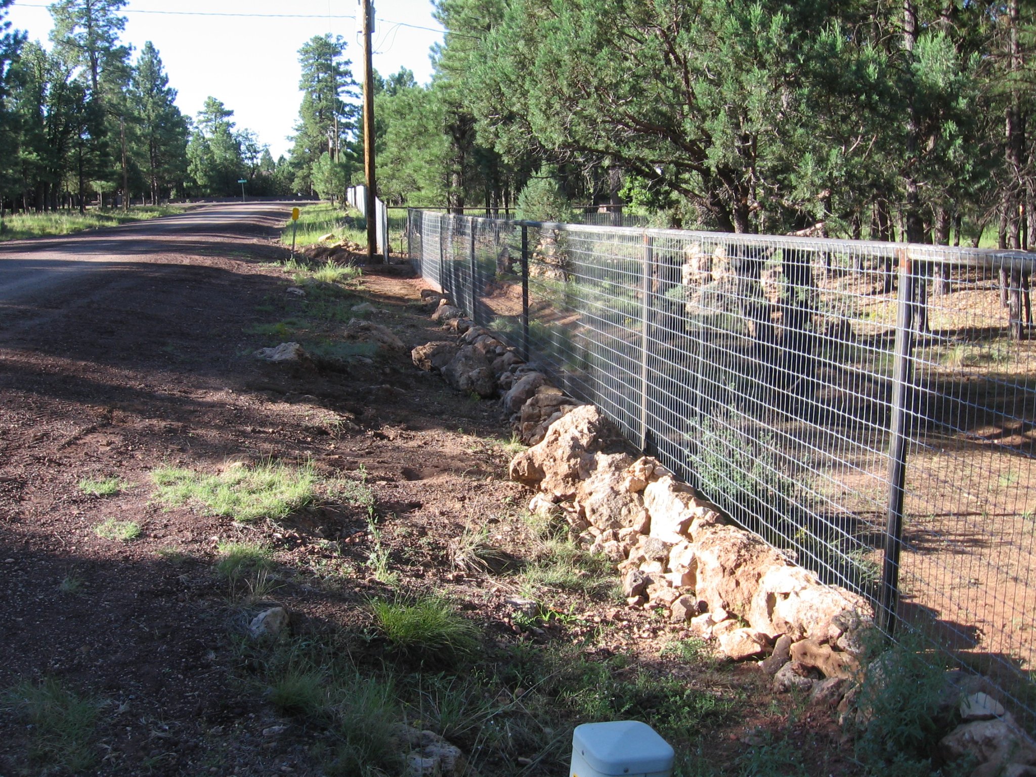

Apologies for the long post.

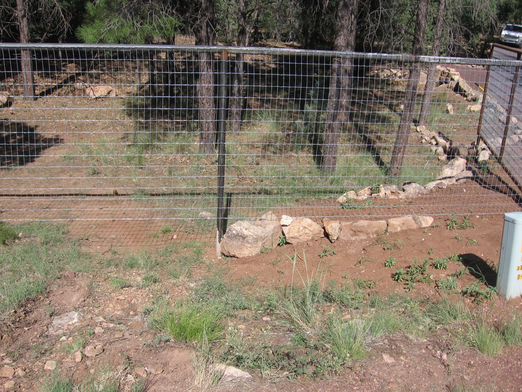

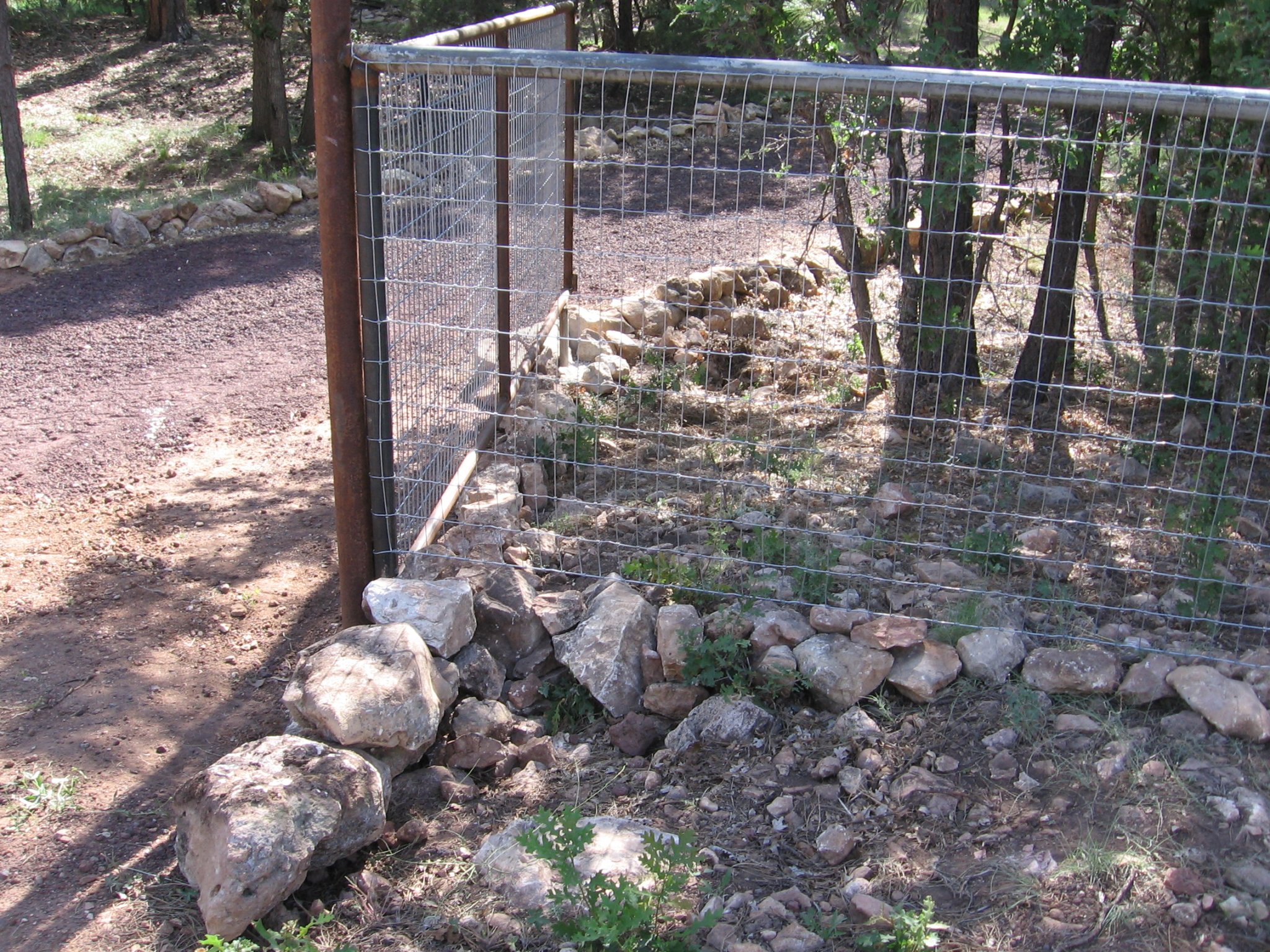

I have shelved most of my projects (notably my excavator rebuild & repair of my leaking B7100) in favor of working with my fence contractor to fence our high country property.
We had been on a waiting list for almost 3 years.
Fencing is virtually all done, just a few clean up details. 1712 linear feet, one 3ft gate, one 10ft gate, one 24ft gate.
2 3/8" heavy wall drill stem posts & top rail 100% welded, 7018 rod.
Posts set in concrete 18"dp, in 6-8" holes. (auger is 6", but it 1s so rocky they usually end up nearer 8" diameter)
Big gate posts are 4", set 3+ft dp.
4ft heavy wire no climb fabric, except for an area up front. ( see below)
We have a pretty big drop off at one end of the frontage, plus a 16" county culvert dumping on that end of the property also.
After looking at various scenarios, we extended the county culvert 7' to go under the fence, and used 5ft fabric in the low area.
This made the top of the fence even with the 4ft fence on the high side of the drive, and even with the neighbor's 5ft existing fence. (it looked terrible with short posts & 4ft fabric)
But it left a big gap under the fence fabric in the low area, which I am building up with (mostly) large rock.
When the "retaining wall" is complete, we will fill in the low area on the outside of the fence, up to the bottom of the fence, with some free local fill, aided by the fence contractor and his LARGE backhoe & a couple dump trailers.

The wife and I moved & set all the rock in the pics this past Friday, Saturday, & Sunday, but knocked off before it was done, because Monday was our anniversary.
I will rest up a few days and get back at it soon.
View attachment 133891 View attachment 133892 View attachment 133893 View attachment 133894 View attachment 133895
