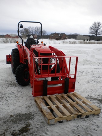

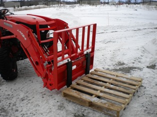

I finally got my FEL Forks back from the welding shop and all painted up Kubota Orange to match the tractor. I purchased the quick attach plate from ebay and then had my friend weld up the cross bars and the brick guard. Came out real nice.
I found the 42" forks on Craigs list and they are in pretty good condition. Looks like they used to be painted green because there are some spots that the black paint has chipped and the green is coming through. Now we can't be having any green on this forum ;) so I am thinking about having them sandblasted and then painting them Kubota gray. That would be a nice look!!
Here are some pics:

Nice job, that looks great. It also looks cold too, hope it's not a windy day.

Give the pallet a quarter turn and the forks slide in alot easier, don't have to chase it all around. Whats your visibility like tryin to stick and grab a pallet? I used to drive a 26 foot flatbed truck that had a piggyback forklift on the rear and man I could not see squat half the time. I'd have to hang off the side just to try and find the pallet, and that was with a normal forklift.

Funny you should bring up the topic of positioning the forks. I found that it did take a little getting used to, especially trying to hit the openings on the sides. If I stood up, I could see the tips, but with the seat cutoff switch I couldn't move the tractor in a standing up position.
I found two little techniques that helped after a few failed attempts. The first is to approach the skid with the FEL curled so that I could see the tips of the forks. This way as I approached the skid, I can get a fairly good alignment until I am close enough to lower the tips. The second technique I learned was to use the point where the forks attach to the frame as my visual que instead of relying on seeing the tips.
I think in the end, it is all a matter of practice!! I'm sure I will be getting more and more practice as time goes on!

I just love it when things are done right as in this case. Thomas you got a very fine machine there sir and with all the goodies to boot.
I remember last year one of the guys at a local farm was working on a machine and put the forks of the machine he was using right through the aluminum engine oil pan of the machine he was working on. I got elected to weld it back together. Worked out good though.
I guess one needs to be careful where the forks are going. Nice job Thomas.

I am really happy with the forks and now that I have used them a bit I can certainly relate to the cautionary tale you have told. I was just getting used to how far out the bucket was, and now the forks go out even further! I will hopefully not have to learn the hard way!!
