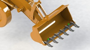

Here is a picture of a good looking model, although I would look at a model with closer forks for pine shavings.

Hmm hadn't seen anything like that before. Thanks NIW. Maybe I need something between that and a piranha tooth bar. This current stuff is flower bed decorative anti weed mulch, more like splinters than shavings, and is a once a year task at best. I am kind of creeping into this pile, so maybe the curl lift isn't making the best use of any forward momentum to keep the mulch in the bucket. I had them dump the 10yds next to the driveway, not level and on some older mulch, so there are some challenges.
. Later I will have quite a bit of digging and loading from the manure/mulch pile, but I am hoping I can get that without a toothbar. The 3560 can get a moderately full bucket from that, so we'll see how the B does.
