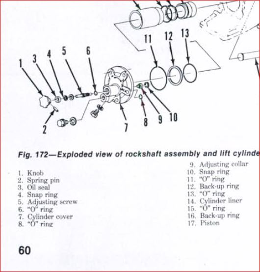

L225. Fast Slow 3pt speed knob is frozen. Any hints on best way to unfreeze it? Is there a removable something to get to the innerds to lube it? Just shoot it with an Anti seize? Or could there be a trick to using it such as 3pt must be fully down or up?

Your going to have to take it apart and free it up, likely rusted in place from lack of use.
The WSM covers that parts removal and repair.
Here is what your looking at:

I would take the plastic knob off to prevent breakage, first. then shoot some kroil, or pb blaster into the shaft. Then put the spring pin back into the control shaft. Then take a 1/2 drive socket, and grind 2 notches into it, so it fits over the shaft, and onto the spring pin, and take an electric impact gun, and alternate, forward and back, till you get some movement in the shaft. Once you get it moving a little, try to get a little more with a breaker bar, and the same socket.:D
