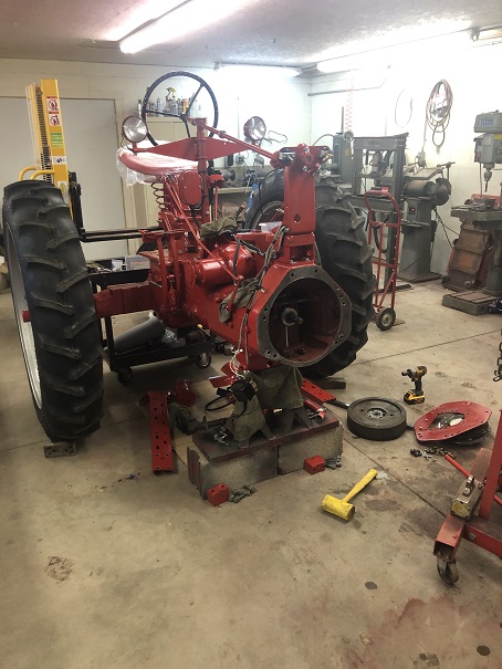

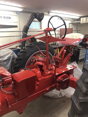

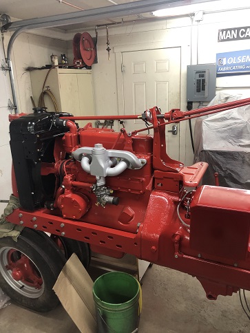

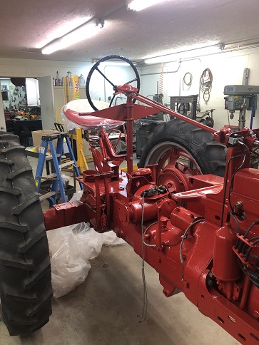

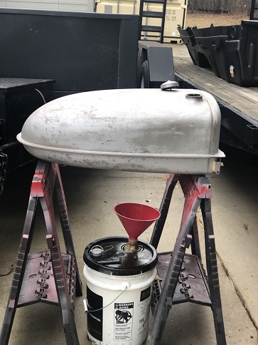

Have not updated the progress in awhile because it has been just blasting parts, repainting and assembling. Tractor is a 'roller' now . A few pictures to show the progress and today is warm enough to take the fuel tank outside and flush it out. I'm going to bring the tank and the body work to a professional to have it done right. Just don't have the stuff to do body work decent.
View attachment 145024 View attachment 145023
View attachment 145022 View attachment 145021

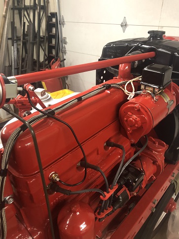

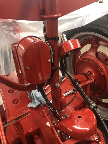

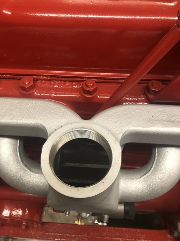

Got most of the wiring done. Getting close to firing it up but I'd like to get the muffler on when I do. Found out today the exhaust manifold is tapped 2" npt taper with 11 threads per inch instead of 11-1/2 tpi. ??? Goofed around on the lathes this afternoon but I don't have a taper attachment to do it right. Will try again tomorrow with some straight threads but I ordered a tap just in case.

Yes, this is a new manifold. Can’t remember where I got it from but I do recall going with the more expensive one for better quality. I tried threading some 2” pipe into it and it will go about half a turn. I assumed it wasn’t tapped deep enough so I tried threading some pipe on my big lathe by offsetting the tail stock for the taper and cutting the threads deeper. After two tries I suspected there was an issue and checked the thread pitch with a gauge. Absolutely 11 tpi. After fighting with the lathe all afternoon I decided to sleep on it and try again today. I suspect the manifold threads were thread milled by the looks of them. Just missed the tpi in the programming.

Looks like you got BSPT threads, British standard. Legend has it one of the colonies first act of rebellion was against British plumbing. The pipe sizes are the same, but the thread pitch and form are different.

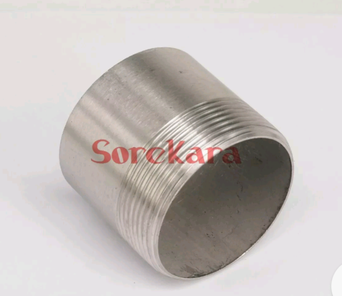

I'd get a short BSP nipple, threaded one end, and weld it onto your exhaust. This one's stainless, but you should be able to find carbon steel if that's what you want.
Bingo! You nailed it! Thanks for responding. This will make things a LOT easier! Those Brits sure know how to take something simple and make it complicated. Worked on a BSA motorcycle in my teens. Imperial, metric and Whitworth threads. Sheesh!

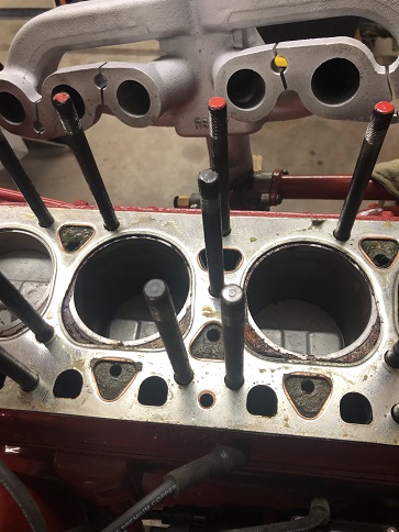

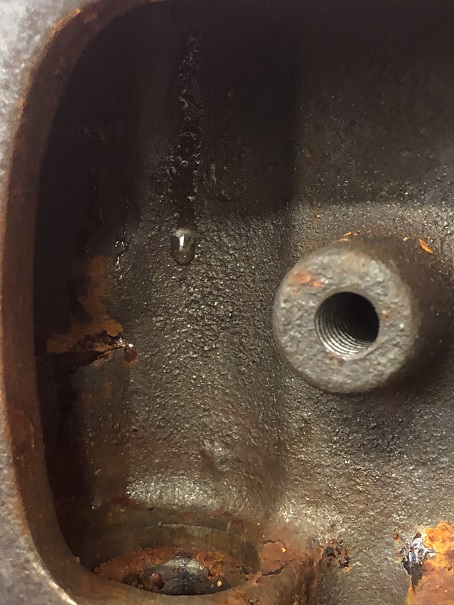

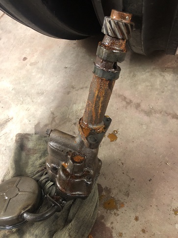

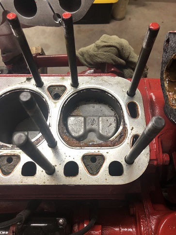

Big set back today. Getting ready to put some fire in the holes and I noticed that it cranked hard. As in too tight. Pulled the plugs to see if it was compression and no change. Put my inspection camera into the cylinders and found water in all four. Checked the oil pan and water was there too. So I pull the pan to start checking for sources and I notice it was running down the oil pump. Well that is a good clue that it is coming from the top side so I removed the head and it is absolutely the head gasket failing almost everywhere. Going to have to do some research but I am relieved it is not a cracked head or worse yet, the block. I filled it with distilled water several weeks ago after I got the radiator installed to check for leaks. All this leaking happened as a result of gravity. There was no pressure in the system.

Out will come the pistons later on this week. Will post pictures of that.

A couple of thoughts about this situation . In 20/20 hindsight I shouldn’t have used distilled water. With the lack of minerals in the water it becomes aggressive and goes after iron. And every part has been blasted setting up the perfect storm.
The manual calls out a tolerance of zero to five thousands stick out on the cylinder sleeves. I split the difference and have them at two to three thousands. I will clean up the block and remeasure but I am thinking about cutting them down to zero.

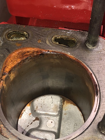

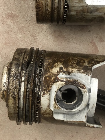

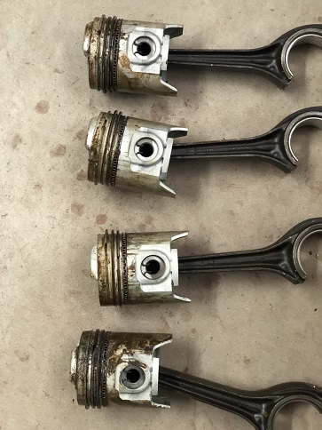

Pulled the pistons expecting an ugly mess and as you can see I was not disappointed. But they did clean up good and the rings were ok. Reinstalled them after lightly honing the sleeves. Also put some Devcon epoxy where there was pitting by the water passage holes. Kick myself now for not having the block decked when it was out.

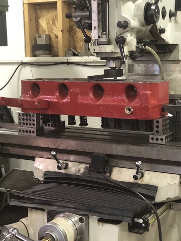

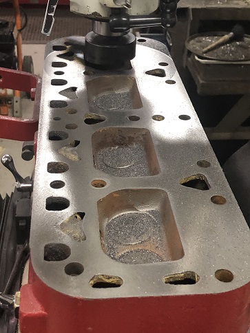

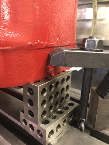

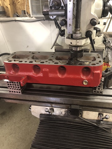

Decided to run a fly cutter over the head and clean it up. Five degrees Fahrenheit for a high today so it is a good day to watch the table slowly move from right to left. The challenge was to get it clamped to the table. Best I could come up with was the water inlet and a pipe plug on the other side with blocks to raise it above the valves. I used paper to shim it level.

Since it was so lightly clamped, I only took .004" per pass but it did clean up at .020". Sprayed the new gasket I ordered through the Case IH dealer with Permatex copper and started reassembly.

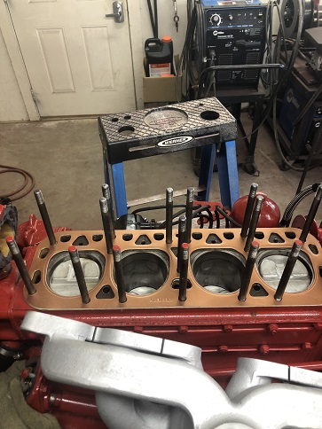

Reassembled the head and wisely left the pan off. Pressurized the system and noticed some drops coming from underneath. After spotting the source with my camera, which of course was coming from the head gasket, I pulled the lifter cover plate and confirmed.
Soooo...
At the engine shop to get decked.

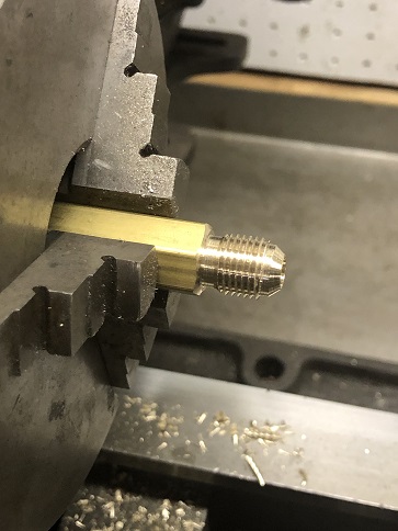

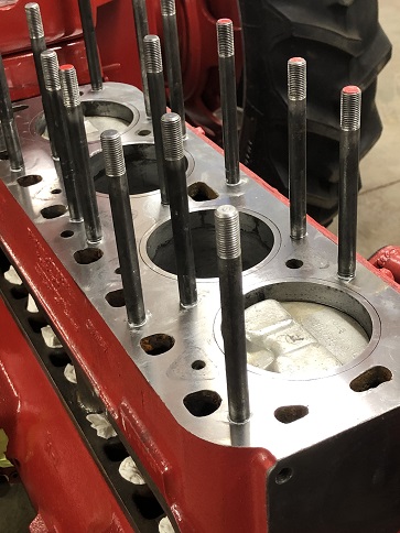

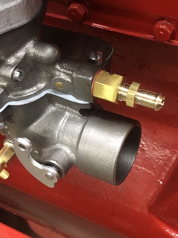

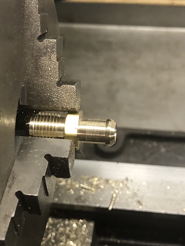

Engine block decked, assembled on tractor and pressure checked. Thumbs up! Installed the fuel tank and I want to run an inline filter as some extra insurance until I run a tank or so through it. In order to do this, I made up some adapters to go from compression to 3/8" hose. Fun project on my little lathe using 9/16" brass hex stock. I'll eventually bend a steel line to be more like original.
