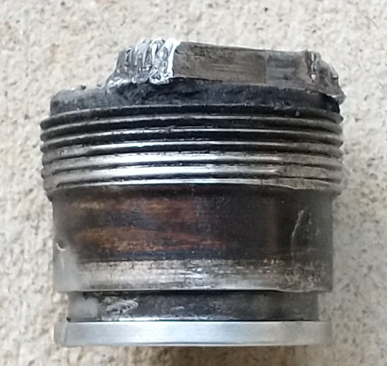

Heya gang, this is my first post after gleaning much helpful info, last of which was locating a rebuild kit for a denso starter solenoid as the kubota site/parts list lacks any detail in that regard. There are no part numbers - only viable fix thru kubota is an expensive starter replacement instead of an 18 buck kit.
The current experience.
I have an LA680 FEL with the 'discontinued' cylinders. The newer versions have a thicker head.
IOW, I suspect they may have had an issue with the assembly process at the factory where the mechanized assembly just used pressure and high speed to drive the gland nuts home regardless if they were started correctly or not.
Given where the threads are damaged, I suspect that was the problem - they are stripped right at the start then 'right' themselves as it was driven home, very soft material could behave that way. Steel nuts would have locked up.
You can see from the condition of the nut every method was used to try and free it, but the aluminum is so crumbly it could not withstand the force applied, even after heating. Used a gland nut wrench, pipe wrench, vice, punch, even tried to put flats on it so a 2 ft adjustable would have some bite, but no joy. The amount of the nut that protrudes from the cylinder doesn't give you many non destructive options.
A failed attempt to melt the aluminum nut out fell short as I'm out at a friend's where the tractor is, without the tools I have at home.
The next day I was going to attempt to drill it out. I needed room to fit a drill so tugged on the eye. It was very stuck.
Grabbed a breaker bar and tried to turn the eye to break it loose, but the nut started to turn - just a little. So got some ATF and worked that into the new gap while working the shaft (now a 'tool') back and forth, and got the nut out. Let me tell you it was tight, and thankfully the o-rings fused to the shaft held up, and the seal at the mouth of the cylinder was absent from the heating so ATF got in.
So a 25 buck/1 hr job turned into a 260 buck one over 3 days trying to figure out a fix, then 4 day wait for new nut (my kubota dealers in NC suck - had to order it online). The threads in the cylinder were fine and accepted the new nut happily.
The second cylinder had also just started to give up the ghost and was leaking a little, but not as bad as the first.
I though 'what are the chances the second cylinder is fubarred'??
Well, I should buy a lottery ticket.
This job started the same way. Before the nut was totally destroyed, I used heat and will let it sit overnight and see if the story repeats itself.
Is there anything I missed trying??
Has anyone else seen this before??

Scratching my head on the gland nut. I would say galling or not machined correctly but you say the new ones thread right in. Sometimes the mystery never gets solved
Exactly.
Weird, isn't it?
The only thing i could conclude is what i included in my first post.
The only other times you see a condition like that is when part of the bolt goes thru a boss and then into a nut or threaded part. In most cases both pieces are damaged, unless like here, one piece is soft.
The thread engagement here was full. It was cross threaded then the softer metal eventually caught up and synced with the threads. Part of the effect may be traceable to the thread profile.
All i know for sure is that they discontinued the design and went to a thicker nut with more material extending from the cylinder (and who knows what else they changed - I have not seen any replacements yet).

I have seen glands like that before. I cannot say whether they were "cross threaded" or if they were simply just galled from removal. Nonetheless, they're a pain! Some of the old ones were NLA, so we had to hire a machine shop to make a new one from scratch. Not a particularly hard job to do, takes longer to measure everything out and such Typically if I had 2 of them made, they hit me with about $450 at the time. Mind you, we had to make a little too, so we'd sell them at $300 ea. People might throw a fit but what's the other option? I knew of none. Of course now that I have my own shop, I could probably spin one out in a few hours' time on my own lathe. Manual, not CNC, but you get the idea. That little lathe is a tool I wish I'd have gotten decades ago! Reminds me i need to make some bushings for my push mower this weekend since Deere no longer supports that mower. But it's over 30 years old so I can't blame em.

UPDATE: after lots of heat, gland nut started to move the next morning using the shaft as a removal tool with a breaker bar in the eye. It was stuck to the shaft pretty good.
It was too hot out and had other stuff to move to gas out on getting the nut out, then spending 230 bucks for a new nut.
I ordered replacement cylinders from Magister and the adapters from Surplus Center.
Done.
Thanks all for the advice!!

Yes sadly it was just a bad gland nut design, hence the reason for the parts change.

You should be able to get a gland nut out without destroying it to replace the seals. Otherwise, make it an unserviceable part.
If the tractor was still young and the seals on the cylinder went out, the problem with the gland nuts would still be present.

I have never seen one of these cylinders but based on the discussion I think it's safe to say it was a crappy design.
I think its also safe to assume Kubota had little to do with the cylinder design outside of some generic specifications like mounting geometry and load ratings. They shopped that specification around to cylinder OEMs and awarded a contract to one of the bidders who did thev detailed design and production.
The bad news - it is now a discontinued part that can't be cost-effectively rebuilt.
The good news - it's a generic part for which there inexpensive and readily available new OTS substitutes. Someone here gave you a link to one and hopefully it's a simple and quick swap. 😇
