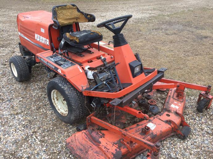

I recently picked up an F2000 that someone had removed a few parts off of and then left behind after selling the property. New owner called me to clean out the yard so now Im trying to bring this mower back to life, as of yesterday I have it running and driving, and all the hydraulics are working. One lift arm for the deck needs some repair so the deck isnt on yet, some safety switches are not working or possibly missing.

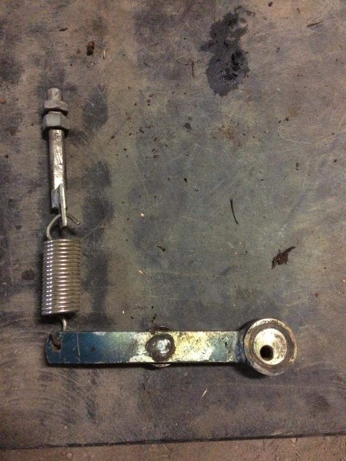

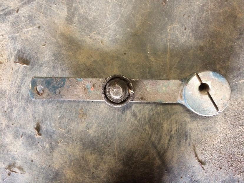

I have an extra part Im trying to figure out so hoping maybe someone here recognizes it.....
14,365
6,631
I can't help you with the part Lance, but you have a nice machine there since you got it running. It's a D950 engine with hydrostat transmission, and you have them both working! Nice save.

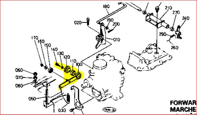

That looks to be the HST centering linkage.
If you want to see the whole setup go to kubotabooks.com and download the B7100HST manual, it will be the same setup. ;)
