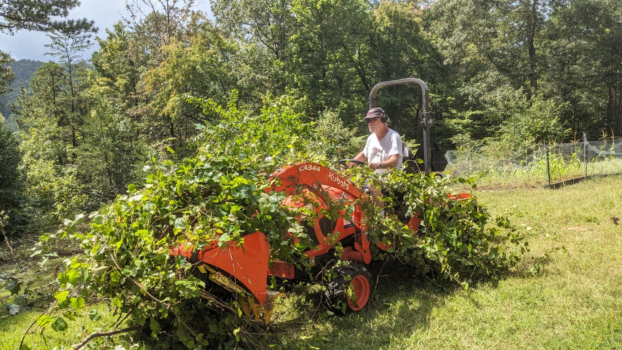

When we moved up here, I bought a new BX-2680. Over time, I added a load of toys with the disc-harrow being the most recent. I have been blasting through the brush like an Abrams tank in the hedgerows and that seems to be working. I am chipping the brush with a DR Leaf Vacuum/Chipper. I started burning it, but the smoke kept going straight over to our honeybee colonies, so I am looking for another way to dispose the brush. Plus, we have heard that the wood chips are great for soil amendment.

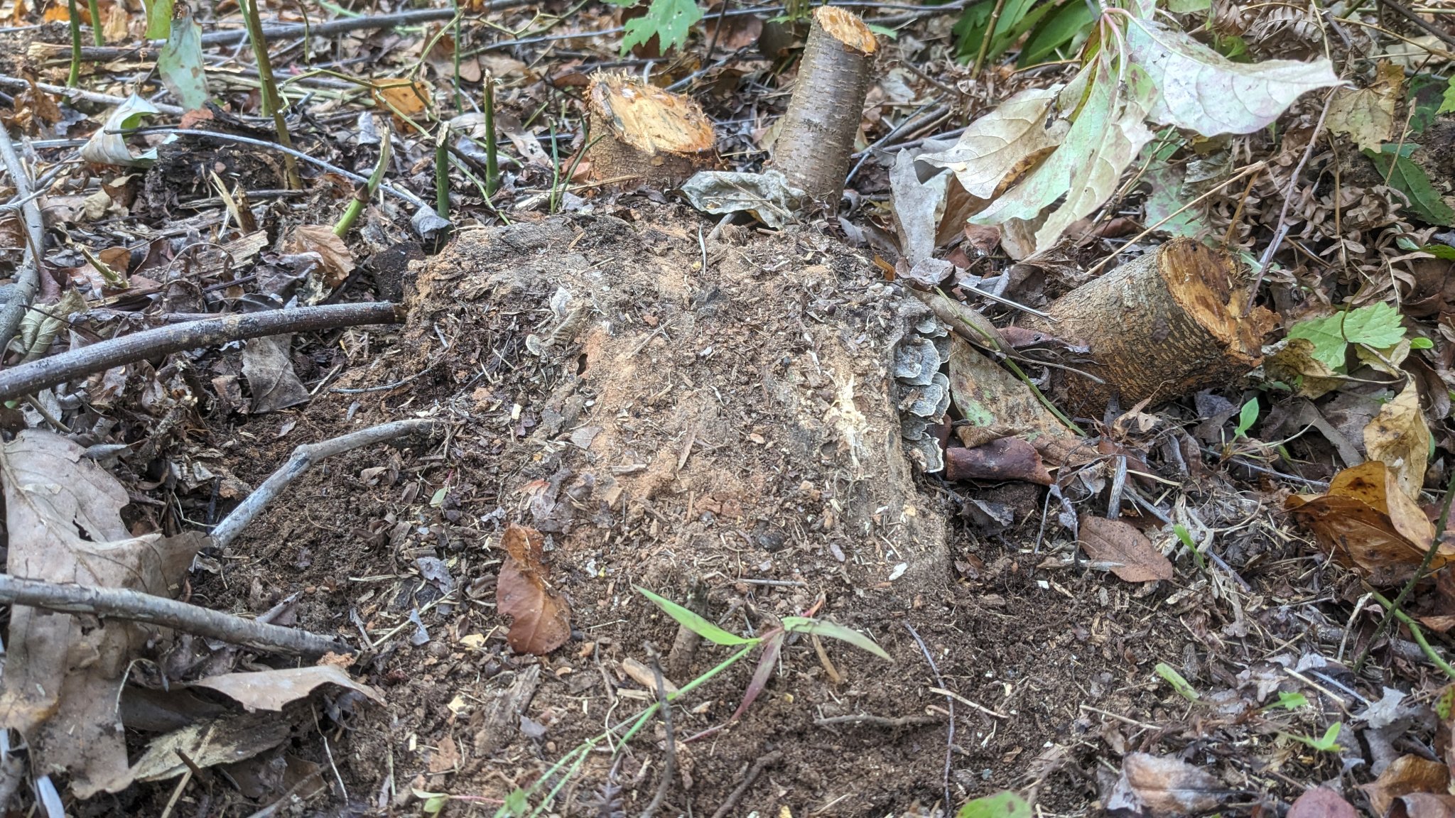

While clearing the brush, I discovered that I am repeating a task that has been done before. All the saplings have been growing out of large stumps. So, after dragging you through all the above, here is the question: what best to do with the stumps?
There must be 50 of these in about one acre. I have one of those pointy stump buckets and I have tried ramming and jerking but they are anchored pretty well. I have ripped the tops with the chainsaw and have split them with an axe, but progress is slow and draining. Because of the slope I am limited to the angels I can attack the stumps because I fear tipping.
I saw on YouTube about adding Epson salts to the surface and I guess it is supposed to accelerate decay or something. I would prefer to remove them but would accept making them flush but that creates future sink holes and I have a lot of them already due to rotted trunks collapsing.

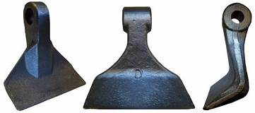

Give up the idea of a cow and get a few goats! Or a flail mower with the heavy hammer flails.

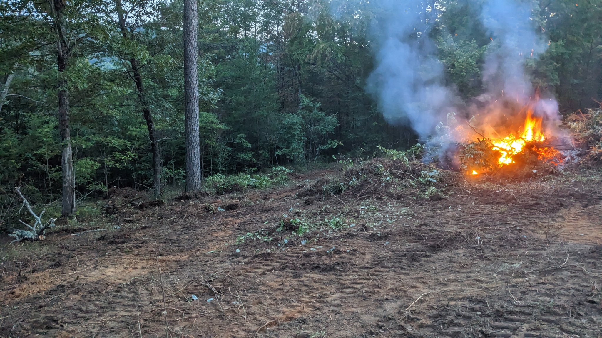

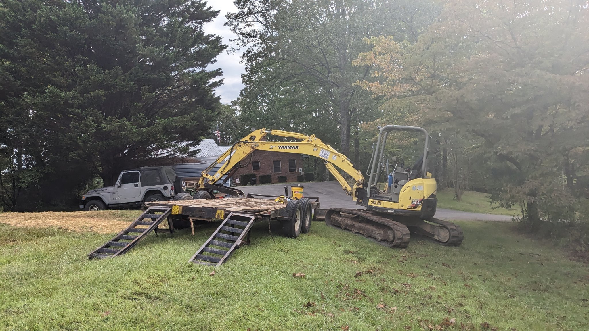

You guys talked me into doing it the right way.
The young man that serviced my tractor cut me a good deal on renting his excavator. He spent about 20 minutes teaching me and let me loose.
I did in one day what would have taken me months, if ever, on the BX.

NICE.....
you chose the 'work smarter, not harder' option !
Just look at all the 'free' time you now have ,to do the 99 other things on the 'list'....
When you're done, be sure to clean the dirt off the machine and you be able to rent it again.
No. No, No. He was supposed to do the work for you 😒
