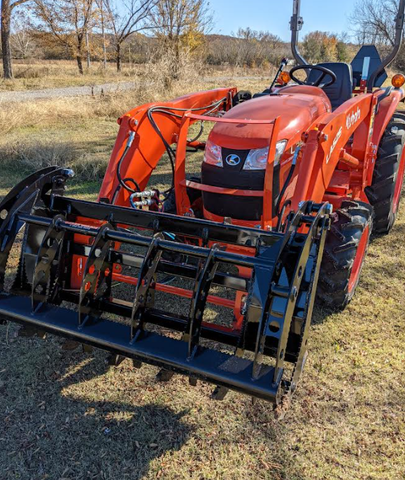

Time to do some work. How do you guys store these things? I unloaded it and moved it up against a tree with my forks to get it on the tractor.

Congratulations on the new grapple! :)

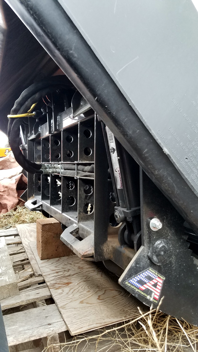

I keep my Wicked 60 on a pallet with a block of wood in the center to keep it upright. I have it under a plastic sled to keep the weather off it. I'll eventually make a stand for it but the block works for now.

Very nice! I’m getting closer, Cole told me today I am #27 of 236 to be built. I was #145 on 8/6.
I stored my 55, when it rarely came off, completely open and face down.

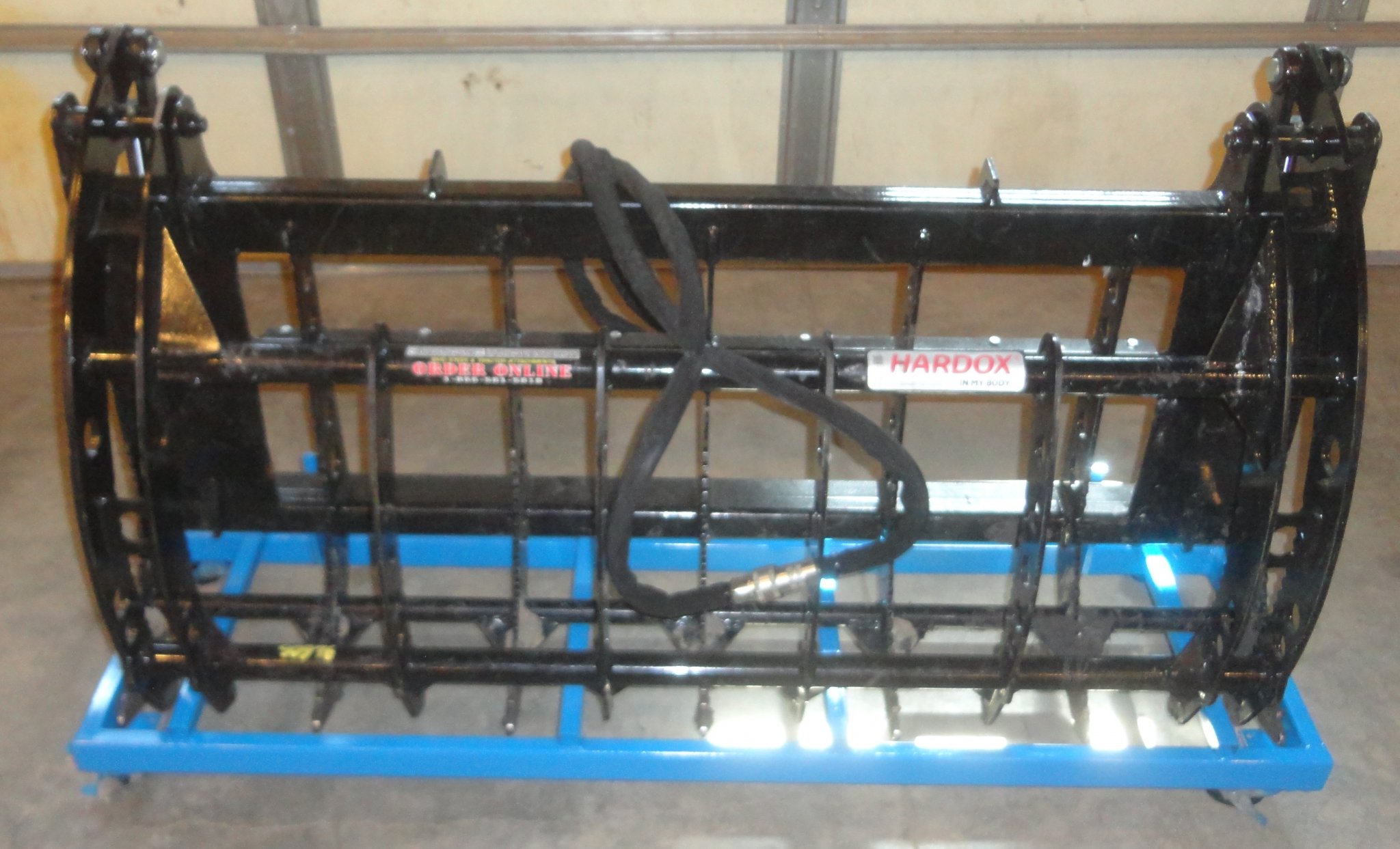

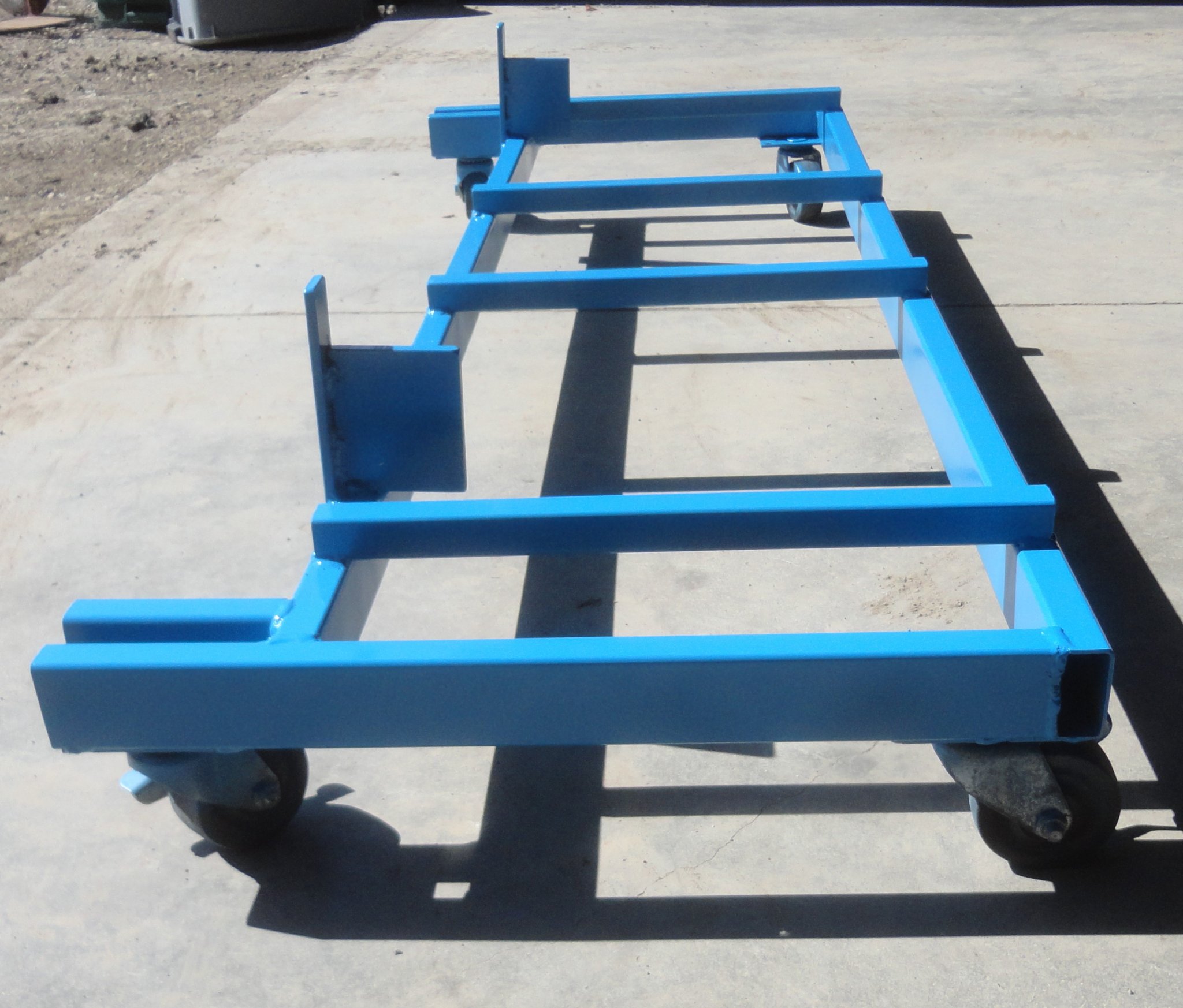

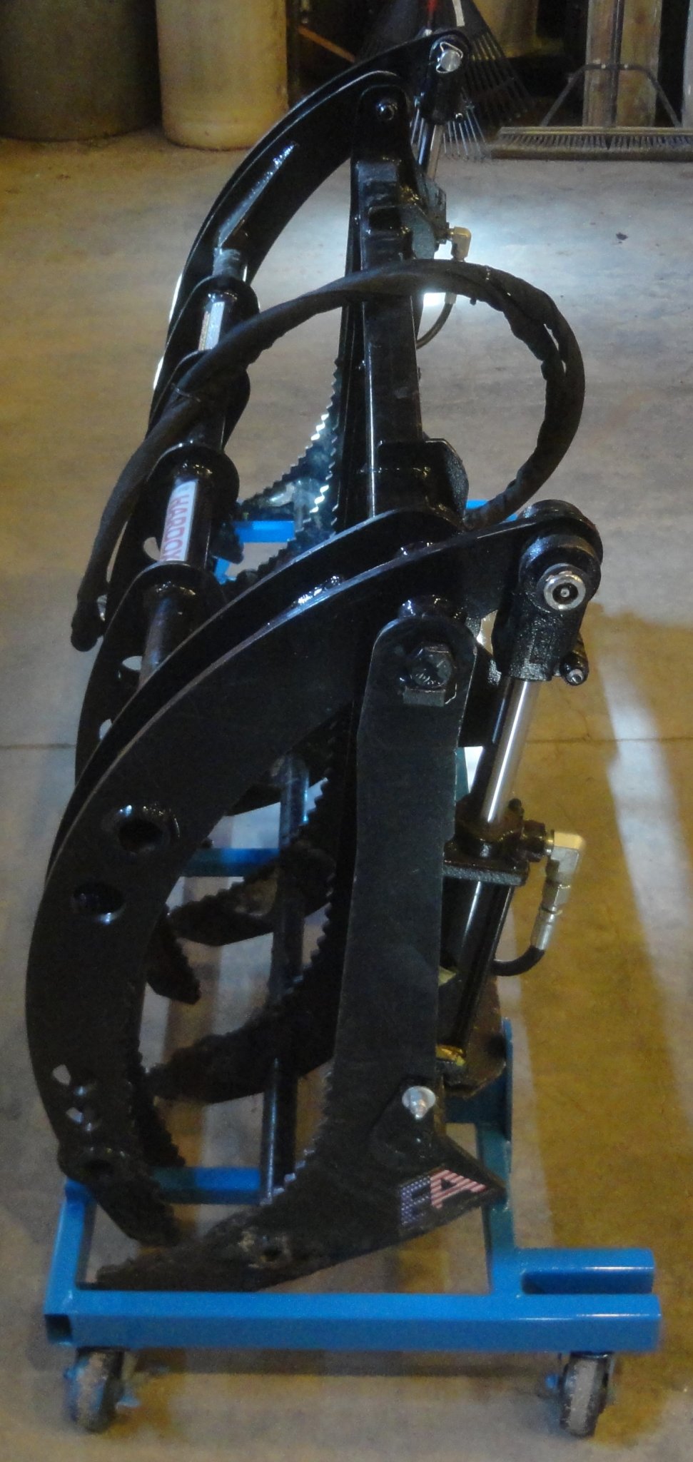

That's outstanding @bird dogger. Excellent idea and work. Now you've got me thinking. I was going to make a simple kick stand for mine but I like your dolly idea better.

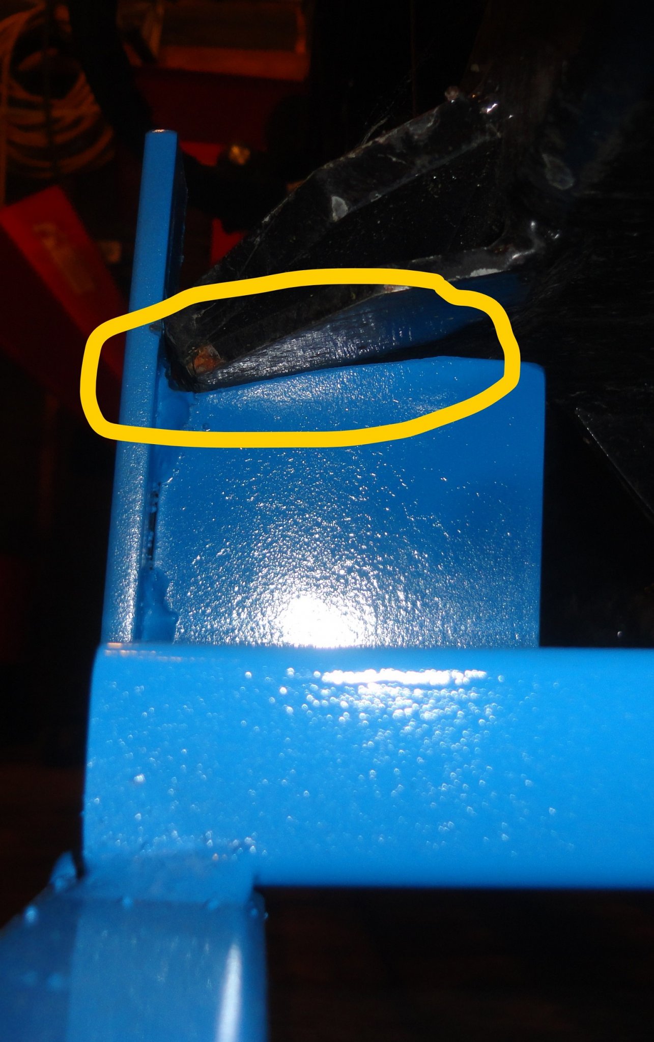

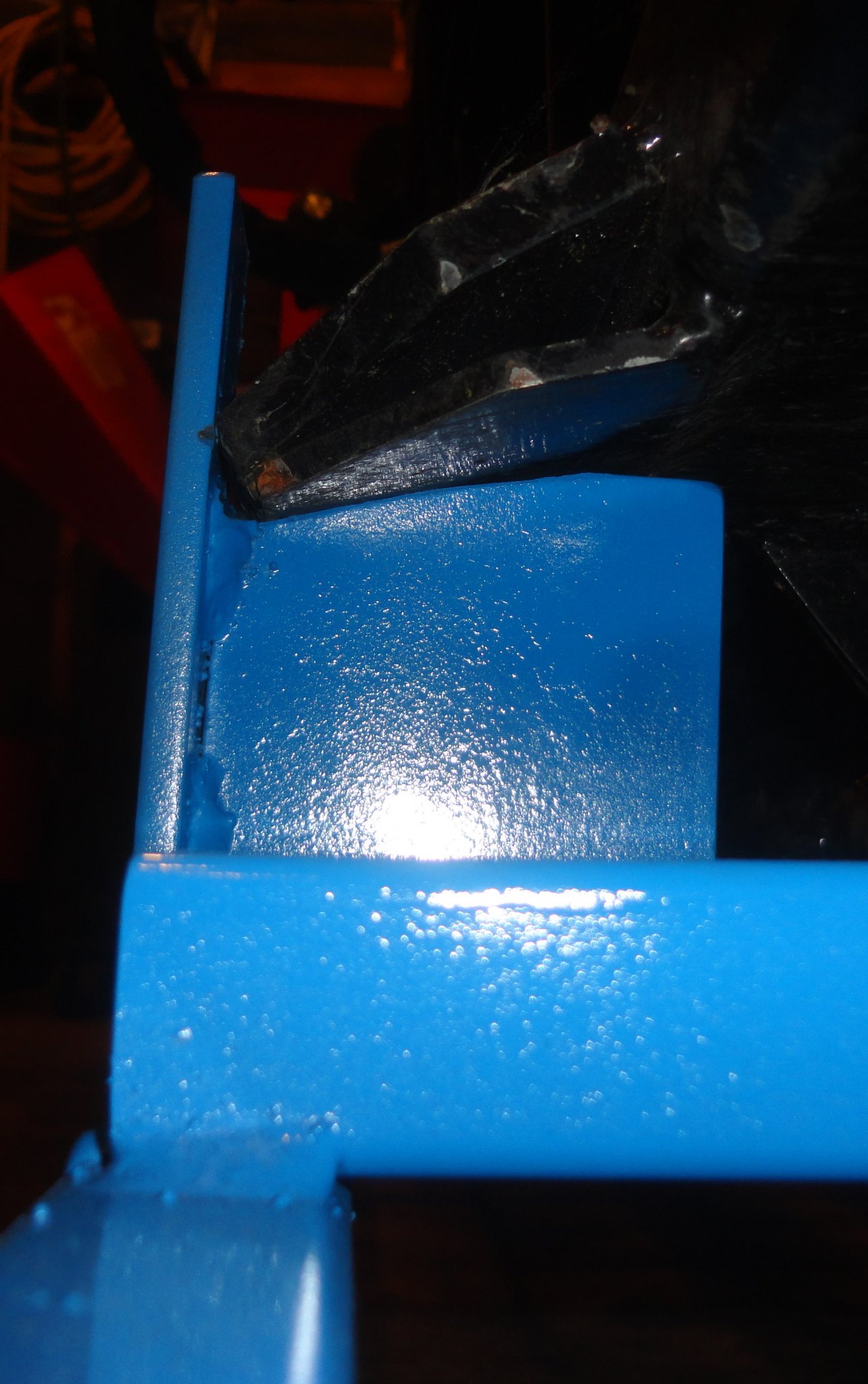

Thanks for the compliment!! It really works great and rolls around easily with just a little push. I did make a little change that I forgot to show in the post above. the grapple was just a little tippy as it sat to upright. A good tug forward could've caused it to tip forward. My simple solution: A cut off grinder to cut the back "rest" at a slight angle so the grapple tilted more rearward while on the dolly. Problem solved.
That dolly looks great. Unfortunately I do not have the skill or experience when it comes to welding. I bet you could make a lot selling those things.
I put a few hours on the grapple today, got it nice and scratched, along with the tractor. It is built like a tank.
Thanks, DDCD!! I'd happily weld one up for you. But shipping might make it prohibitive. If you were interested at all, though, I could weigh the thing and you could judge things from there. I'm guessing it weighs somewhere in that 30 lbs range +/-.

Good stuff. I made a cart for my Kubota generator and have all the material needed to make another cart for the Jon Dow fuel tank but it looks like I have a third dolly/cart to make now.

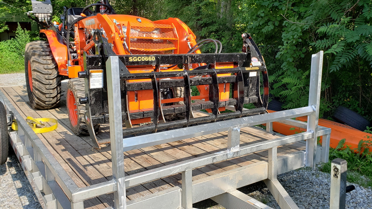

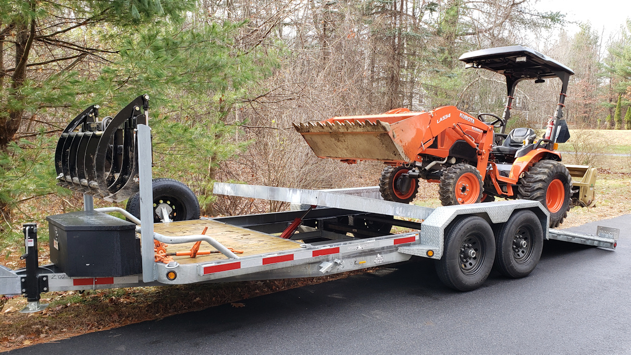

I hated the way it flopped around on the ground so I built a mount into the front of my trailer for it. It is always with me and never in the way.

I'd like to see more pics please. How it mounts to the trailer etc.👍

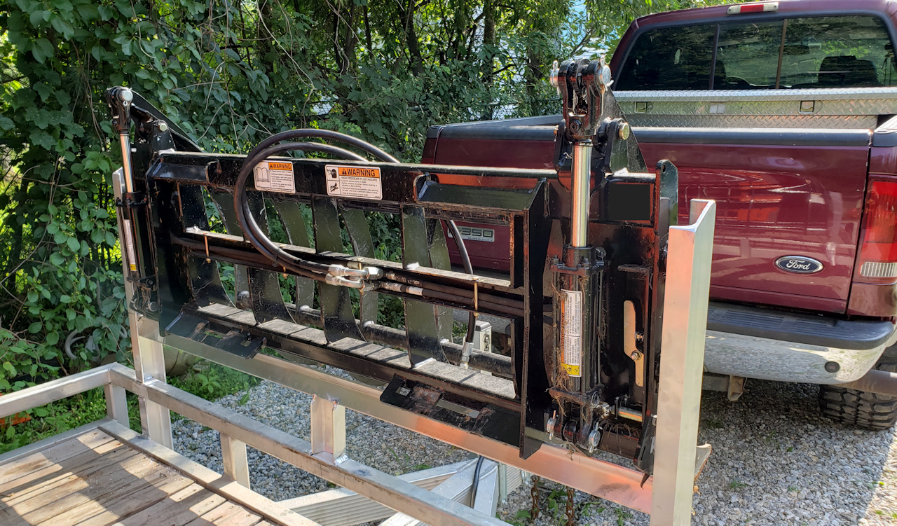

I don't have the setup photographed on the new trailer but I do have shots of the original.
Super easy to do. A couple 3" channel uprights and I welded 4 pieces of 2in round stock to the side of the grapple to slide into the channels.
I have the tops of the channel drilled (not shown on old one) and 1/2in locking pins in there so it can't be easily removed.

Thanks for the pics dog. Looks like you welded 4 pieces of round pipe on the 2 sides and then the pipe slides down in the 2 vertical channels. Then the bottom teeth rest on the cross member. Is that right?
Hot damn! I love it!

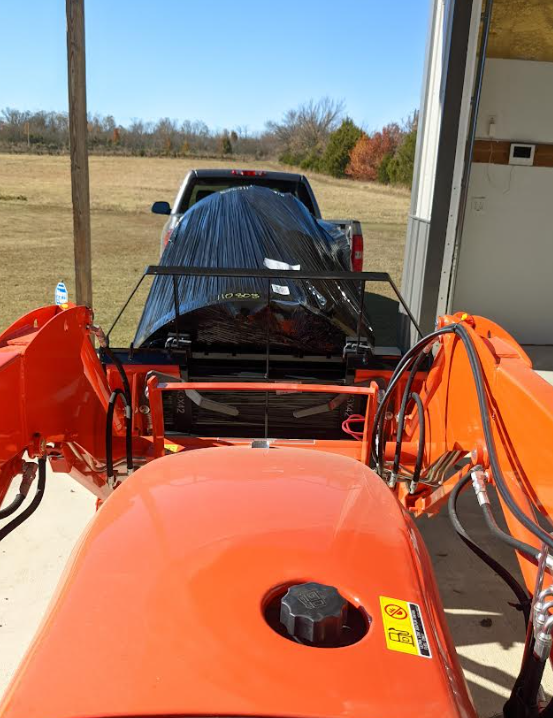

Just got the phone call. My grapple is at the terminal! Going to pick it up this afternoon.
Glad I got the 3rd function finished up last week!
Ordered 5/25. Almost 6 months to the day.

It’s on my property! Still in the truck, but it’s here.
It got dark on me and the wife has dinner ready. It can wait till tomorrow.
