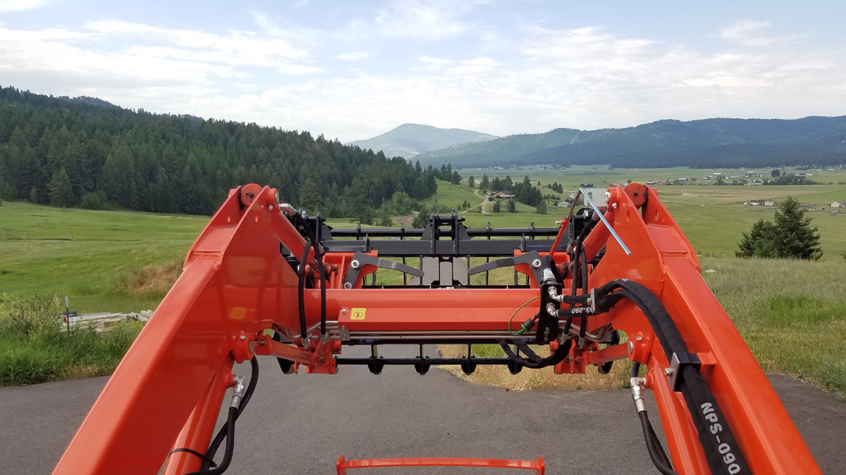

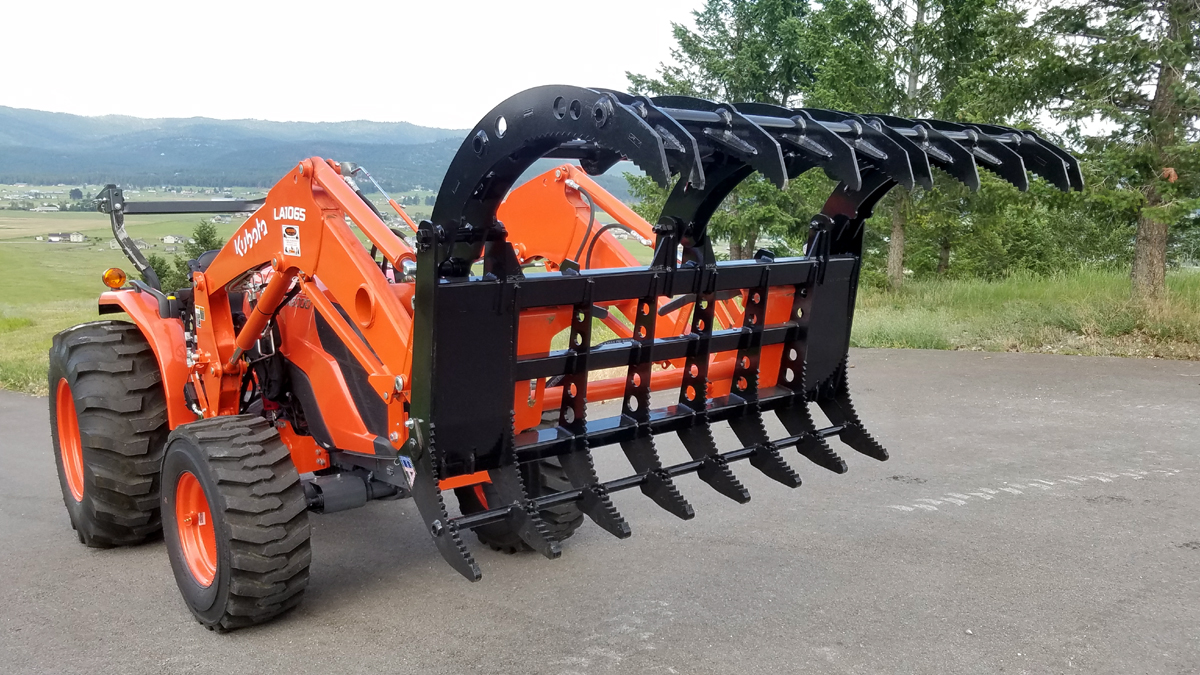

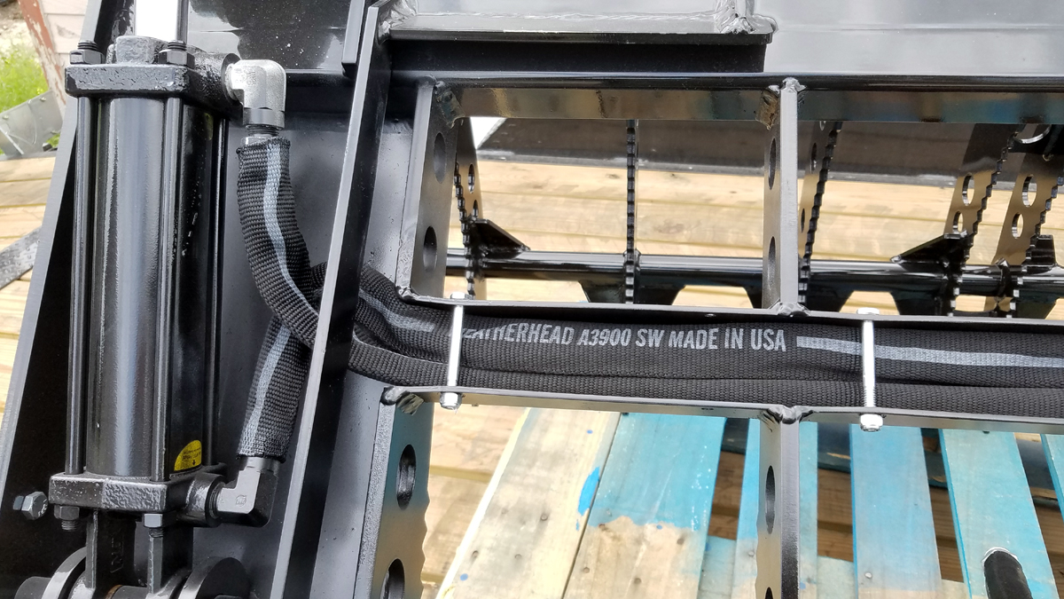

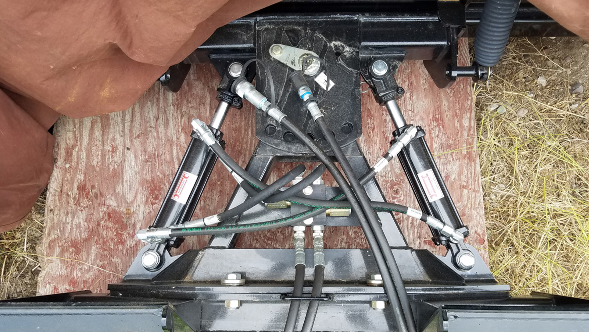

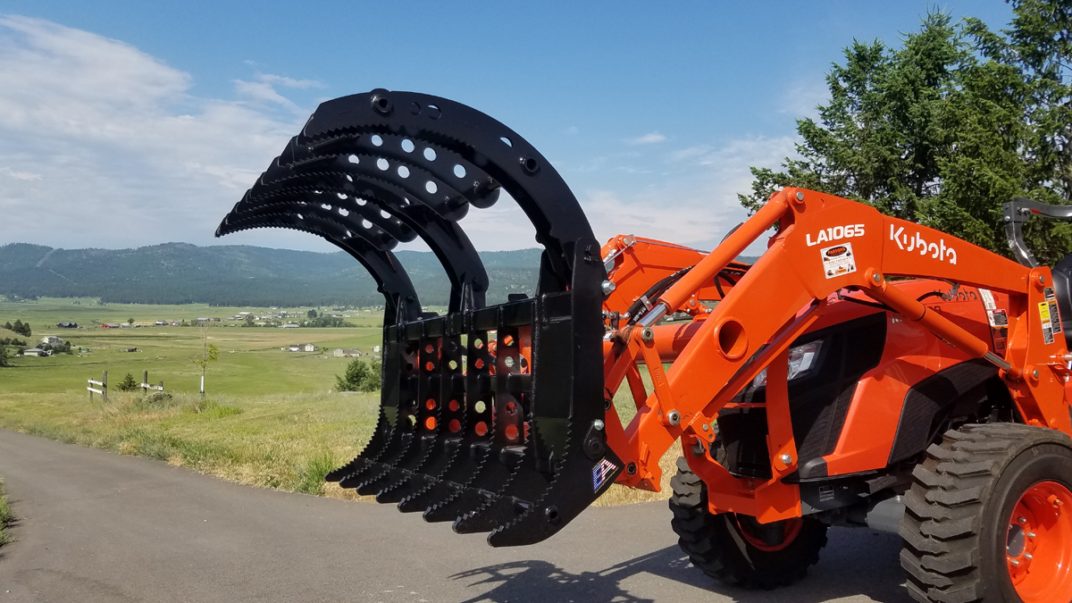

I finished up modifying the Wicked 60 hoses by adding nylon sleeves and despite a bit of a cluster getting it off the trailer and onto the MX I was able to verify fit and function. The grapple looks to be dead straight as far as I can tell and it's FAST. By that I mean the lid operation is fast, and way faster than the LP grapple lid was on my BX. I also cut down three of the six bolts that secure the hoses in the c-channel. For some reason three were longer than needed i.e. mismatched.

That’s a good job!
I notice the grapple is constructed using less-expensive externally-bolted cylinders.

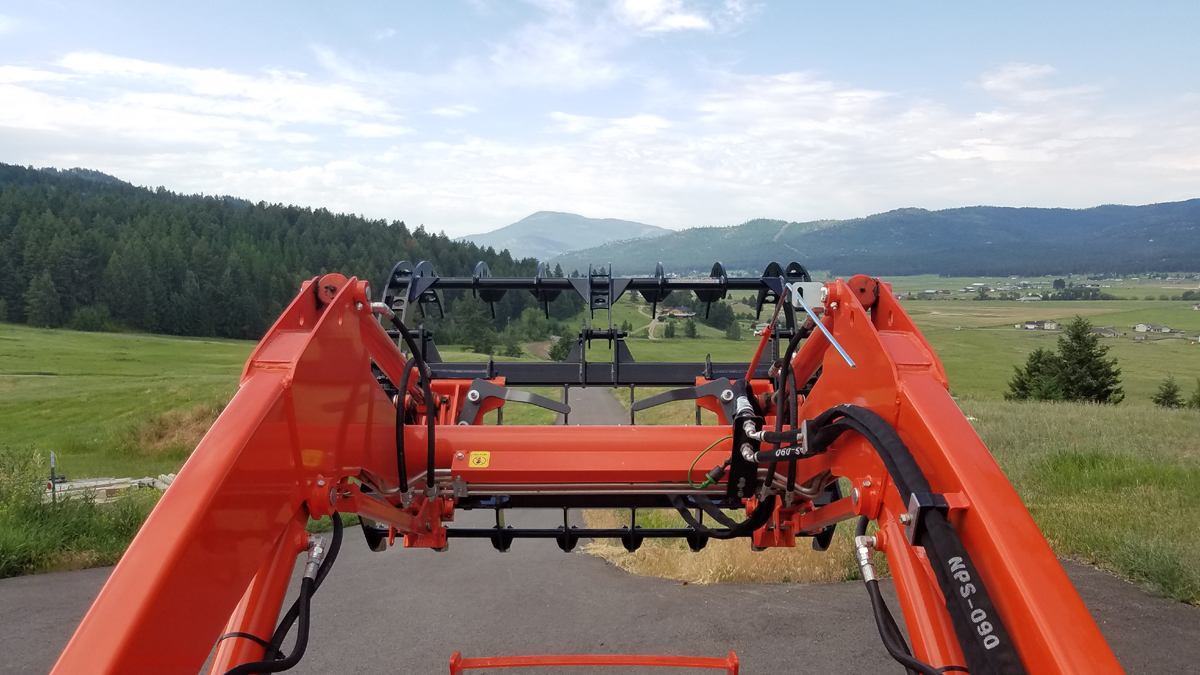

Here are veiws of the lid as photographed from the operator's seat. It looks to be very straight to me.
6,331
3,679
I have a difficult time looking at your grapple with that beautiful horizon out there…. :love:
Yep…that does look like it should.

Here are a few more photos. I'm pleased with the grapple now and will put it to good use. My experience although mostly positive doesn't let EA off the hook. If they're a good company they'll fix what's not right and go above and beyond for the customer. Eliminating sharp edges which cut hoses, replacing the entire grapple or sending a new lid to @MidwestGuy and sending me a couple of replacement hoses would be a good start.

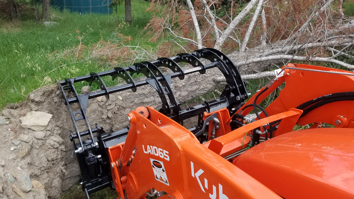

Last photos from me ... I promise! 😂 I guess every piece of equipment has its limitations. I have four trees like this that are down but it looks like I'll have to cut them into smaller chunks before I can drag them to the barn to process into firewood.

Thanks. Can you elaborate on this. I don't see the current arrangement as being a problem. I was actually impressed by the grease fitting system for the top of ram where it connects to the lid. Also, the DOM tubing in the lid has some serious wall thickness.

Why would you want a stump full of roots/dirt around your firewood processing area?
7,093
9,702
I'm going to have to get rid of the root balls somehow but I was kind of joking about dragging the entire tree up to the barn. I haven't figured out what I'm going to do with the root balls yet ... any ideas? I could load them into the dump trailer and cart them off to the landfill but that might be expensive.
Tie Rod cylinders are generally less expensive than welded cylinders because they are simpler construction. This has advantages and disadvantages. They are easier to disassemble and repair. The welded types have better duty cycles and are less bulky….so for similar sized cylinders the welded types can be used for heavier work.
In harsh climates and/or salt or chemical areas the tie-rods can become weakened and since they are exposed can be damaged. On the other had, being exposed also means you can keep an eye on them.

I bury the stumps but I have a nice backhoe to make holes! You can burn them…but if you are in fire country like me it is illegal (they burn for days/weeks). Almost nothing else you can do with stumps. They are covered in dirt, tough (dull chainsaw blades quick, can’t chip them, etc).
