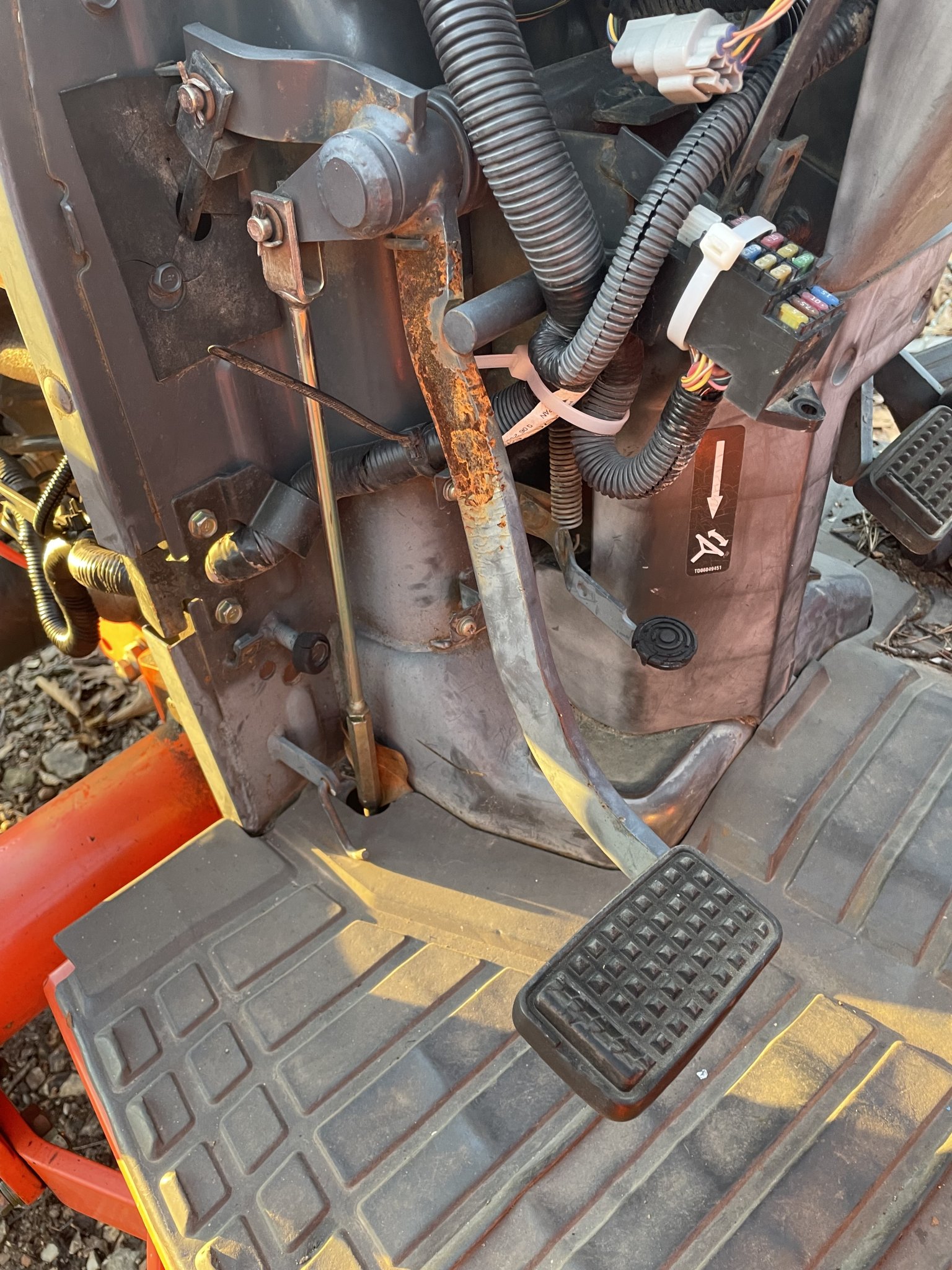

IMG_2353.jpeg I ended this thread with false info. We thought we had a run out of fuel, an Error 20, possible lightning strike taking out the ECU, bad wire loom to the ECU and more. You all advised me how to get the tractor up to my shop.
it cost me $150 for my tow company to use their tracked skid loader to tow it out of the steep canyon to my shop.
After some work it started and operated fine. So at that point I posted a thank you to you all and tossed in a stupid statement that “the best day in an old man’s life is when he gets his tractor started.” This was in July 2024.
Well I was premature to celebrate! It would only crank intermittently. I gave up. I chain come along drug it up on my trailer and took it to my Kubota Dealer.
They had it over three weeks. The bill was reasonable at around $350. They discovered the issue was when I was bush hogging a year or more ago, a branch jammed into the clutch pedal shaft and bent it in. I straightened it out and went on my merry way. A year later all the issues began.
The Kubota technicians found out that branch intrusion and clutch pedal arm bending also pulled the wiring loom from the fuse box tight. They suggested I reply the whole box with a larger aftermarket fuse box. They gave me copies of service manual pages on how to do it myself. The techs strapped the white plastic wire tie around the fuse box to let me use it until I install a new fuse box. See photo attached.
Been running and using it fine for the last half a year or more like it is.
Just last week it starts but dies when you touch the foot pedal throttle, I have a new thread on that problem. I hope it is not that strained wiring harness behind the fuse box!
