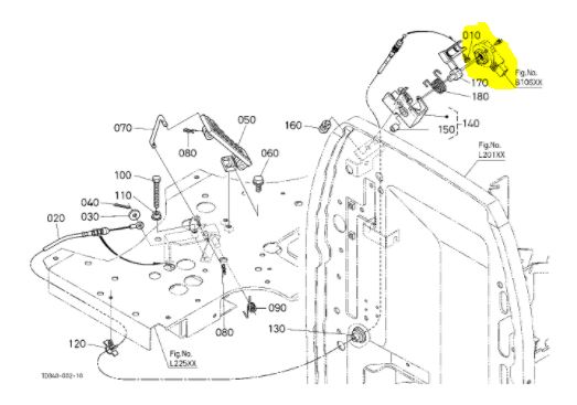

I am having the same problem with an L3240. I am guessing it's the same as your machine. What my dealer came up with is in the Kubota online parts diagram under
Electrical, switch sensor (engine). It's mounted above the injection pump. Sorry buy my lack of digital prowess forbids my sending the picture. I hope this is right.

The sensor above the injection pump is the Speed sensor, the throttle sensor is under the dash.
I can point out it's location if you give me the exact model too. ;)

The Model that I have is the L4060GST
There are two throttle position sensors on that model.
One is on the right side below the throttle lever.
The other is on the top dash side of the shutter plate (fire wall) under the dash.
