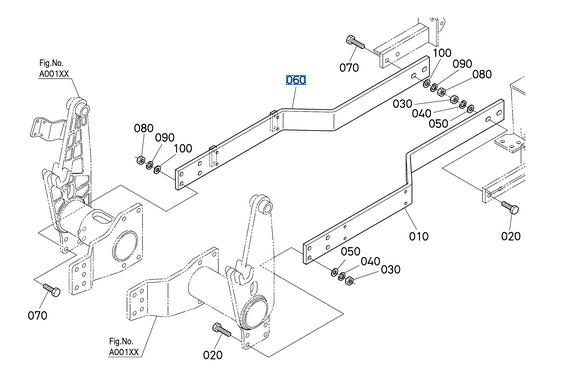

I have a brand new L6060 with cab and loader. I took delivery with the 3rd function hydraulics on backorder, intending to do the install myself. Well, today is the day, and it turns out some idiot at the dealer or factory installed the subframes on the wrong sides. Can I simply swap them? Are they under load just sitting there? Dont want to open up a can of worms in my driveway with less than 4 hours of daylight left.
Are you talking about 010 and 060 in the image below? I see no reason if the bucket is on the ground that there would be any tension on the sub-frames. Swab them and I would toque that bolts back down.
14,353
6,609
From the diagram shown above it appears both sides are the same except for the two small brackets on the right side that appear to be attached with bolts. Might be able to remove the brackets and install on other side.
12,948
5,680
from the diagram, it looks like #060 has 'something' on the outside compared to #010 (where the #010 label is), so I can see why they need to be swapped.
I don't see any 'loading' issue as loader frame is firmly bolted to frame.
So, go grab a fistful of wrenches,crawl underneath and get 'er dun !

Yes, those things on 060 are what the 3rd function valve bolt onto. It like a bar thats welded on with threaded holes in it. On my tractor, 060 was installed the left, and 010 on the right. I decided to loosen all the bolts first to make sure there was no load, which there wasnt, and I was easily able to swap them out.
Once done, the rest of the install went pretty quick except for the fact the stupid little button that turns on/off the 3rd function fell apart during install, so I'll be sure to bitch the dealer out about the subframe on Monday when I call to make them send me new parts
If the dealer installed 060 on the left and 010 on the right, then they did it correctly according to the diagram that has been attached. It may not be what it needs to be for your 3rd function, but they were following the diagram for proper setup. So in reality, they did it correctly if the setup person was following the diagram.
Not to argue, but I think you are reading the diagram wrong. If you were sitting in the seat facing forward, 060 is on the right and 010 is on the left.
