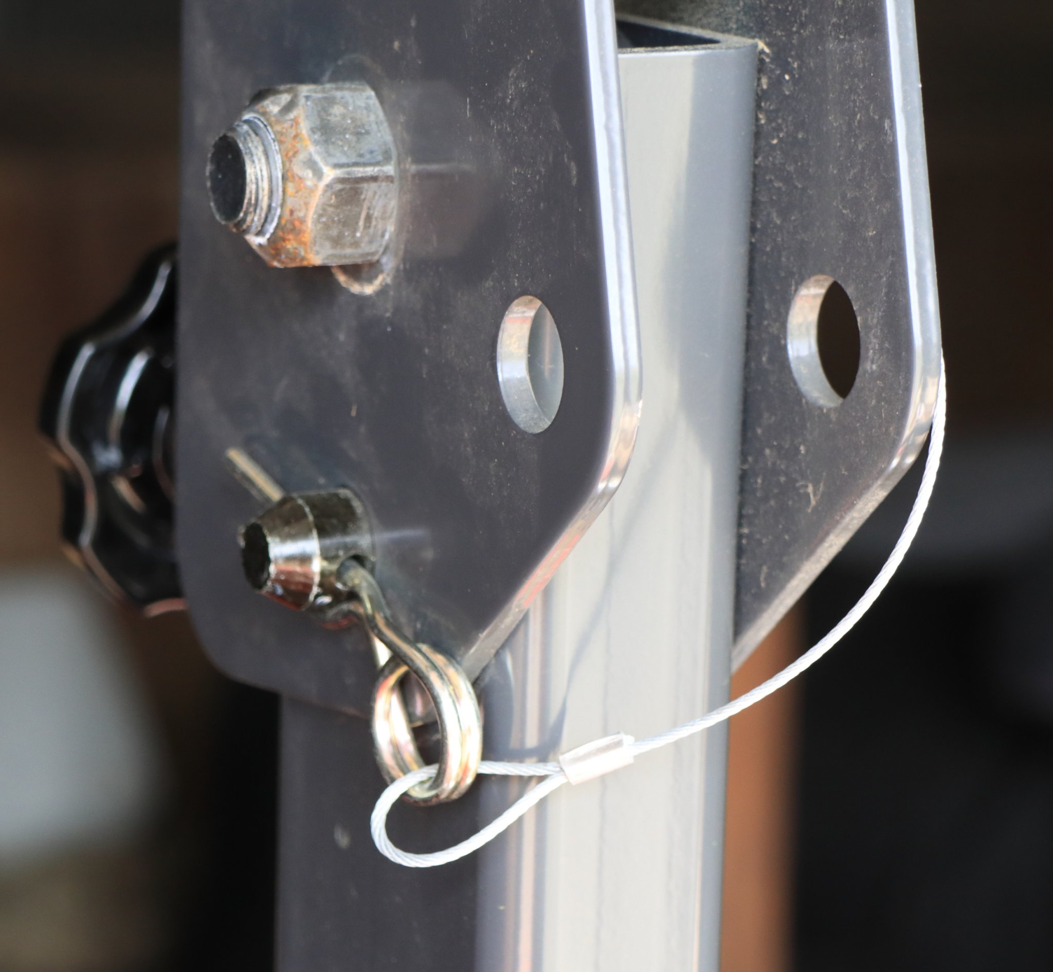

Kubota may feel the ROPS folding needs to be faster/simpler with the F series mowers. My F2690 folds quickly; unscrew tension knobs a turn, remove cotter key, pull pin and fold. The knob supplies enough tension through a plate to prevent any slack/rattle in the system.

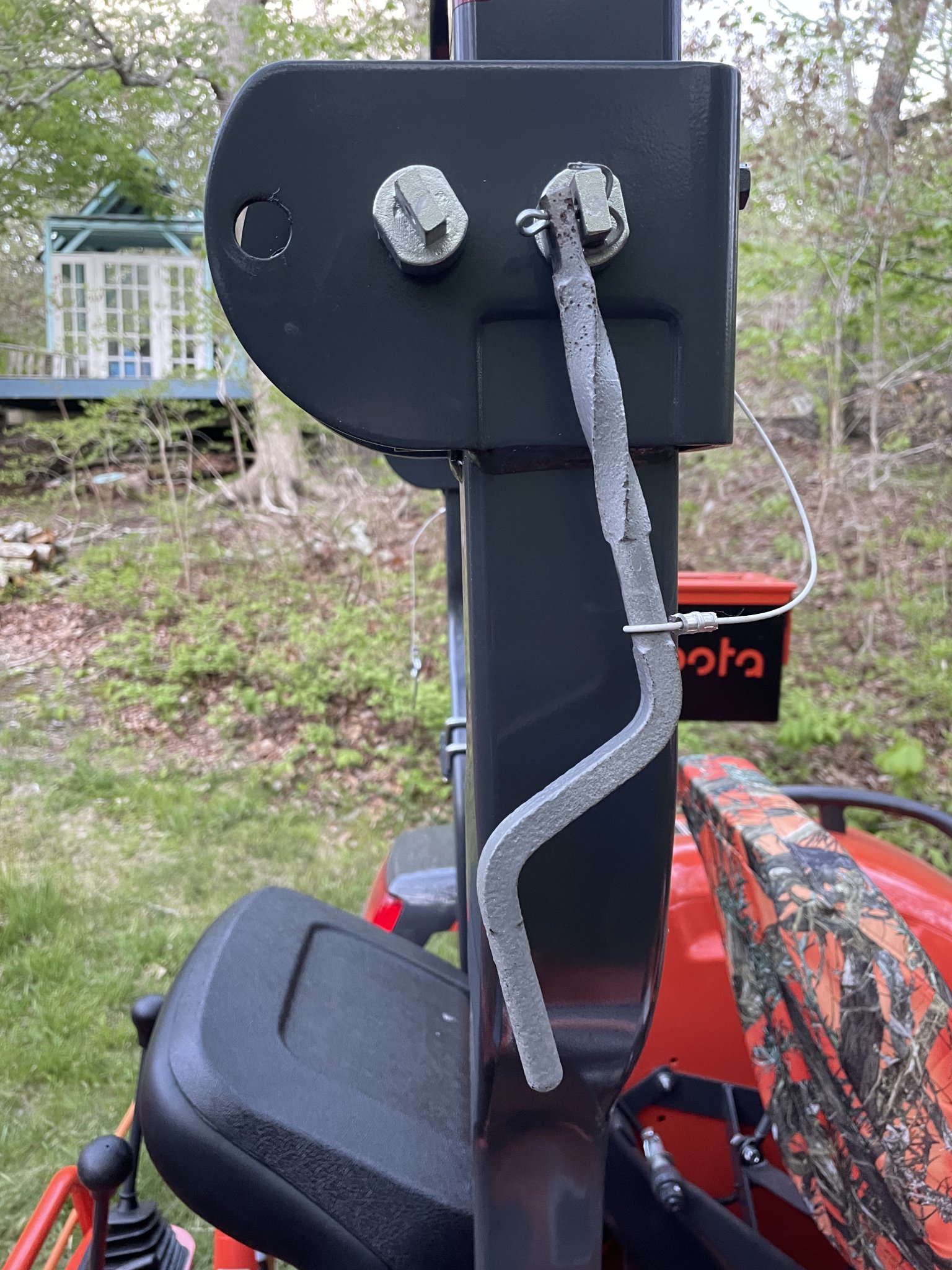

I used the cranks from an old set of pump jacks. Drilled a hole and connected with small screws, washers and nuts. Tethered to clip with crimped wires. turns of the crank gets it done.
