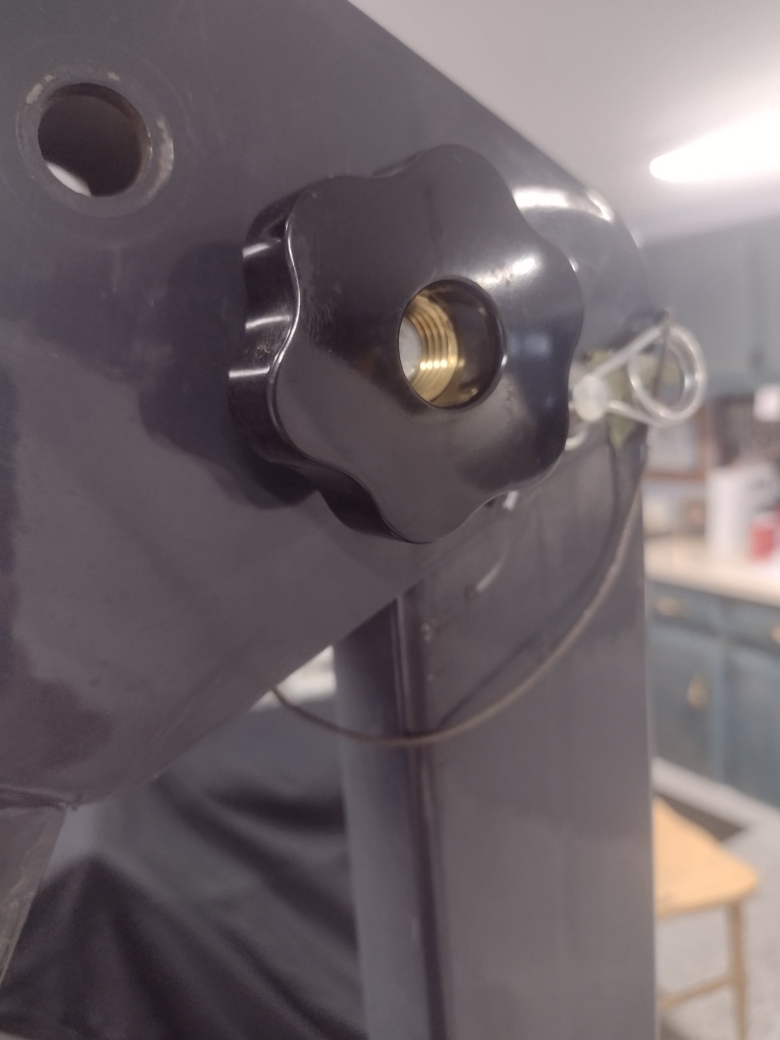

To solution the ease of raising and lowering the ROPS. I installed spinner knobs on the thru bolts. I no longer have to get a wrench and a ratchet to tighten or loosen the upper folding ROPS arm. The spinners stay nice and tight by hand,they are not going anywhere.. Easy fast and convenient. McMaster Carr has them..

Excellent solution!
