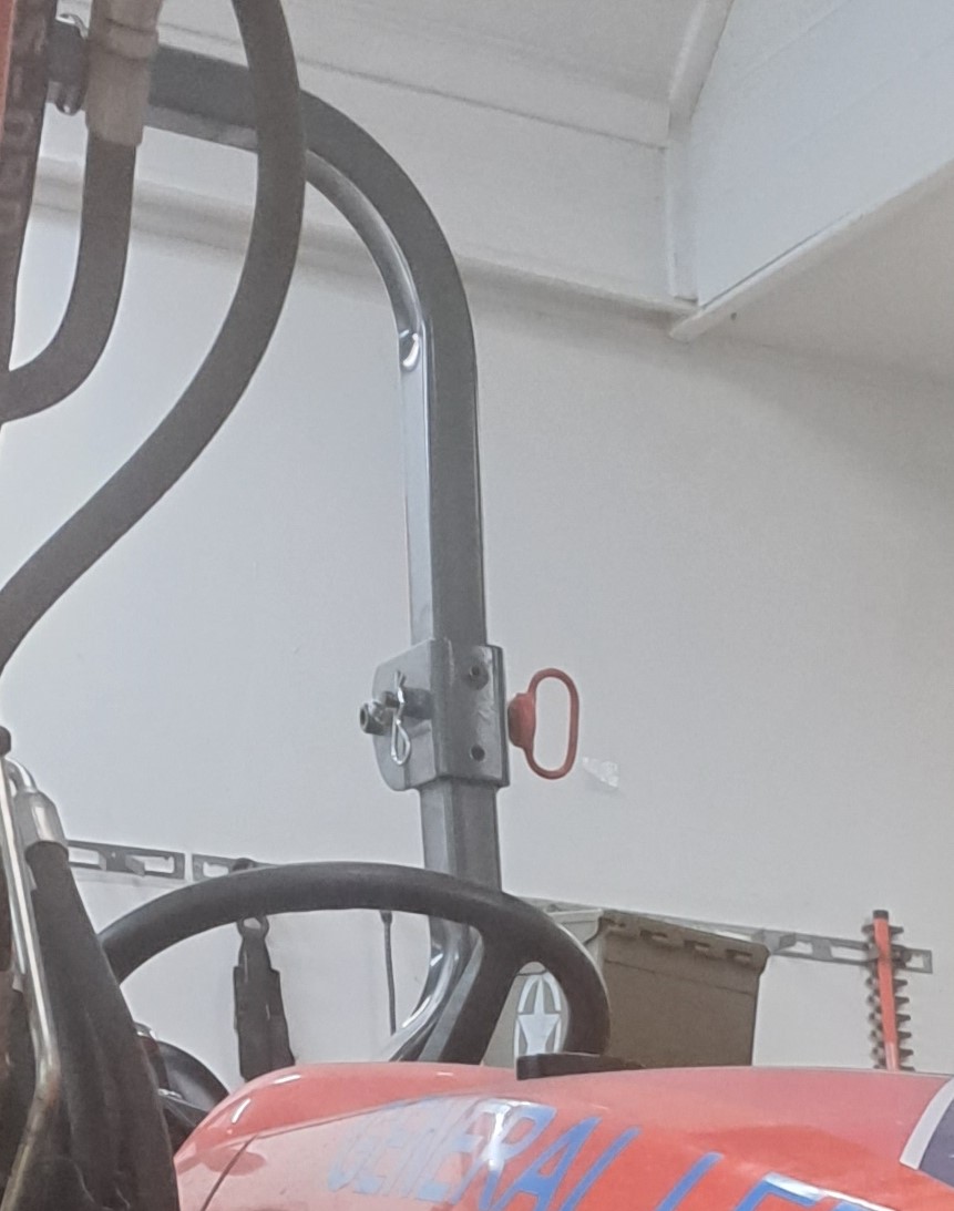

I know better than to say this out loud....but since my screen name is "Runs With Scissors" it shouldn't be totally unexpected.
I went to TSC and bought 2 linch pins and ground the end down to to fit.
Now its just pop the retaining clip and pull it out. Takes 4 seconds per side.
I did the same.
Yes, I want/need a larger garage but, that project keeps getting more and more expensive. It’ll happen someday but, pins were much cheaper.

My BX has folding ROPS with a pin. (I know nothing about an L4701) and I have to remove it and install it every-single-time I enter or leave my garage....it's that low of a ceiling and door!
If it was a bolt.....I'd probably move. LOL. There is no option for a taller door.
Shorter Answer: PIN !
