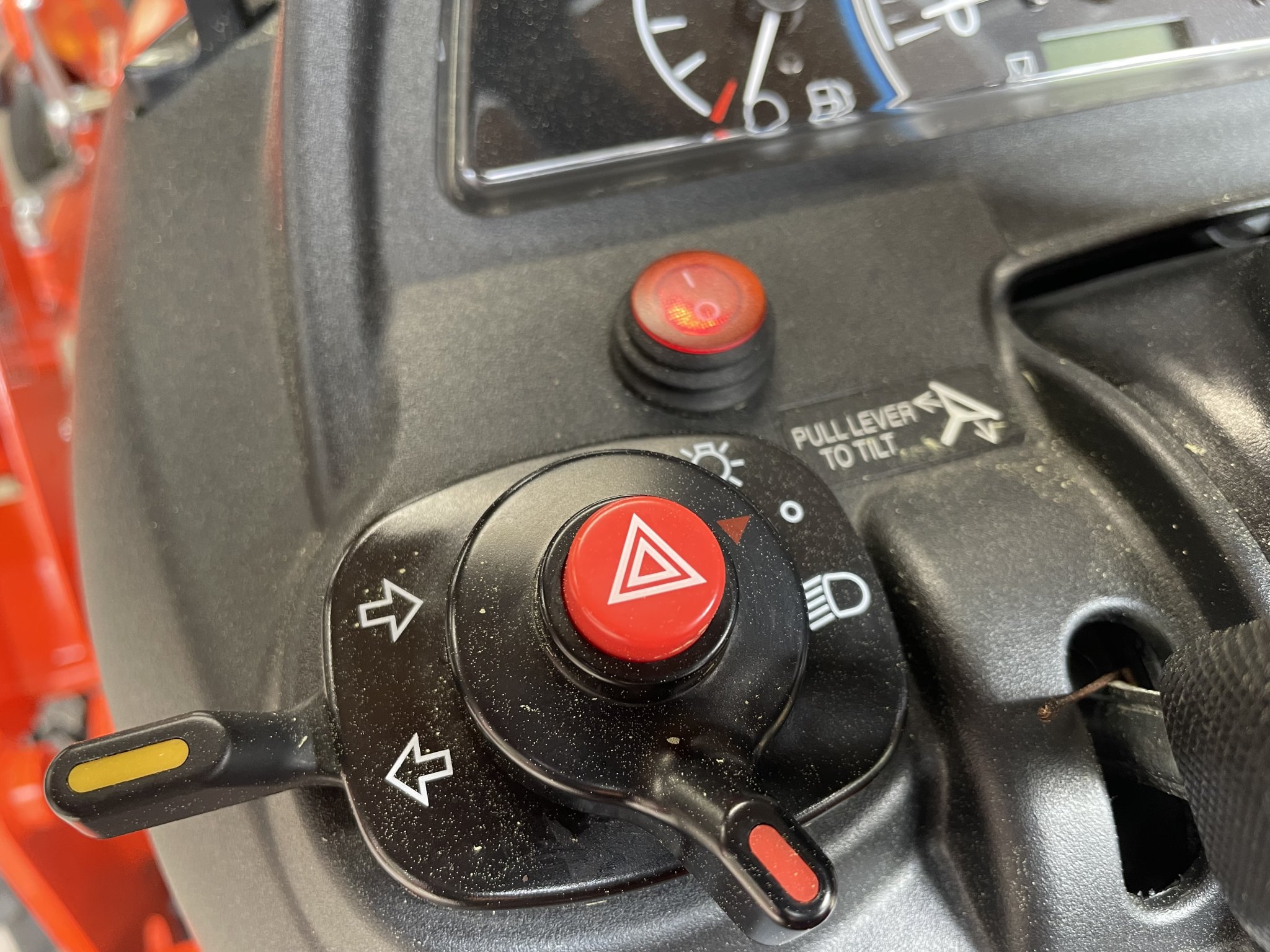

Owned a 2001 BX2200 for the last 23 years and upgraded to a BX2680. Needed some better lighting and watched most of the youtubes and couldn't decide if I wanted to use Giant U bolts, Tie wraps, Industrial Magnets or even Double Sided Tape or Glue to mount them to the ROPS.
So... I went with None of the above.
I counted at least 22 10mm sized holes already in the ROP, so I figured a few properly placed 6mm threaded holes couldn't hurt.
The LED kit cost $49 and took 6 hours to install, The Right Way.
I could do it again in less than 3 hours after this install.

Ran the circuit all the way to the under dash for access to the battery and dash panel for switch and relay install.

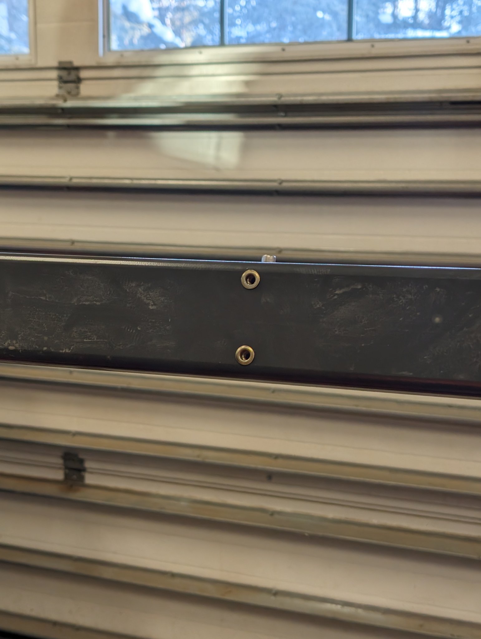

1/4-20 rivnuts ftw! ;)
I haven't heard the term "Riv-nuts" since I was an A&P many moons ago. (y)
I solved my "I need lights problem" by carefully installing one of these in my hand, and the other in my mouth when it starts to get dark.
No drilling of the ROPS involved.
But yours works too I guess......;)

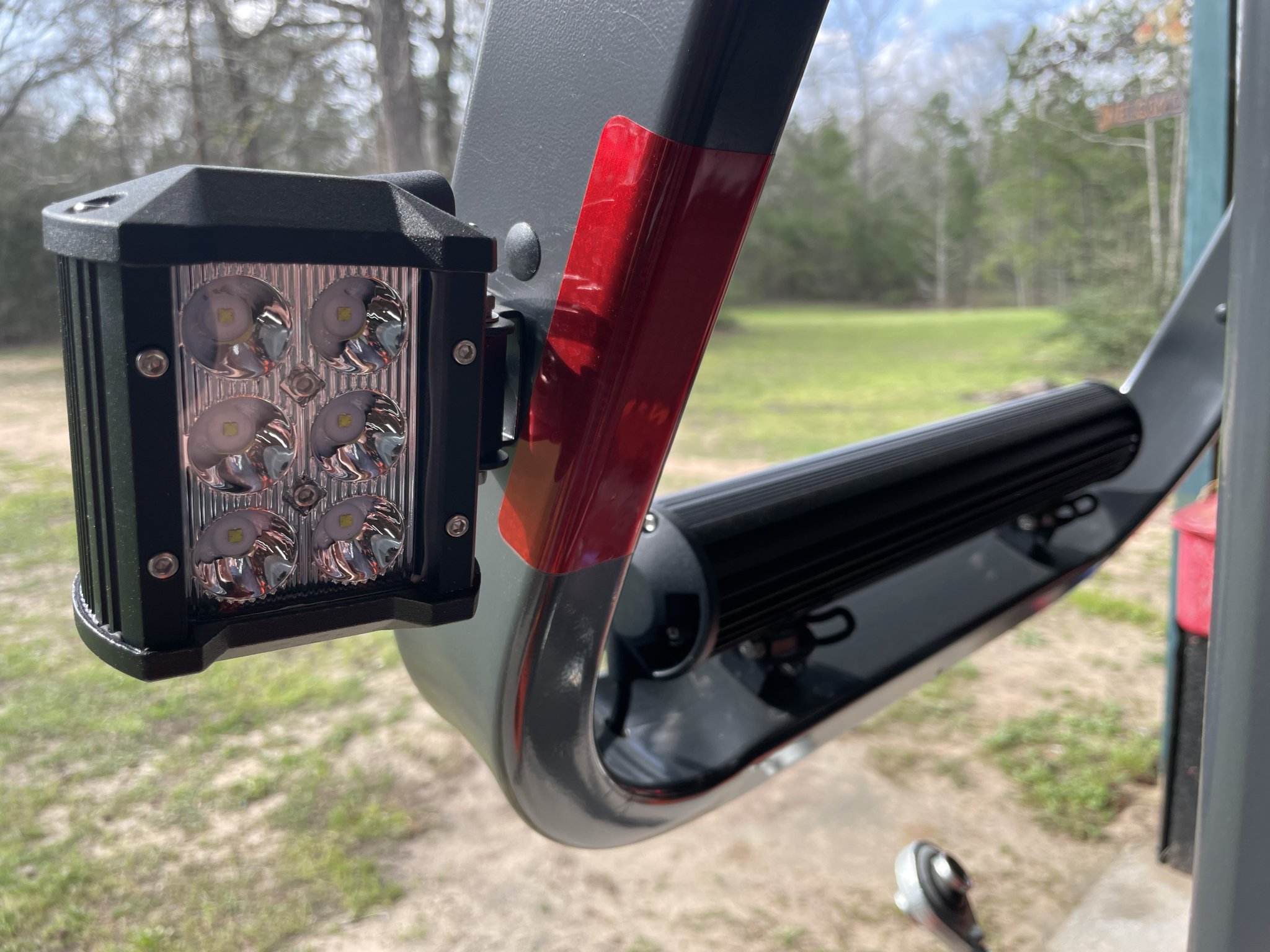

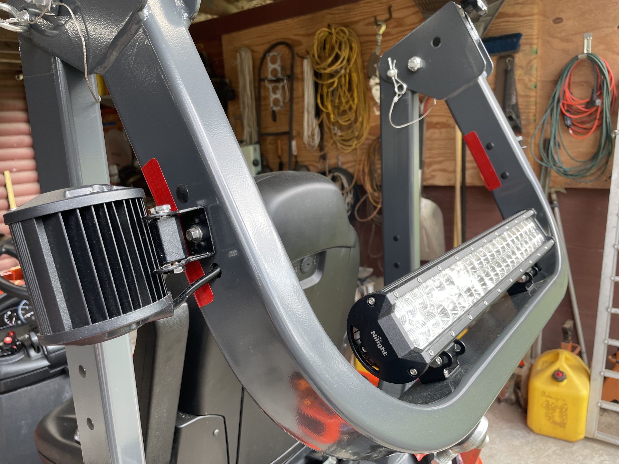

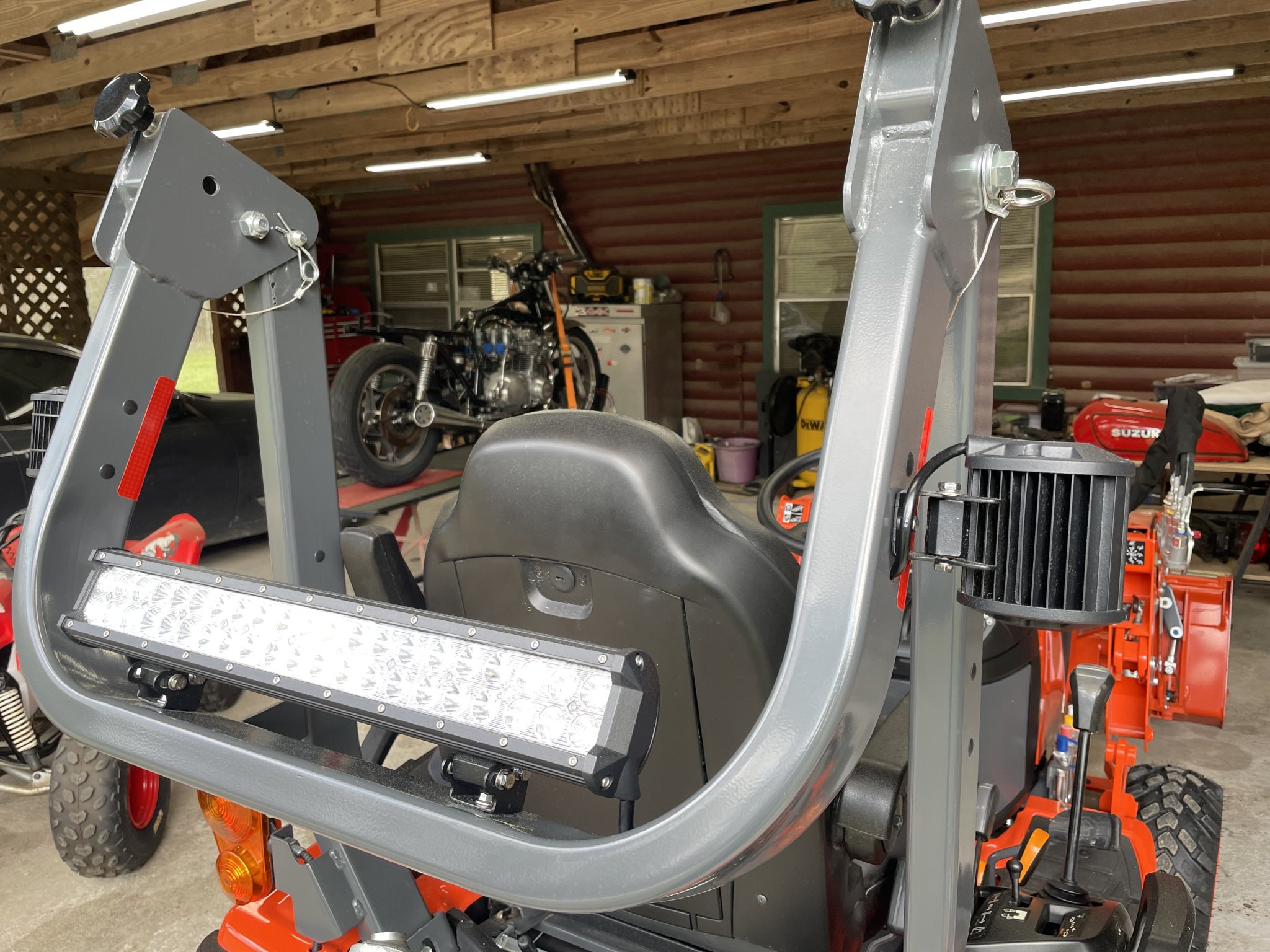

View attachment 123641 View attachment 123642
Installation of light bar is very similar to how I installed a 22" light inside the ROPS on my B3350.
Again, installation was time consuming but could do it again in less than one half of the time.
