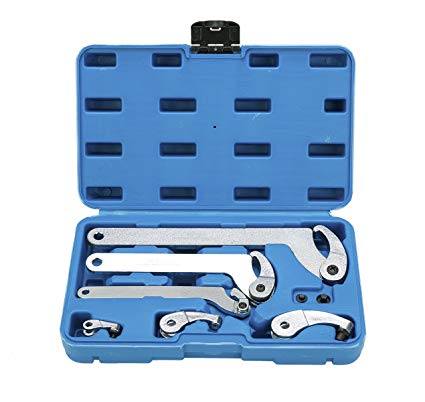

I have a set of pin spanners like this one, (bought at garage sale for $10) with hooks, pins, and arms in various sizes. Pretty handy for such things.
https://www.amazon.com/8milelake-Adjustable-Hook-Wrench-Spanner/dp/B01AW44BVM

I was expecting the end caps to be really tight. If not so tight, I am wondering if I could stick a couple of short bolts into the pin holes and grab the heads of the bolts with a large pipe wrench - I already have access to a 24 inch pipe wrench on site. I don't want to grab the end cap directly with the pipe wrench.
