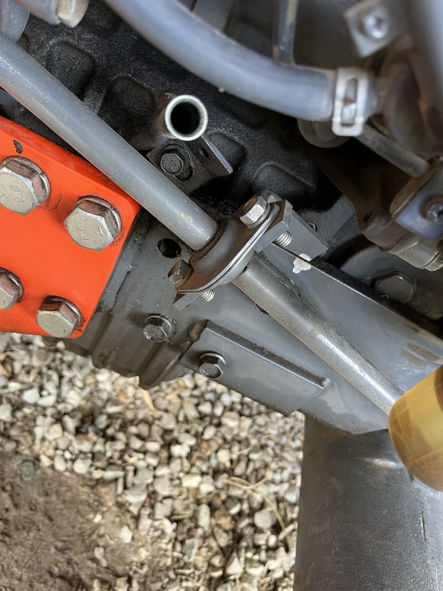

A Year ago I purchased a used L3800 . When I checked the oil the dipstick was too short to read to level, it took a while for me to realize the remainder had snapped Didn’t know how to remove it but I ordered a replacement and was able to get it past the broken end and since I had done an oil change it was the correct level. I did another check recently as I’d added 50 hours of usage but the replacement has also snapped.
Even if I undo the nut on the insert tube the sticks will be too far down . Can anyone offer suggestions how to extract the dipsticks?
Thanks in advance !

Id say pull the bolt, and dipstick tube. You may find it is damaged. Then you may be able to get a thin flexible magnet down in there. I am guessing you will find the tube is damaged. Good luck

Something doesn't look right with that gauge guide and bracket, like it’s bent or just misaligned.… aiming the gauge where it doesn’t belong.
