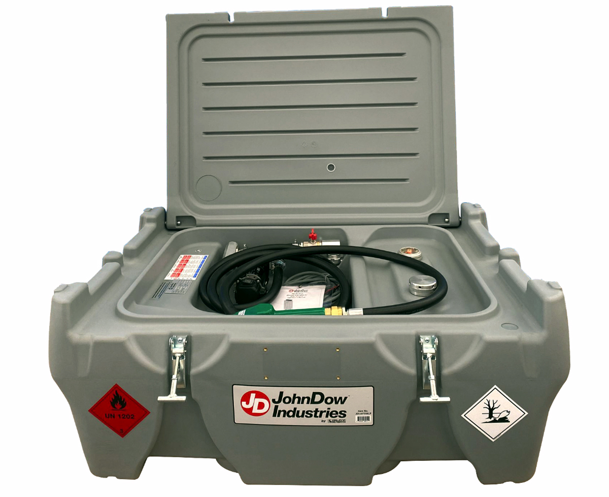

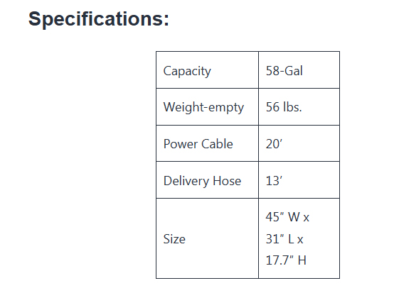

Here's a link to JohnDow's website. I ordered from Summit Racing since they have by far the best price I've seen with an $80 discount (GORACE) and free shipping.

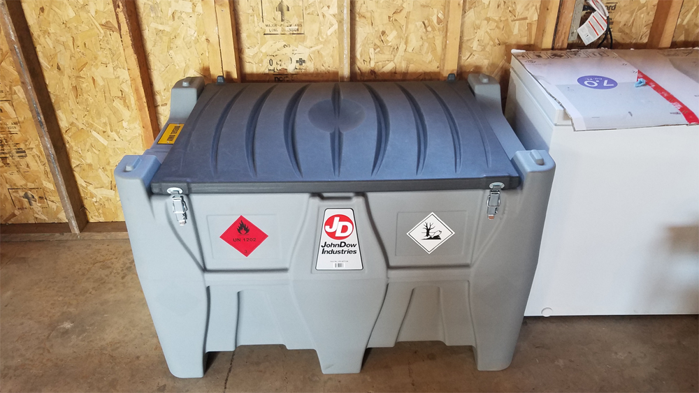

I have this 106 gallon JohnDow in the garage. I started to make a dolly for it but it's another project that I never completed. This spring for sure.
I really needed a fuel solution for when I'm away from my place with a tractor or two. That's where the second JohnDow 58 gallon bed mounted tank will prove to be useful, in addition to roadtrips of course.

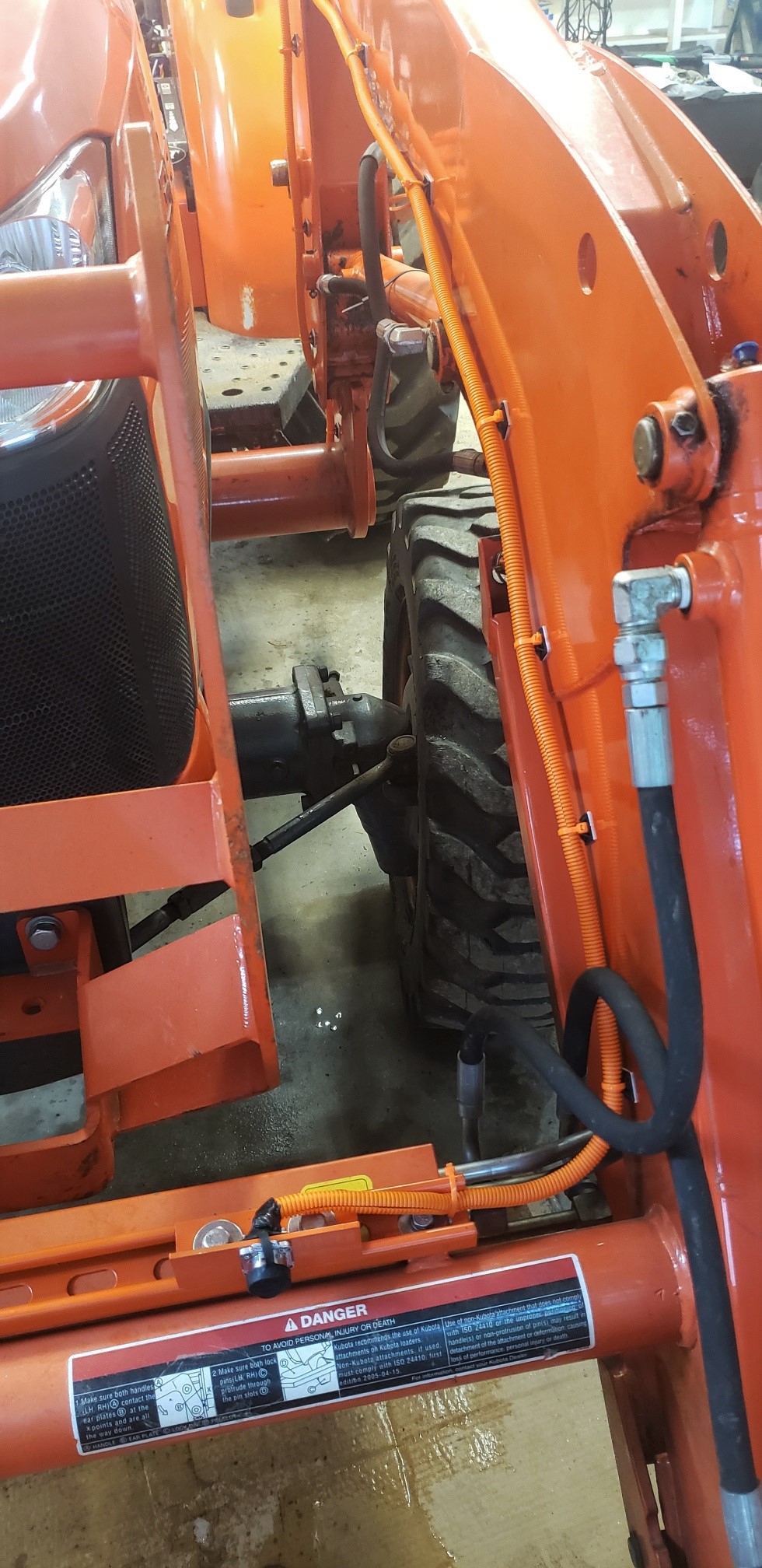

You did an awesome job with that 55 gallon drum. You didn't say anything about the 12V outlet that you plug your pump into. I want to know more about that.
Thanks!
Pretty straightforward install. I mounted a piece of strut on right above the hydraulic lines on the fel cross member:
Then I bolted that small SS angle to it with a 20 amp rated socket. The wiring goes back to the pivot point of the fel, then to the tractor body and then back up to the battery. I have a fused connection on the positive side and the negative connects on top of the battery negative wire at the chassis.
The thought was I would add a connector at the pivot point so I could disconnect it there if I ever wanted to drop the fel. Yeah, it's been a couple of years - still no connector :)
I have a mating connector on the diesel pump and one on my battery tender.

Nice work! What was your thought process re installing the outlet on the loader rather than on the frame of the tractor beneath the battery? I have block heaters on both tractors, and with the loader attached it's a little bit awkward getting an extension cord connected so I can see the desire to have the outlet easily accessible.

It was mostly convenience On the other side of that strut I installed a bracket for 2 hydraulic hoses for the grapple. I have been toying with the idea of installing lights on that strut to clear the bucket. Another project that may never be. . .

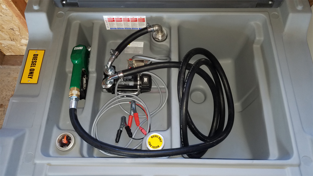

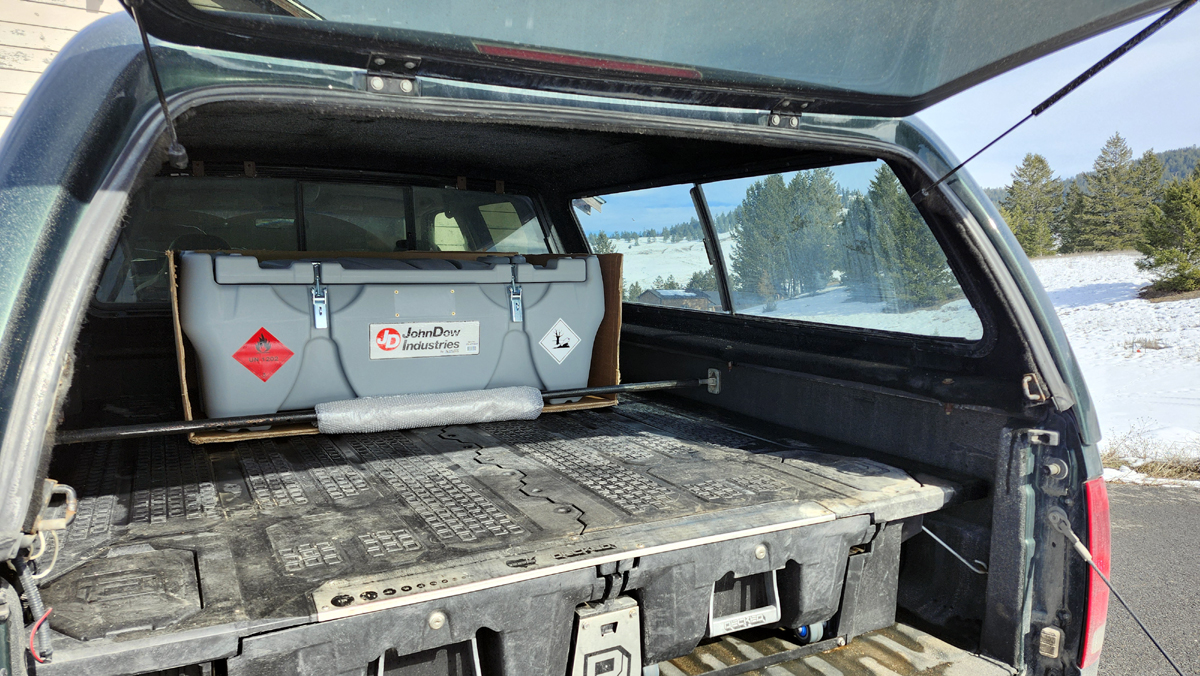

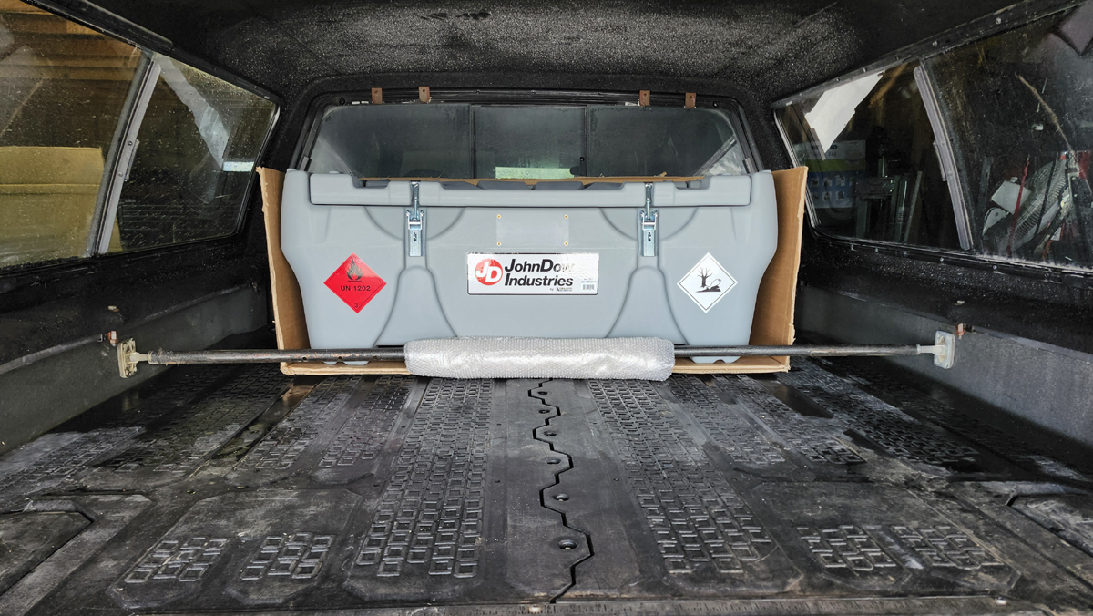

I picked up the JohnDow 58 gallon bed tank this morning. Miraculously there wasn't any damage to the tank during shipping. I'm very pleased with it, and although it would be easier to access without the Snug Top, I think the pros of the top outweigh the cons.
The bed of my truck was quite filthy so I stopped by the local gas station to hose out the back before getting the tank situated so there's water all over the place. I'll pick up a new ratchet strap to secure the tank this week, and then move the bar up and back towards the rear of the truck. That's there to stop stuff from sliding into the tank.

That storage system that the tank is resting on appears to be plastic. The tank will be prone to sliding around on that surface. You may want to get a rubber mat to place the tank on. That will keep it from sliding around while driving. That and a strap around the tank securing it to the bulkhead of the truck bed will keep it secure.

Good call on the rubber mat. (y) I have a Decked drawer system that I really like, but as you say, that tank will want to slide on the hard plastic surface. I was just going to add a ratchet strap but I'll get a piece of rubber mat from Murdoch's or similar.

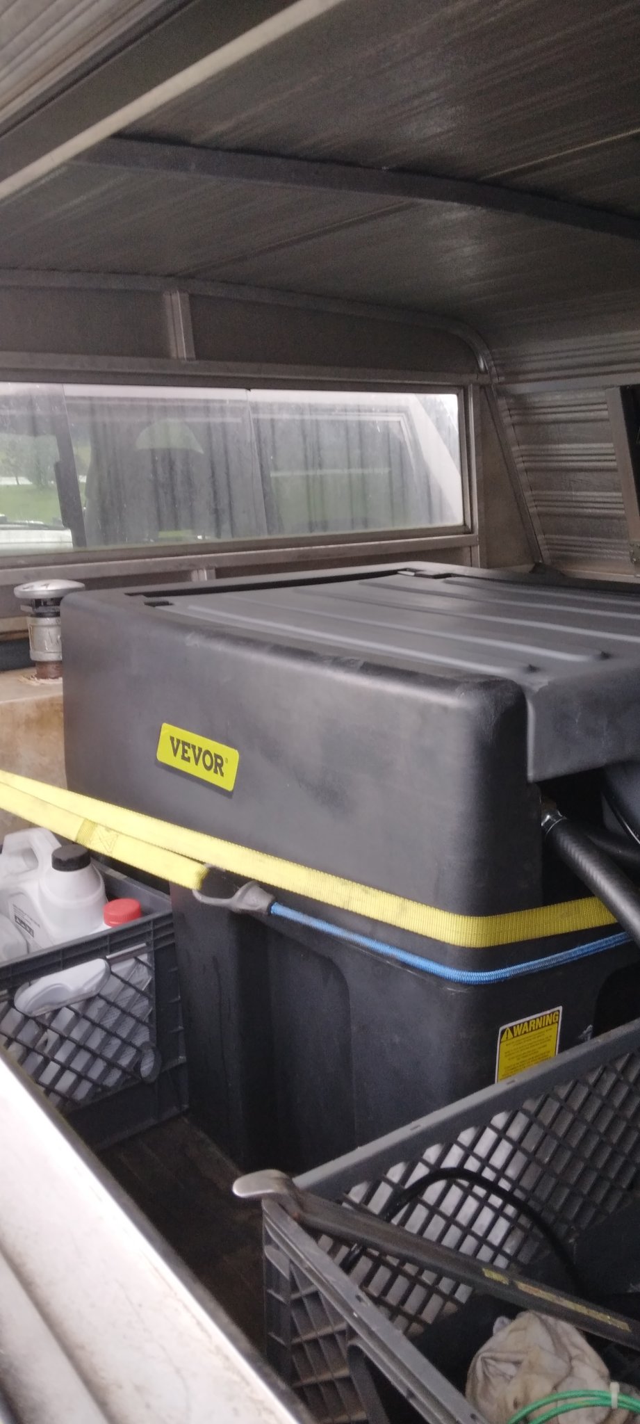

This is the best I can do for a photo of my setup right now. I have a 40 gallon diesel transfer tank secured to the floor of the bed, up against the bulkhead. Then I have the 58 gallon tank also secured to the bulkhead with ratchet straps. All of that sitting on top of a full size rubber truck bed mat. Those tanks are not going anywhere.

How do you like your Vevor 58 gallon fuel tank, accessories, handle, hoses etc?
Do you know if you can get pallet forks under it in both the short and long directions?
I had one of the JDI units in my Amazon wish list, but it’s pretty spendy (over a grand) and I see the Vevor is around $600.
I will say the low profile JDI 58 gallon tank looks pretty sexy, but it’s not real space efficient if head room isn't a primary concern.
