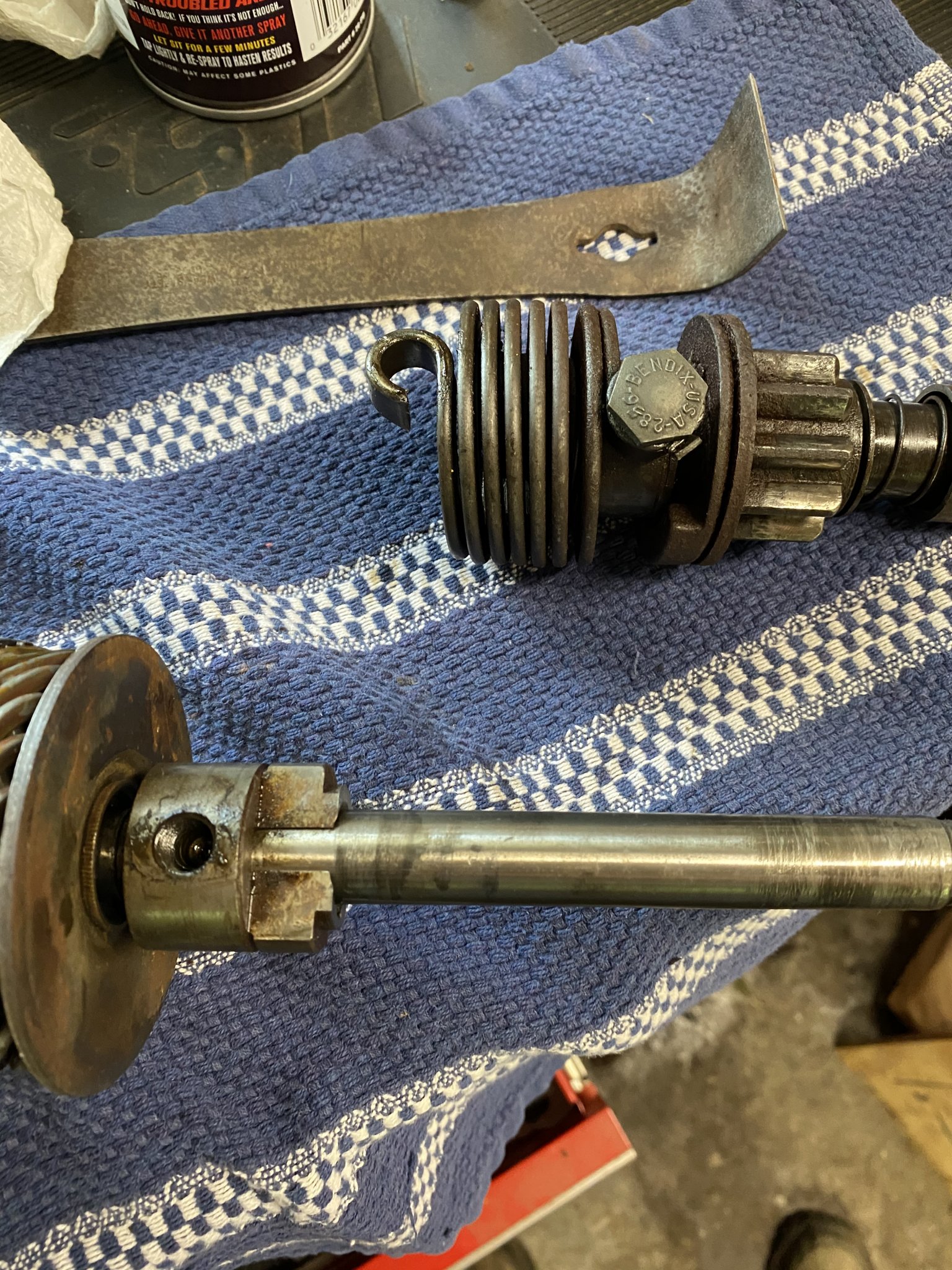

I think I have a better understanding of how the Bendix mounts to the shaft.
The end cap slides 1/2” or so on the shaft. It’s actually held in place by the nose cone.
New one:

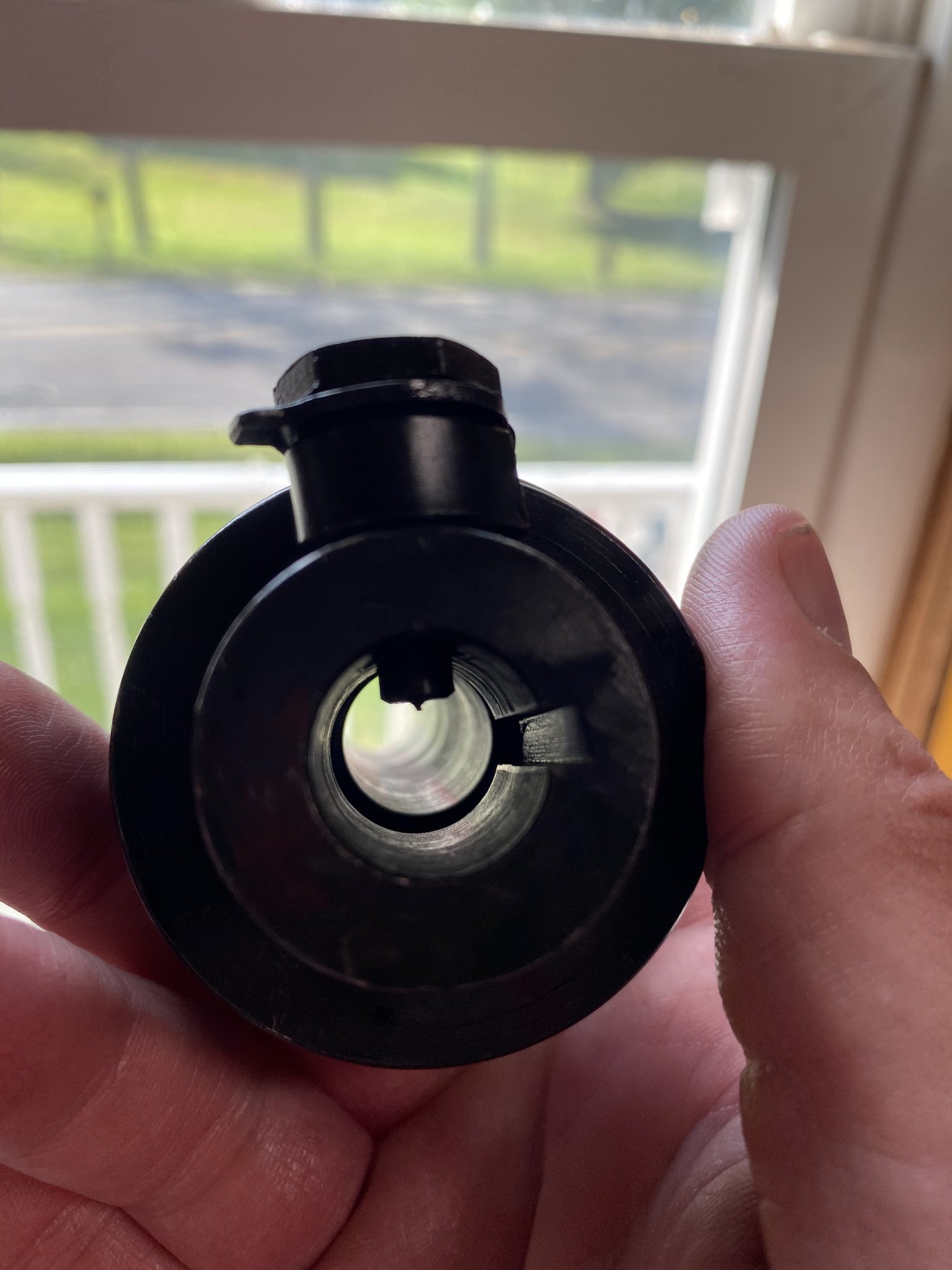

Here’s the internal part of the new Bendix. Looks like one of the set screws is tight to the motor shaft, the other to the shaft of the Bendix proper. A Woodruff key in there, that I can’t see yet on the old Bendix.

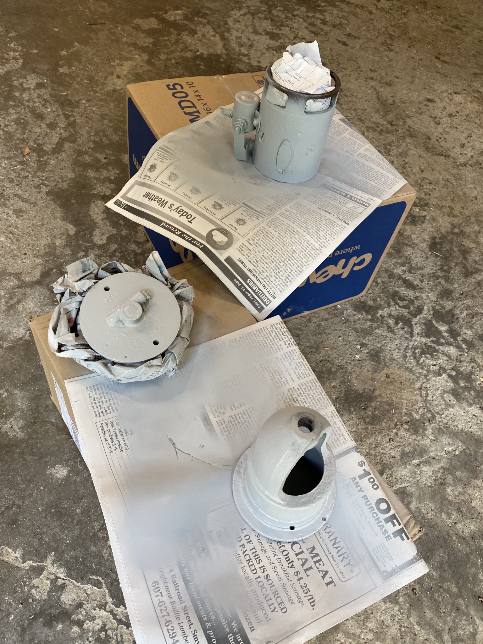

Hope it’s decent paint, as I got a case of 6. $40 plus tax and shipping.
Won’t paint the tractor with a rattle can, but at least the parts I have off it.
Not sounding like the paint police, but the tractor was painted a non-OEM color for the model. The color is a MM color, but not correct.
This is original color (I hope). At least starter will be correct, but I might just paint it black...we’ll see.

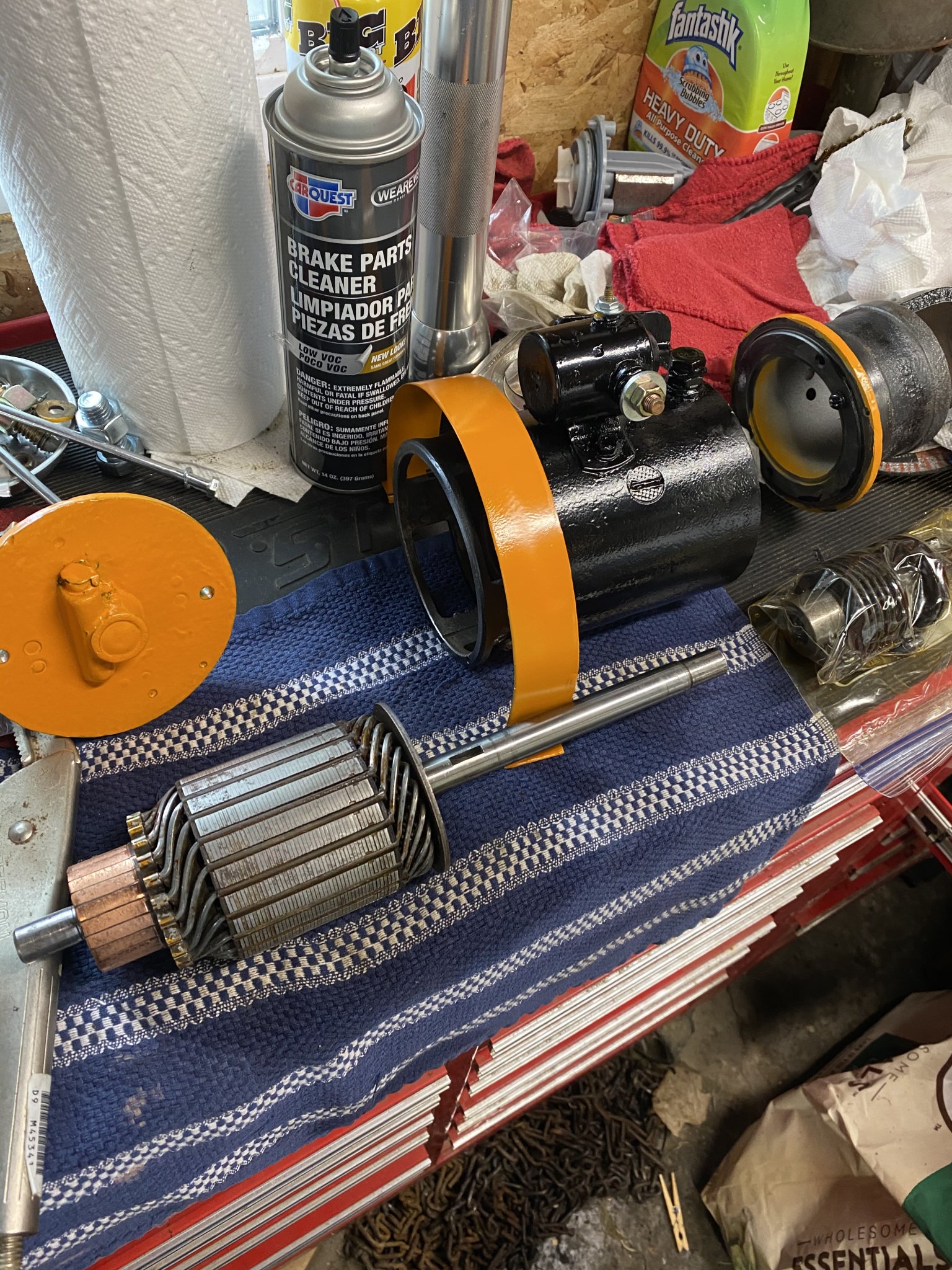

Opened my redneck paint booth after some rigorous time with a die grinder and cupped wire wheel.
Heck, it’s a cast engine part....not looking for a mirror finish.
Guessing the nose cone should not be painted, but I can strip that off easily if needed.
I did mask off the ID tag on the starter. It was painted over, but wanted it readable this trip.
I did not replace the switch.
Hope that wasn't a mistake. Didn't see an identical replacement part, but didn't look for one closely.

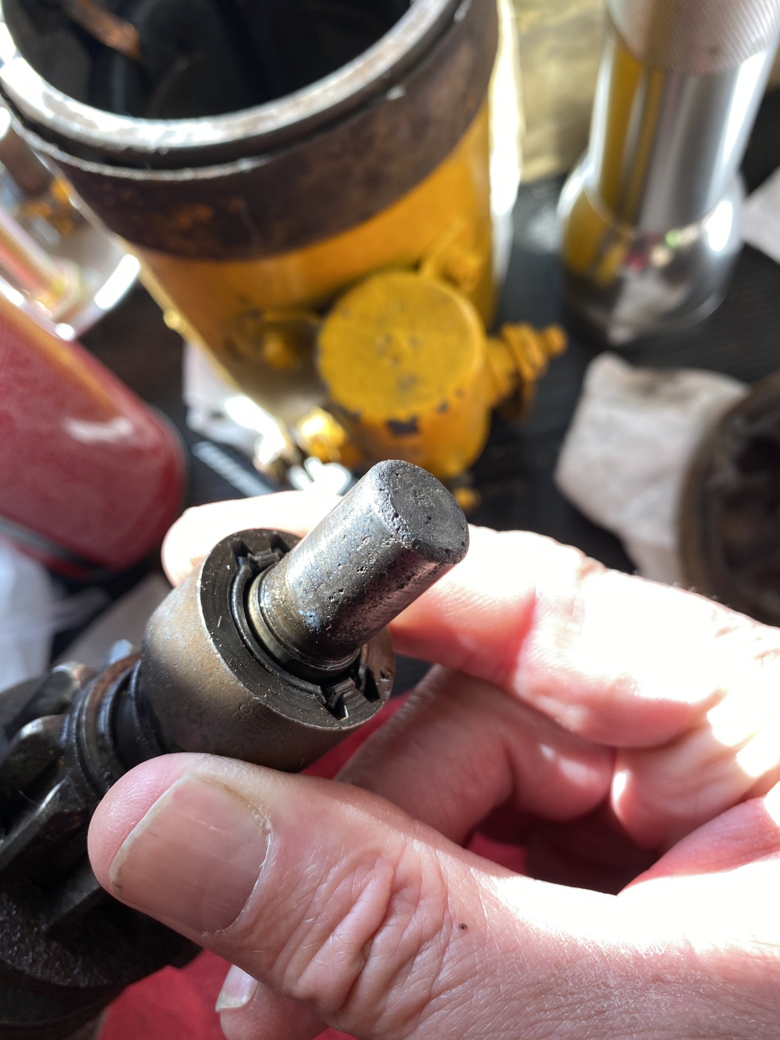

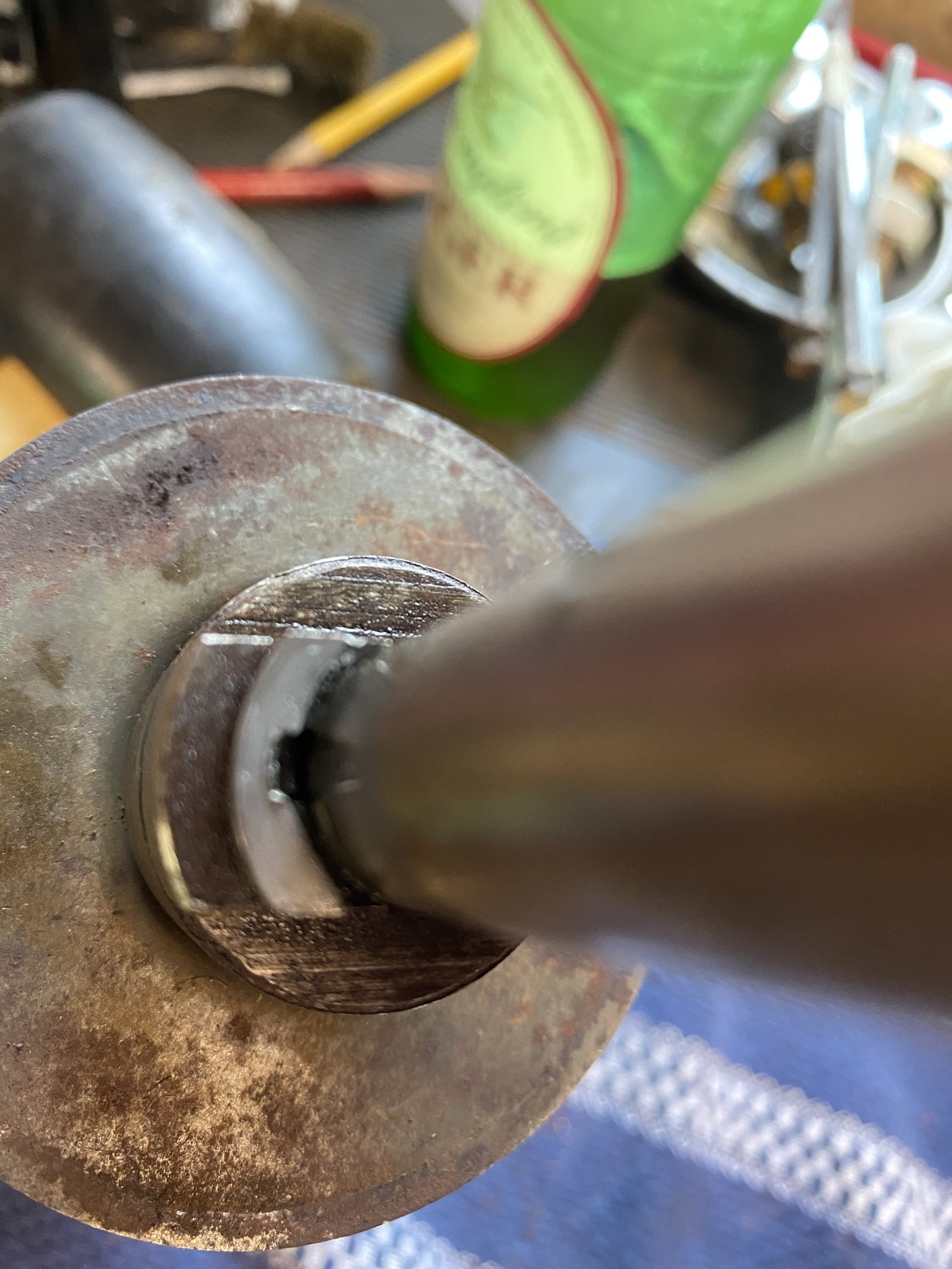

Guys - - - I need help.
The hub in the last pictures doesn't want to give. It's the hub of the old Bendix that mounts to the rotor shaft.
There's a key in there. The key is 90 degrees from where the set screw was.
I can’t see it from the rotor side. Just not enough room.
The key-way groove in the hub was boogered up from one side when I opened the starter up. I'm not pulling it in that direction that it would be a problem.....
The collar/hub with move 1/2" or so along the shaft, so it's not frozen. It will also rotate a couple degrees.
I have doused it with penetrating oil -- PB Blaster.
I don't have a gear puller that can get on it...
Jeepers - if anyone has a suggestion, I'm all ears....You can't get another one of these rotors......
This is the problem:
10,172
7,055
Iff’n I can get a small set of channel-locks in there, I’ll stand stand It up and beat the snot out of it....

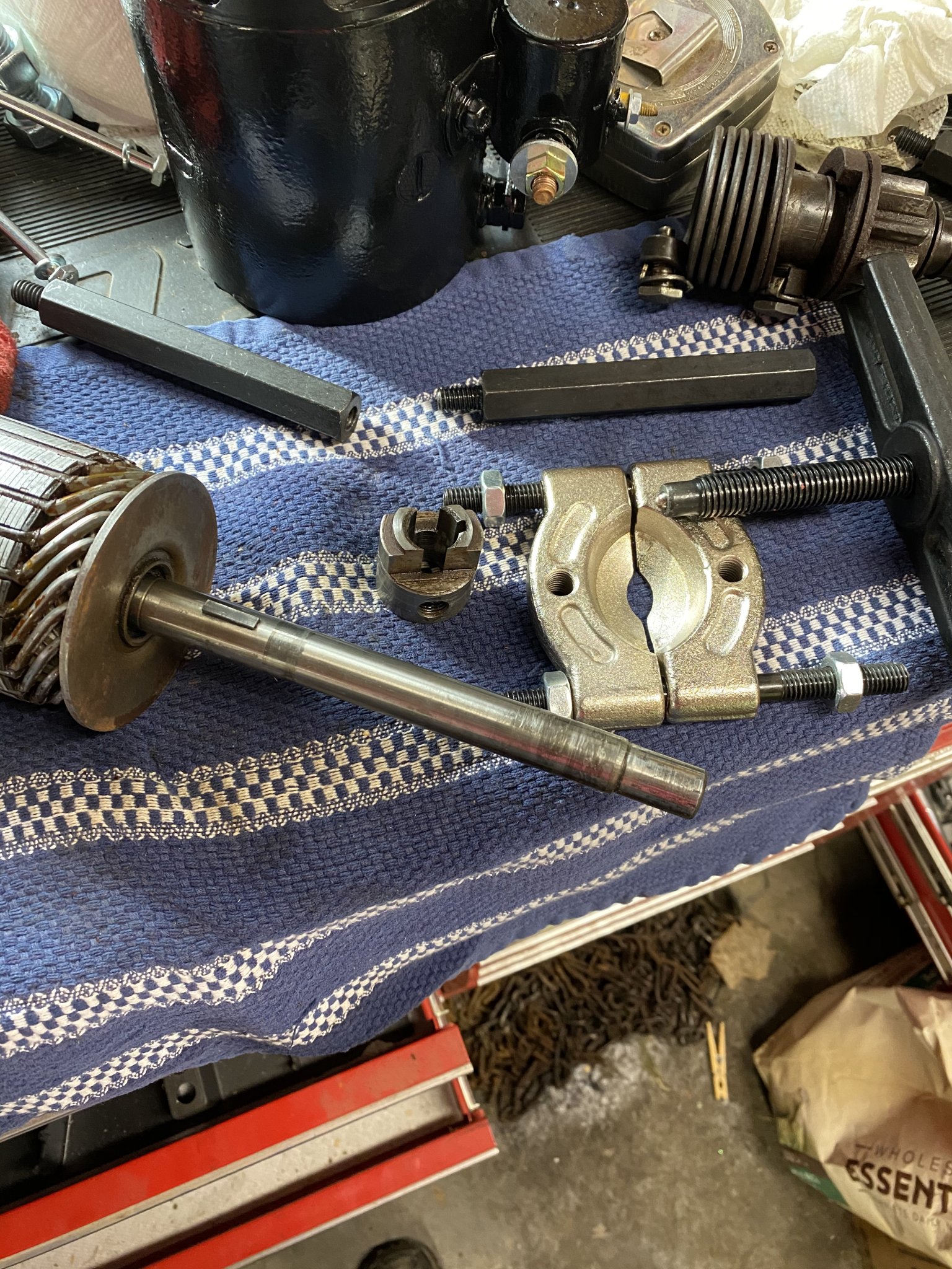

Bearing separator/puller delivered today.
Fit just fine. The hub fought it some, but it pulled off just fine.
I have several pullers but none fit....best to have the proper tool....:cool:
As long as I was at it, I bought a slide hammer too. Had several instances over the years wished I had one.

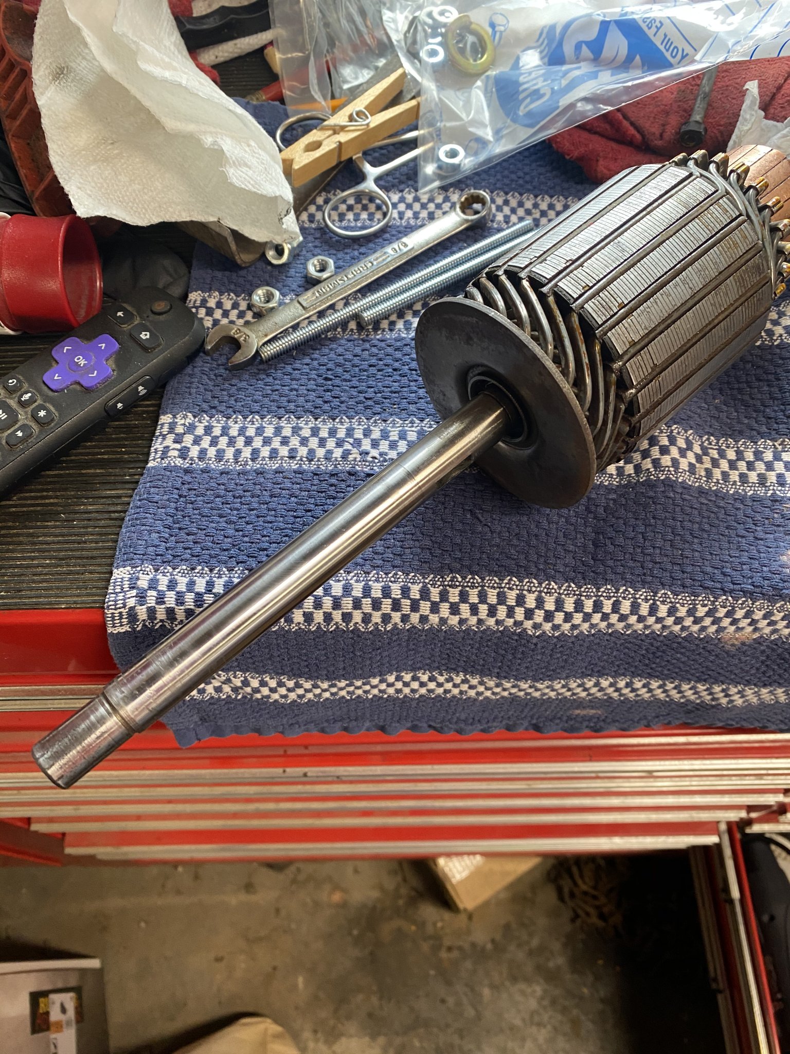

Will replace key; seems to have some wear. Should be an easy size, but might need cutting for length.
Will also polish end of the shaft up with some sand paper and steel wool.

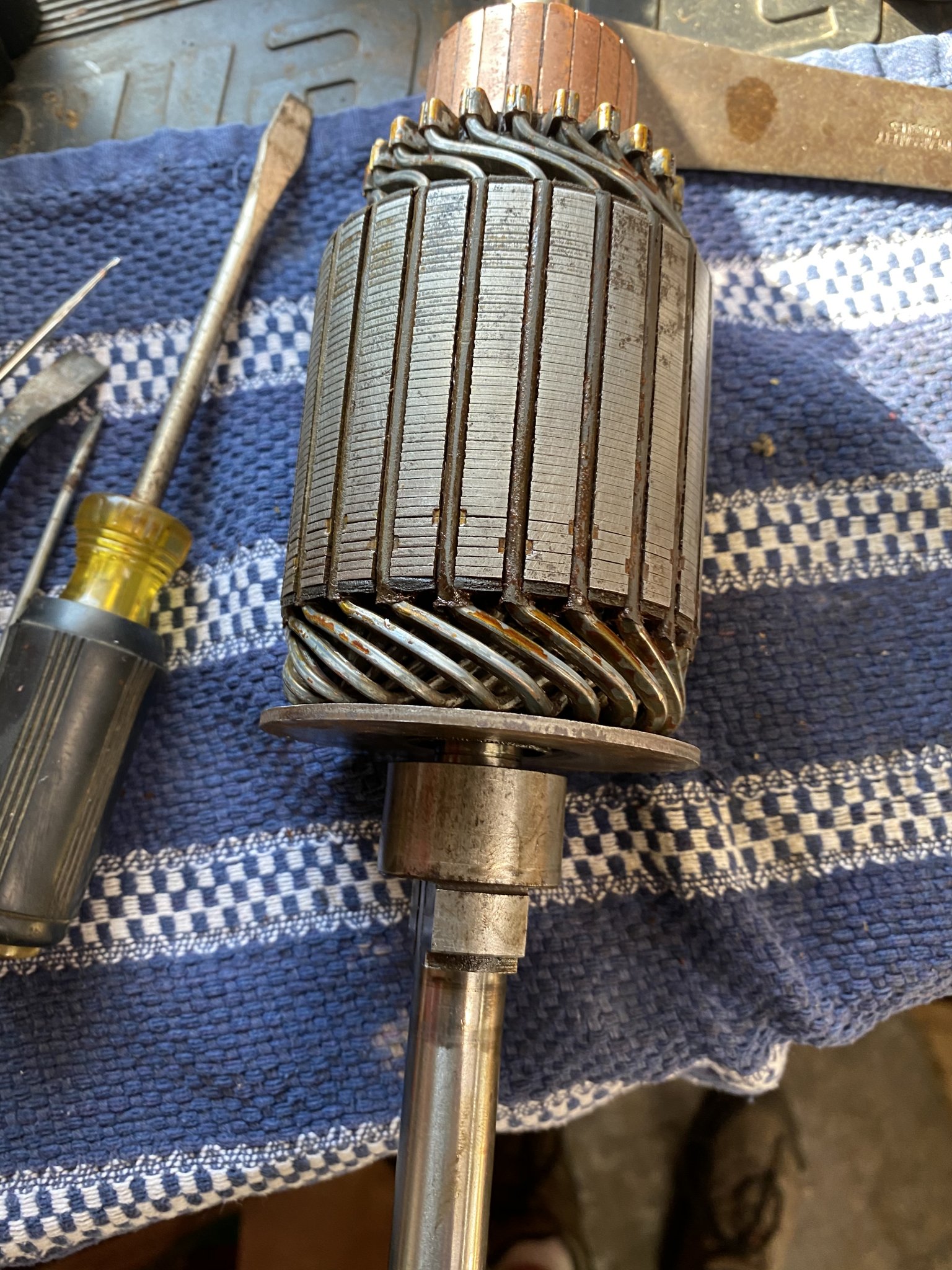

Definitely looks worn.
Thinking a new key should be easy enough to get at a couple local places.

Need to polish motor shaft a little more with 800-grit paper. Couple small "ripples."

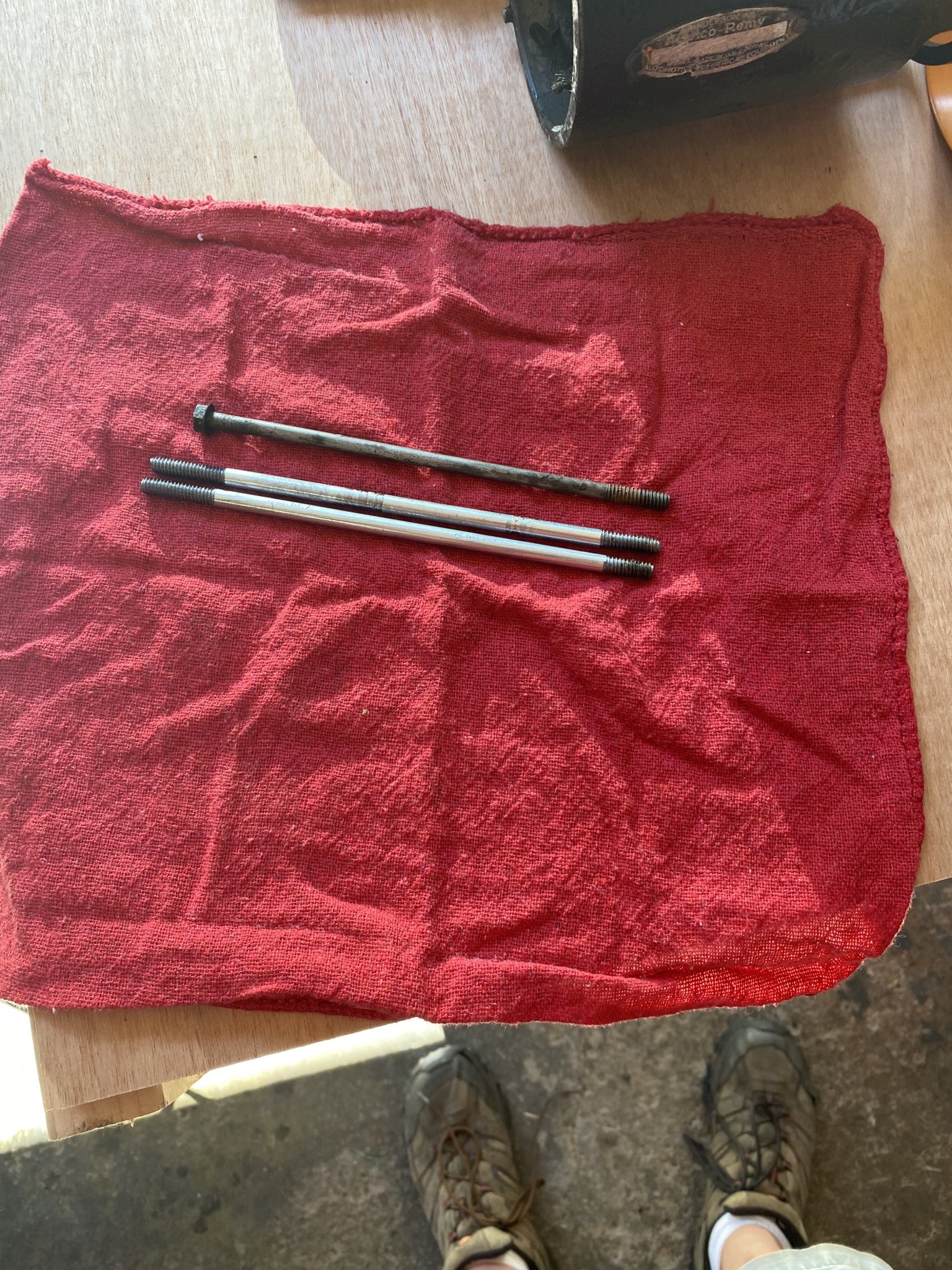

One of the through-bolts that hold the end-cap/brushes to the nosecone broke a nut.
They're actually just 1/4" rod with threaded ends. I made some new ones, just a little longer. .
