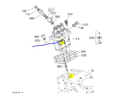

@thepumpguysc attached the WSM page S35 I am working from. It shows the slot you have referenced but I still can't get it to line up. The pump lifts about 3/8" near the top of the studs but no further. This has a front mounted shutoff solenoid so I pulled that out to see if that interfered but no change.

Yeah that's because the rack is stuck..
Is there some way of pulling the pump up far enough to see which way u have to move it.??
U could try blowing the fuel out of the inlet w/ compressed air & filling it back up w/ penetrating fluid.. ATF & Acetone mix.. & let it sit a day or 2.. & using the throttle & shut off, try to get the rack to move.. Good luck.

@thepumpguysc I can raise the IP far enough to get a piece of gas line under and fill the case with the ATF & Acetone mix. Just confirming that the IP case doesn't drain into anything else? Will I be able to clean out after and not contaminate where I shouldn't?

NEGATIVE, you will be filling the entire engine with it, it's not a isolated space.
You need to remove the throttle plate off the front and remove the springs to remove, from there or the side inspection plate you can move the rack on the injection pump.
Do not remove parts of the injection pump if you've never done it, too many point to mess it up completely, you need to find someone trained to test and rebuild them. ;)

Yes the actual inj. pump inlet.. NOT UNDER the inj. pump..
I think u better do as NI Wolfman says.. to get it off..
