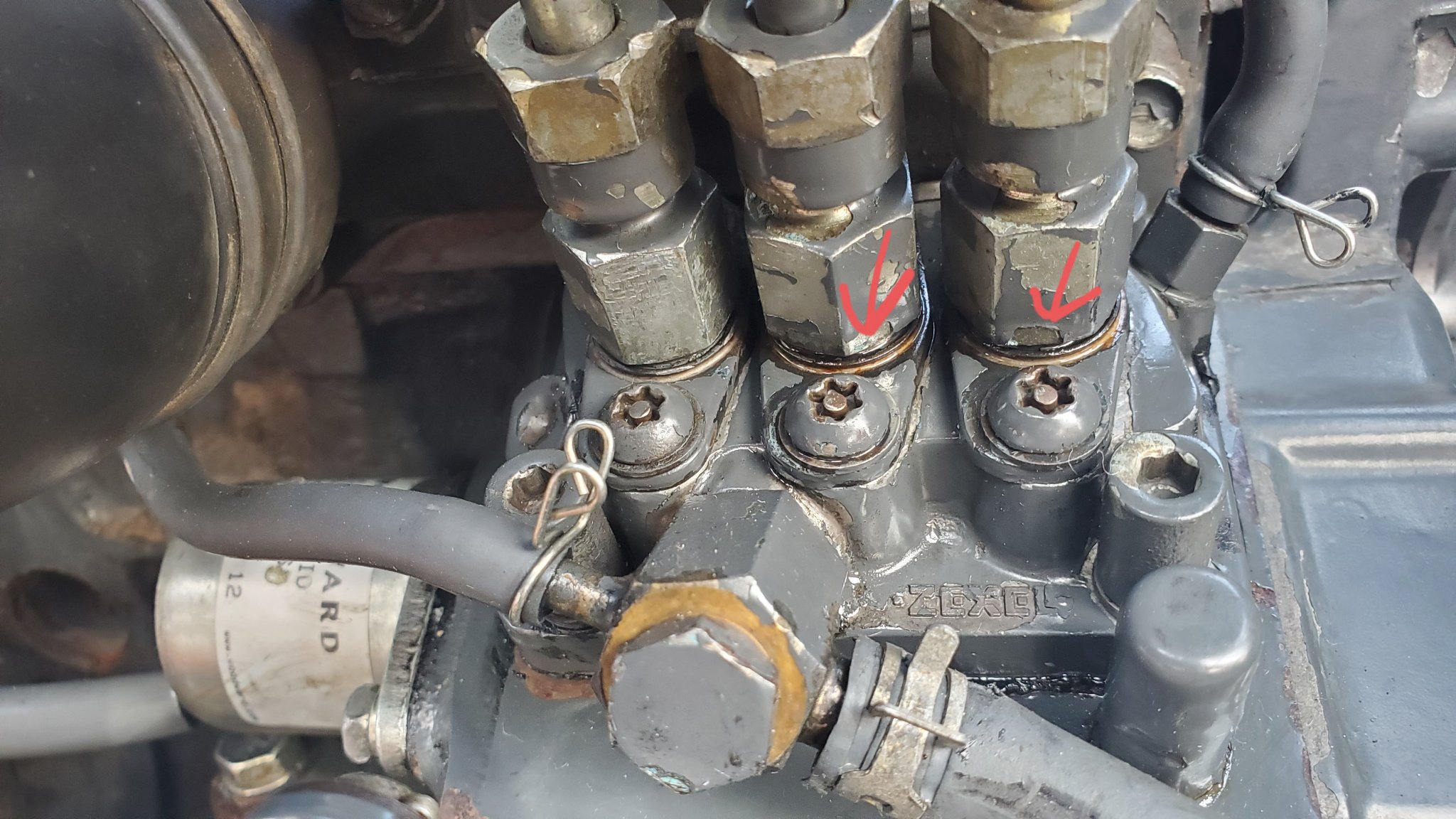

So this repair addressed my issue too. It hangs around 2800 max now and does not go above that. I had it running for over 30 min with no issues.
Mine did not look like it was tampered with.
But now i have fuel seaping between the block and the injection pump, coming from the "shims".
I looked in the service / shop manual and it says the RTV is not necessary. Is that correct? If i do use RTV, should i apply it on bottom and the top of each shim?
There should not be any fuel at the joint between the pump and block, only engine oil. If you do have fuel there either the injection pump or lift pump is leaking fuel into the crankcase.
Check your engine oil level, clean around the injection pump with brake cleaner, blow it off to dry it, and watch closely as to where it is coming from. The fuel may be running down the pump and you are just seeing it at the joint.
It might be leaking from the top, I remember seeing some bubbling.
Should I replace the o-rings before I put it back on. It's a pain to RTV everything and disassemble again.
See this video I found for the O-rings:
JustNutsandBolts
B21
Dec 24, 2020
NJ
Its leaking from where i drew the red lines.
I put similar size o-rings in there. I guess they were not right size. This sucks.
EDIT: I apologize, let me make a correction.
I just ran into the diagrams in this post :
I did not replace the O-ring on the delivery valve holder ( the part where I put the arrows on). I replaced the 2 on the delivery valve itself. I may be able to fix this if I tighten down on these delivery valve holder but I cannot find a wrench to fit in that middle one.
Check this picture for more detail found in (I did not replace this o-ring) this post:
