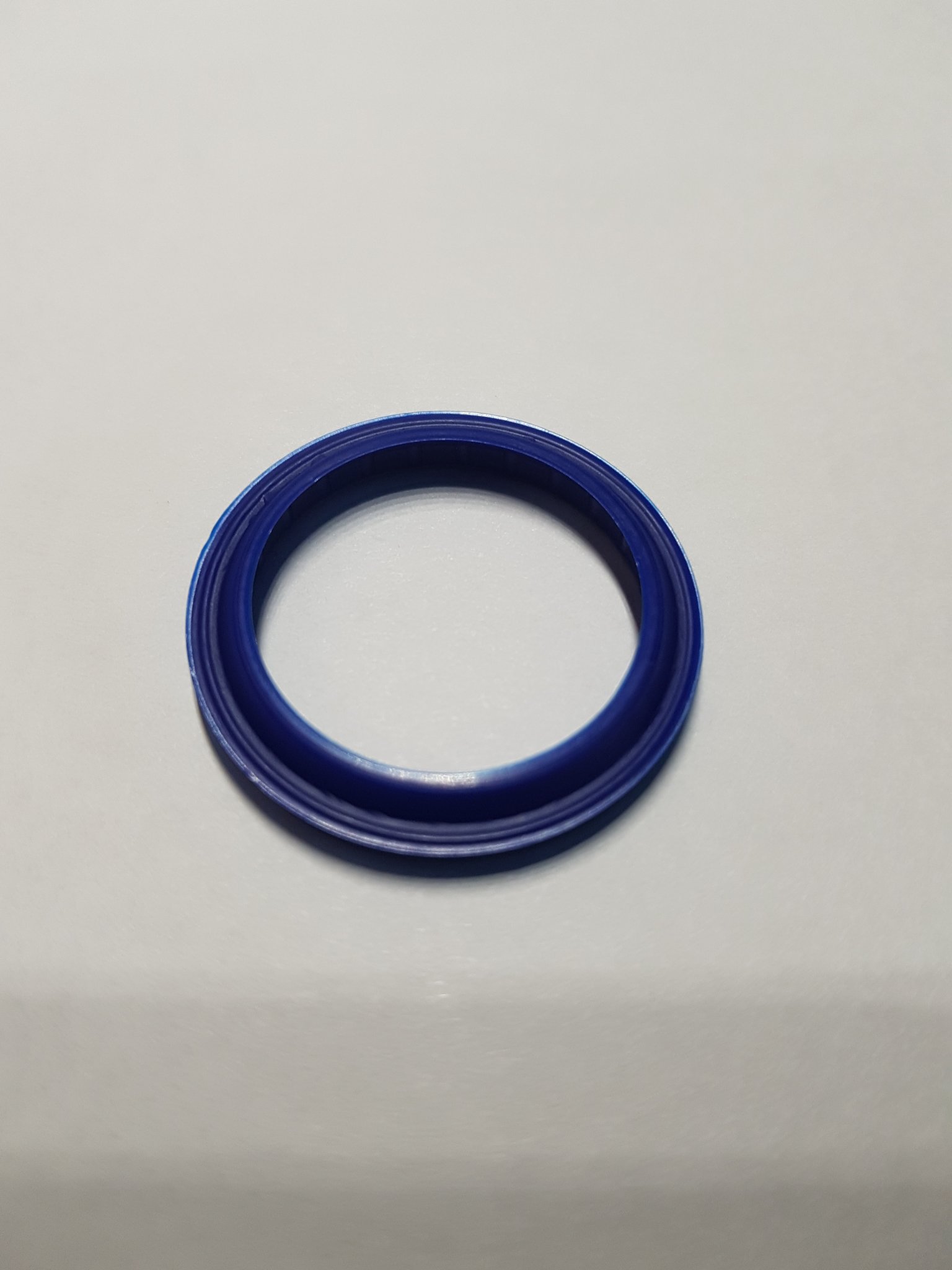

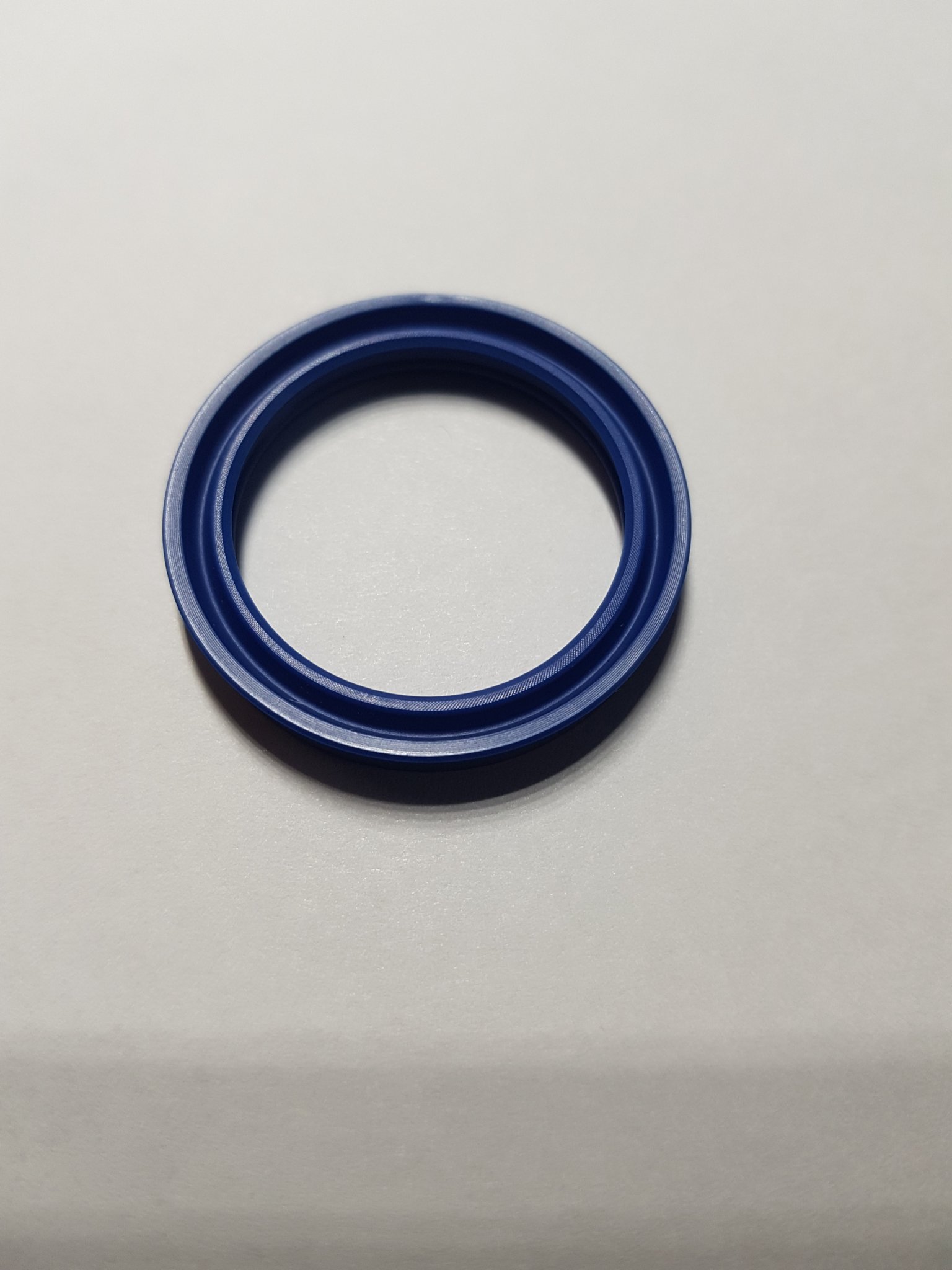

Have all the seals replaced and everything looks good except for the one seal in the gland nut. Its the seal in the second picture. Hopefully someone on here can let me know the direction. Thanks.

I need the forums help on this one. Picked up the seal kit and have the cylinder apart. Have not replaced any seals just in case. All the seals match except for two. The existing gland nut internal seal is an o ring with an orange plastic spacer and the kit does not have these. I did find a post on here that stated the internal seal has been upgraded. My question is what direction does it go as I presume its directional. View attachment 51626 View attachment 51627 View attachment 51628
The top picture is the rod wiper and the side showing in the picture goes to the outside.
The second picture is the rod seal and the side showing (the open side) goes to the inside (so the fluid pressure activates it).

Thanks for the reply. That is the way I put it all back together. Found some info on seals after searching a bit. Now I know why everyone uses a seal install tool. What a pain.
