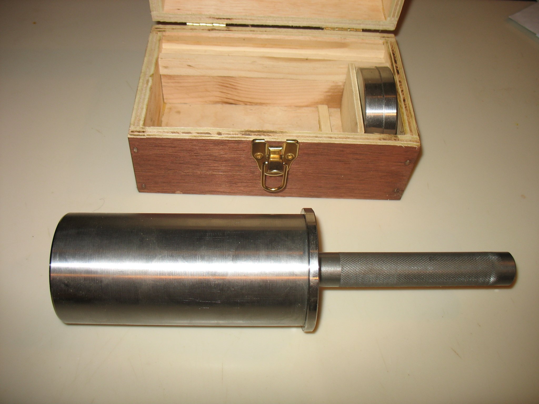

Vendors often make inaccurate claims.
I have no experience with a D950 but I have installed prefinished .040 (1mm) wall sleeves in Fords. Interference on them is .001/.002. I even make and sell an installation tool for them. Without a full length support they are easy to break and/or deform....
