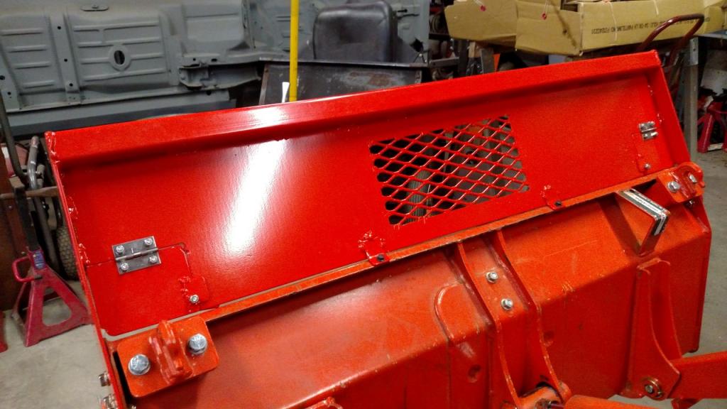

When equipped with a decent edge (or plenty of horsepower) it is capable of some digging. About 6 years ago I used a B7500 and the L3200 to move a good part of the yard to bury a 1,000 gallon propane tank. I had the vendor set it at the base of a bank, then extended and tapered the bank to cover the tank.
The soil was taken from an area that I could take a cut from that was from zero on one end to over foot on the other. Both buckets had DIY edges added that were sharpened on an angle. This allowed me to go along and shave an inch or so at a time.
Last week (pics below) I made an edge for the L4240 bucket from a plain piece of 3/8 thick x 4" or 5" steel that I found in the scrap bin at work. This one isn't sharpened and only serves as a sacrificial piece in case the bucket gets used for snow.
The Piranha edges really look like they would make digging easier, and if I had an application for one I'd love to give it a try.
