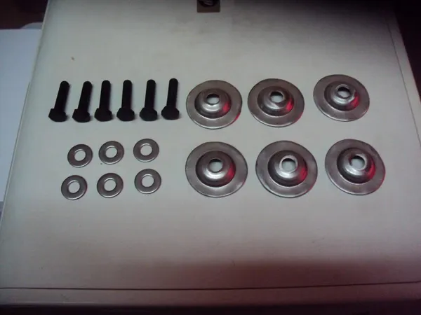

I use 3/8 cause its what is available on the shelf in 4*8' sheets.
I attach to cross channels I make out of angle iron and use can am style skid plate washers. I use bolts of varying lengths with nylok nuts. I bend with heat gun to create wings for attaching
No need for welder or metal working equipment. A drill with various sized bits, hole saw for wood makes nice round holes, and jig saw all I needed. Will get pictures next trip to my shop.
washers cheap and keep bolt heads up higher so bottom stays smooth and catch free over brush, etc..
this way bottom of skid plate very smooth. I drill / cut openings to access, drain, etc... These plastic sheets can be cut on a table saw, with jig saw, can be bent by heating with paint stripping gun, etc... It can be shaped with heat just don't over heat.
I make templates out of cardboard first then trace onto the sheet of plastic and cut (cut slowly) so not to make too much heat.
BXpanded makes out of metal for the BX if thats what you have for a tractor

thank you that looks great
