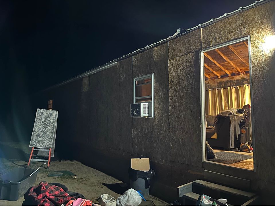

" Selling my 1978…14x68 foot mobile home..it’s been a continuous remodeling project as you can clearly see in the images..the inside needs some love as it’s not completely remodeled but it does have alote of potential in the right hands.. all of the framing is still nice and solid and the underneath of the house is all solid 2 x 6 beams holding the floor up, and they are in perfect condition as the mobile home has sat on a full basement foundation with the age of the house.. all of the plywood on the outside of the house are brand new I just replaced all of last year ..like I said, it’s a solid structure just needs to be finished on the inside.. oh it will need to be removed from the location that it’s at as we are replacing it with a newer mobile home, and no longer have any use for it anymore.. and the person that buys is responsible for the cost of moving it to a new location I’m asking $20,000 for the house as it is "

pretty sure about 30' down the road, it'll collapse as all the roof ties (ceiling joists.) have been removed.
and that's wafer board NOT plywood on the walls...

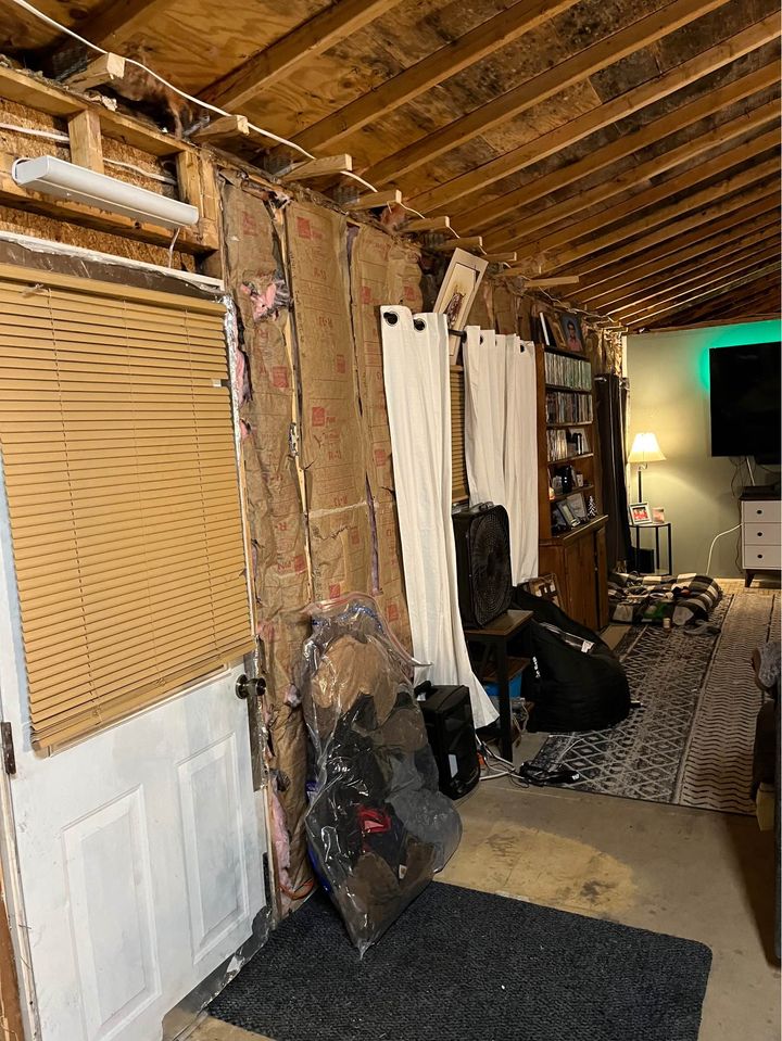

Collar ties got in the way of his dream to have a vaulted ceiling...for starters..lol

Kids are sleeping in a bunk bed with plastic and insulation hanging down right on the sleeping area....but they got that big screen tv and new puppy!! ...lol priorities. Sadly this is super common up here.

Love how the bottom chord of the trusses has been cut off to facilitate the palatial ambiance. Next winter the roof will collapse under 6 inches of snow when the walls blowout. It still snows in Maine, right? Hope no one is in it when that happens.
Do his family a solid and show this add to the local building inspector so this disaster of a pile of rubbish can be condemned before someone is hurt.

Beat me to it, first thing I saw all the ceiling joists cut out
