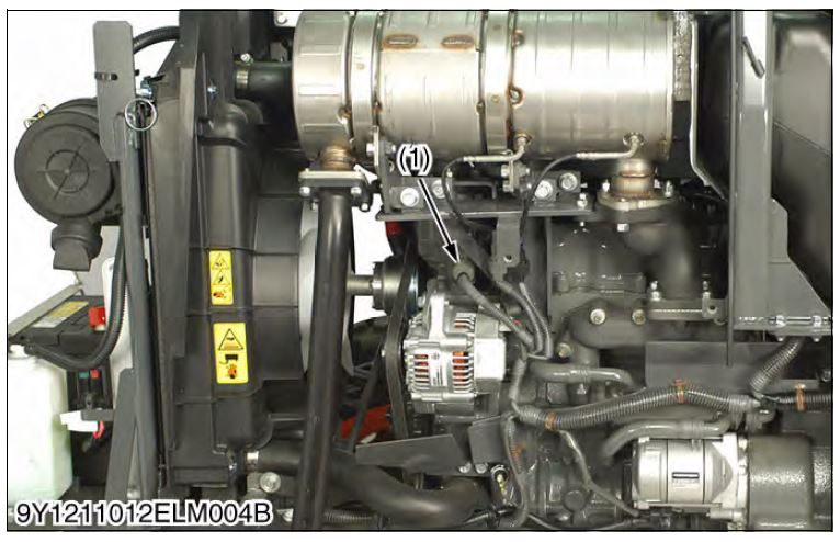

I have a L3301 and the adapter they send with it will not fit in the space above and behind the alternator. They provide a 3/8" street EL and there isn't enough room to tighten it after the adapter is installed. I don't know what thread is on the adapter but it must be something in metric cause no US pipe fitting will work.
If I remember correctly on my outlet port there isn't much room and I had to use a straight barb fitting.

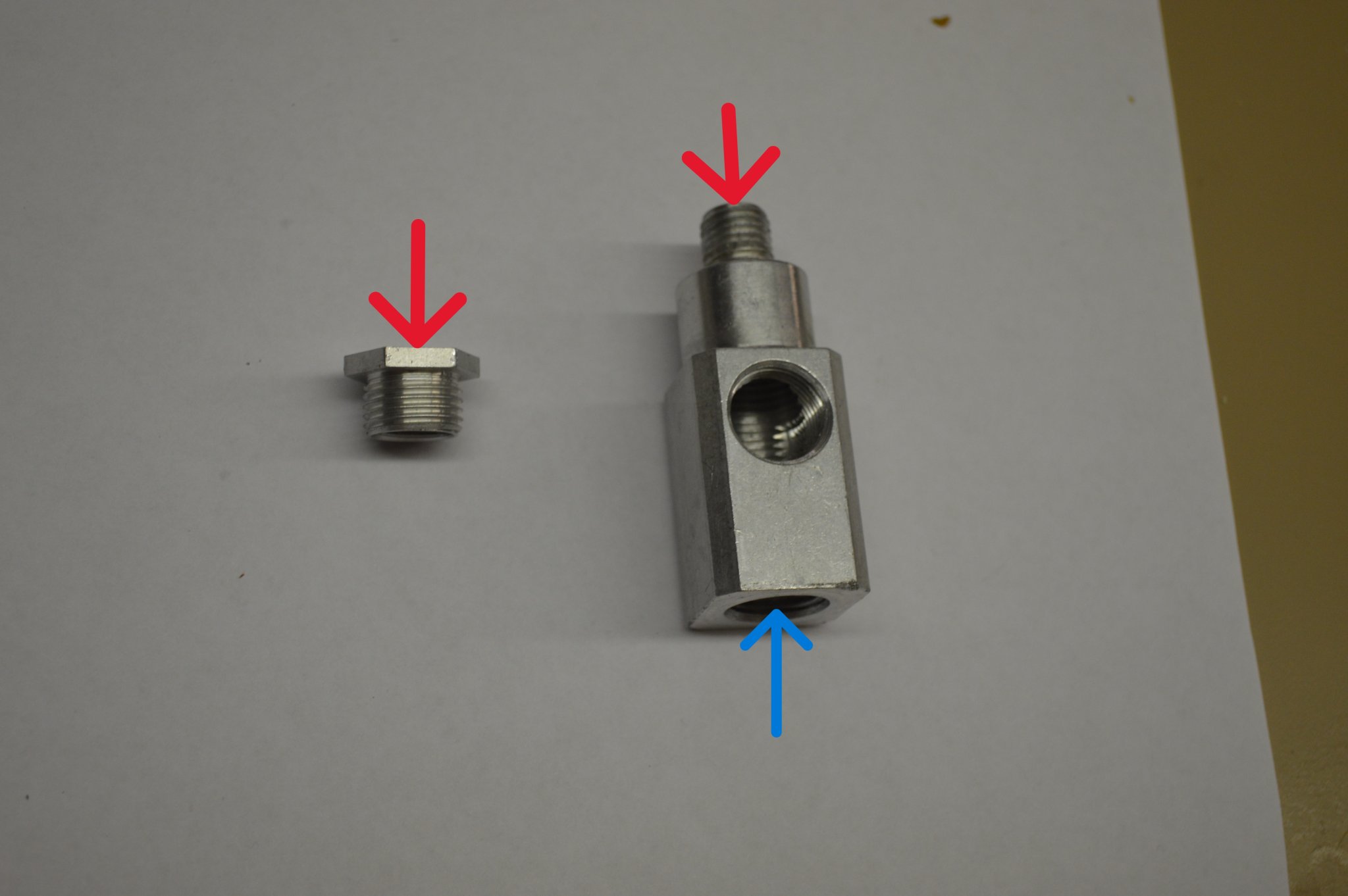

Here's a few photos. The bushing on the left with the Red arrow goes in the blue arrow port of the adapter then the temp sending unit screws int there. The Red arrow of the adapter screws into the hole in the engine block where you remove the Temp sending unit. The port on the top is where the street El for the heater hose is supposed to go but there isn't enough room as it hits areas on the engine block and the bracing for the DPF canister. The only threads on the adapter that are US pipe thread are the ones for the street EL. Don't know what the other threads are. The directions (Curtis part no. IM-9PH20S60) are not very clear.

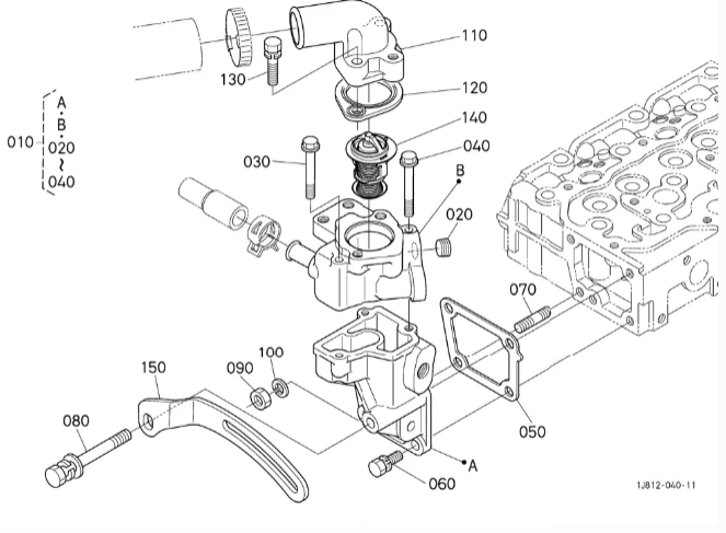

Is there any chance you can remove the plug 020 below and take your supply to the heater from that?
Those fittings look like they use some type of "Parallel Pipe Thread" and not standard "Tapered Pipe Thread".
