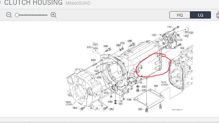

On a related note, I am looking to buy a new tractor and my preferred model for my needs is the M5660SUHD. I was ready to pull the trigger at the dealer when I found out that this model cannot have a creep gear installed. Does anyone know why? The other M60 models (M6060 and M7060) can have it.
I really need a creep gear for my water wheel transplanter. I don't need it often, but when I need it I need it. It will be another $4-5k to jump up to the 6060 that is creep gear compatible.
Is there any chance I could install an aftermarket creep gear if Kubota will not provide me that option?

That's a great question. The 5660 appears to have the same transmission as the 6060, well F8/R8 at least, but creep range isn't even offered as an option in the "Build My Kubota" utility on Kubota's website. The 6060 and 7060 share the same engine, but with my very limited knowledge I would think that the transmission is the relevant variable, and assuming that the 6060 and 5660 share the same one, you'd think that creep would be an option. I suggest you talk to a knowledgeable Kubota technician about this.
Kubota does weird stuff on the "Build My Kubota" page. They still list backhoe attachment options for the M60 tractors such as frames, but don't offer a backhoe any more. :unsure:

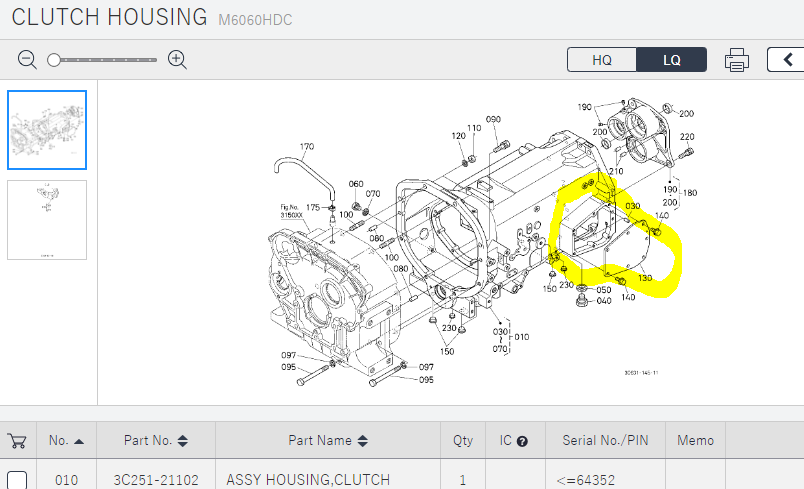

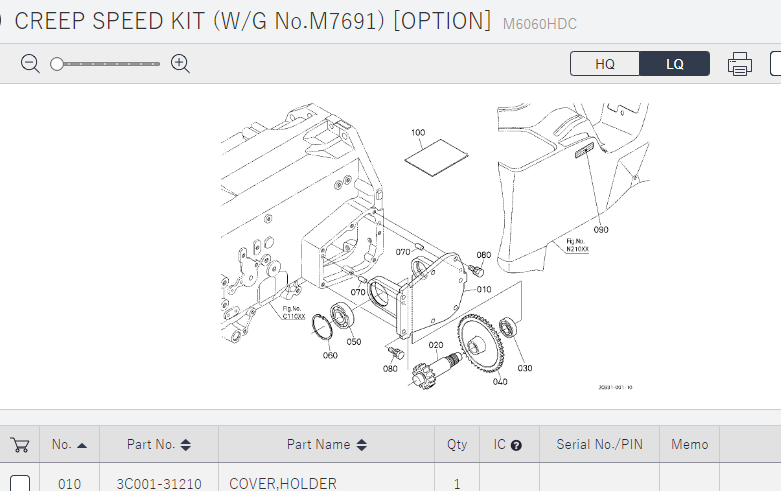

33,464
8,743
The M6060 is a different transmission than the M5660!
The M5660SU is a stripped down / economy series lacking the finer details of the full models.
M5660SU
M6060
M6060 Creep kit
6,616
8,810
@North Idaho Wolfman, thanks for digging that up. I learn something every day on this forum. Not all F8/R8s are created equal it seems. Not good news for @Peregrine Foxfire, although he'll love the M6060 if he gets one.
