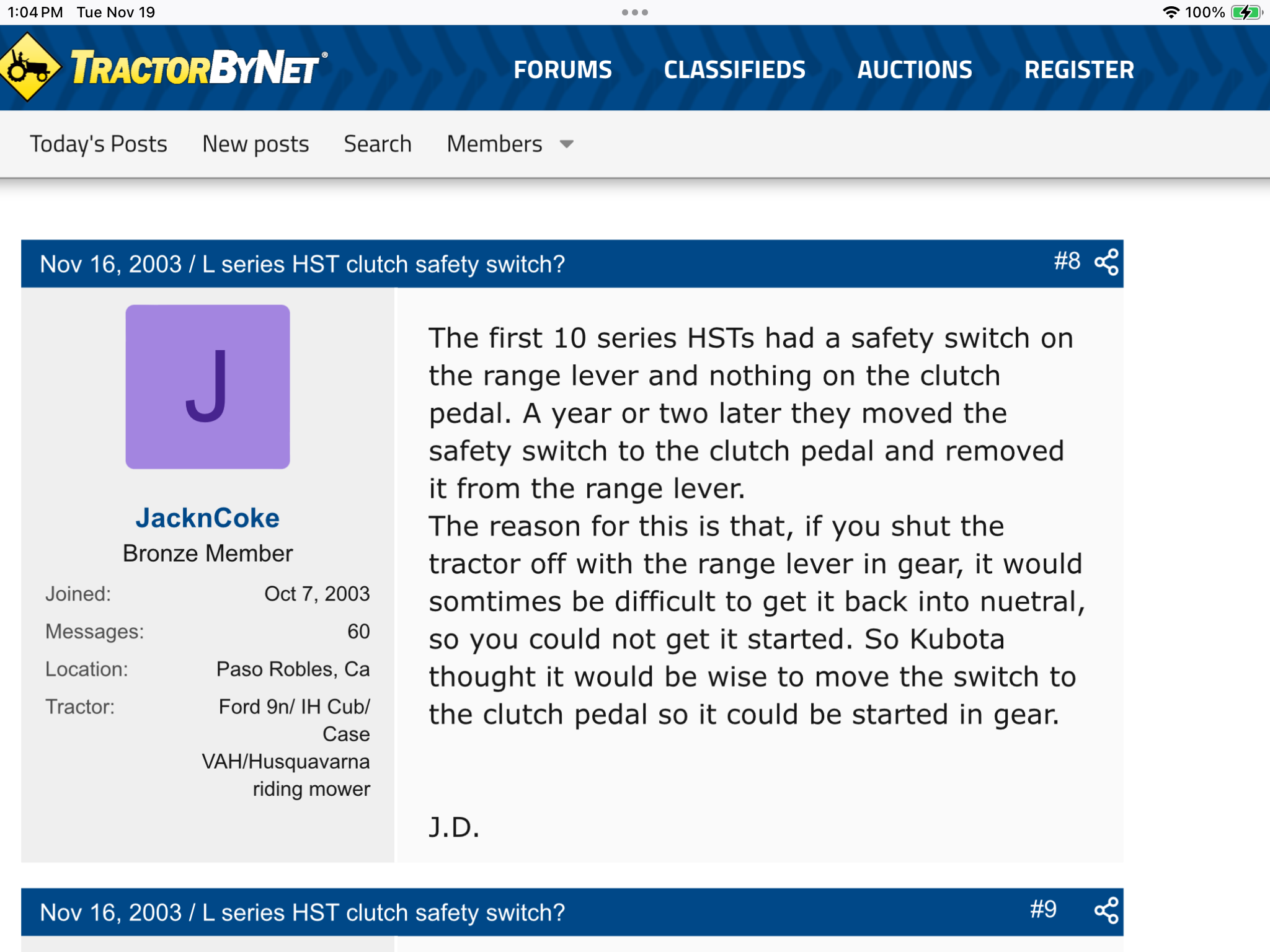

Nope. The range lever can be in H M L or neutral . As long as the HST pedal is in a neutral position, clutch pedal depressed (clutch disengaged) and pto lever in off position the tractor will start. Again, in a properly functioning L2501 HST the clutch pedal must be depressed for the tractor to start.
I’m sure that is true for this example but I’m pretty well convinced that they added the clutch switch at some point.
Interesting for sure except the L2501 did not arrive until 2014 and that post is dated 2003. I would be happy to be proven wrong and first to admit it but still not convinced that HST L2501's were built without clutch safety switch.
He was pointing out that back in to 10 series, way way way before the latest 01 series that there was an issue putting the switch on the range selector because it would get stuck in gear and be unable to start, therefore they moved it to the clutch pedal to eliminate the issue. ;)
I agree but at the time I posted I was not sure if Marky was making the case that some early HST L2501's had the range lever safety switch and not the clutch pedal switch.

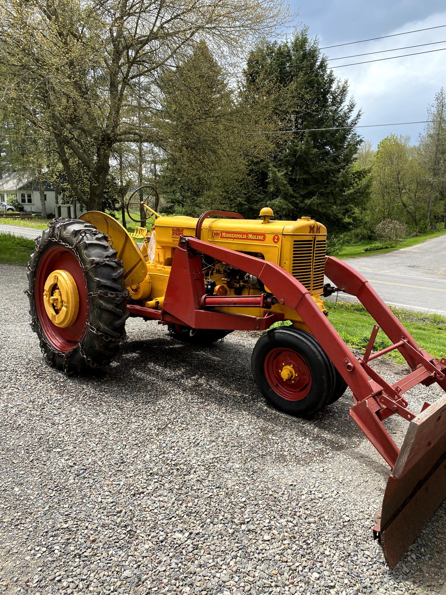

I started out with tractors without any safety systems. I'm still here, but learned a lot at a very young age, starting at 6 years old or so
I still own one of them. If given the opportunity, that tractor can hurt you in an infinite number of ways.
What is innate to me is not to a lot of folks.
Stay safe and enjoy!😉

Nice tractor! I'm definitely all about safety and I always try my best to do something the safe way but there are times as you know, you need to take a chance understanding the potential risk, may not always be Osha approved but we often find unique ways to get the job done when a challenge is in our way.
