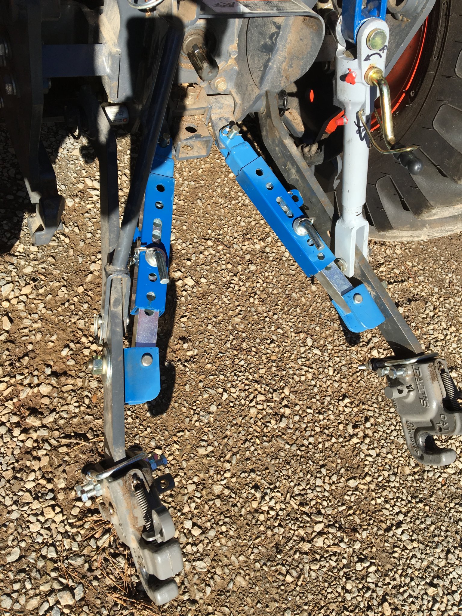

if you are a good fabricator might consider making some pin type sway control bars instead of the OEM chains.
Modified the B26 3pt hitch immediately with Pat’s quick hitch, pin sway bars and geared side link adjuster. So much easier to hookup and adjust 3pt attachments for the past 9 years.
