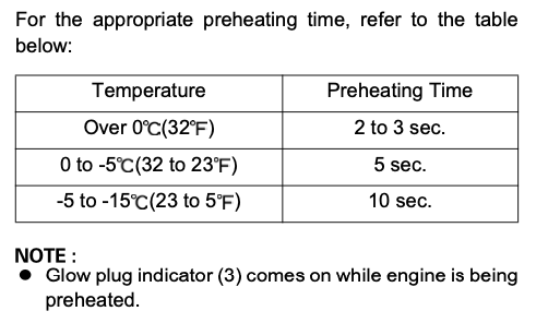

I don't know how cold you are talking about. I use the block heater in Winter. I don't usually use the tractor much below 20. We don't usually have much snow when it gets below that temp. I use my glow plugs per the manual and keep throttle at lowest setting. I have an L2501 HST. I also use Power Service Winter fuel additive.
thanks.... I put on more hours when colder than -20F than hours above 50f.
unfortunately the pre-heat tables in the manual do not go to the temps we get around here during snow blowing season. Regardless I give my glow plugs lots of time to make their work. Probably more time than most I am guessing. I don't rush them.
